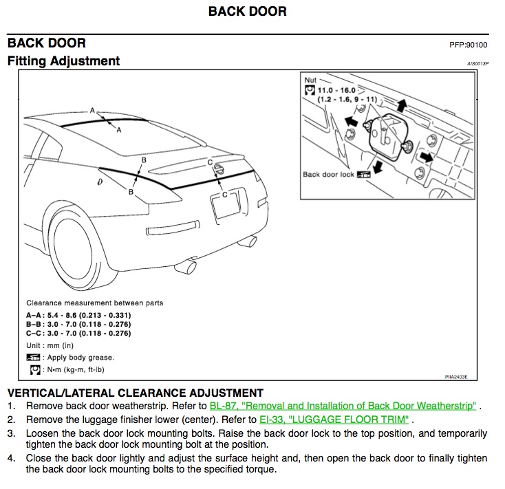

By the way. I was the one that posted that original thread about the rattle in the hatch of my Z. Like I said, I've taken this think to the dealer 4 times. I got it back this past saturday and I think they fixed it because I dont hear it anymore. They said they adjusted the latch on the trunk lid. Im still skeptical though. I gonna drive down some rough roads with the music down to see if I hear it. If I do, it's on. Are you in cali?

Mega bump, does anyone know how you adjust the latch?
Here ya go...
