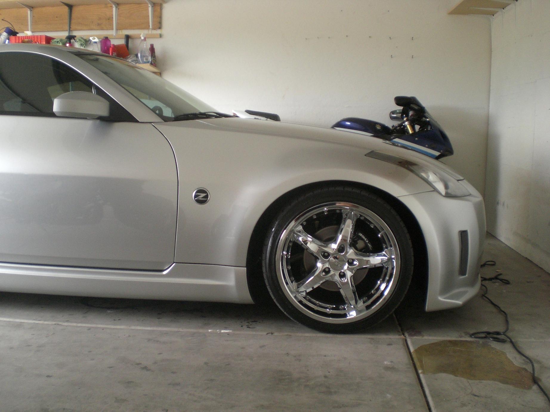

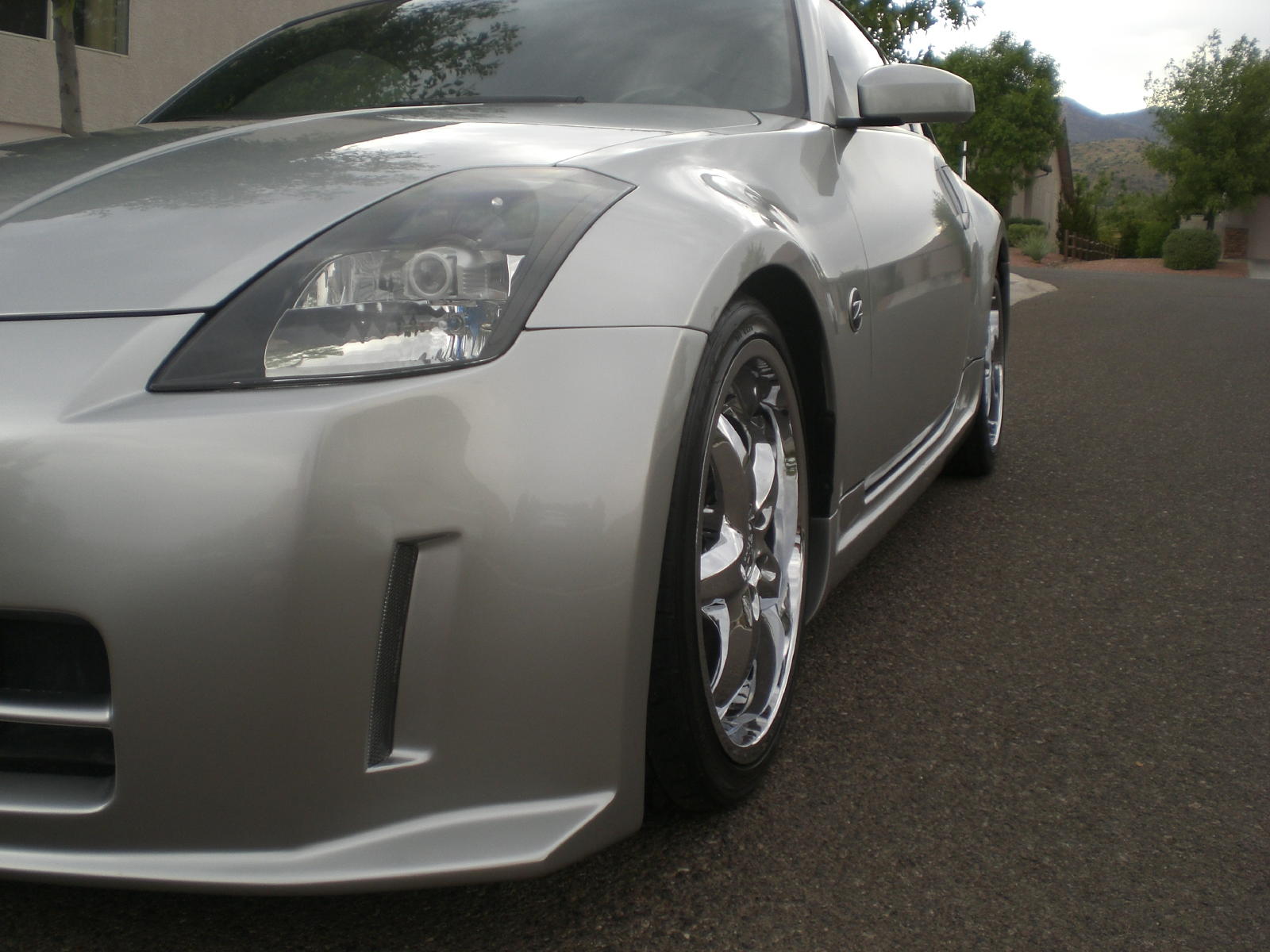

i cant afford new wheels right now. the wheels i have now are not the right offset for the Z and its buggin me more and more. hopefully instead of bashin me for the chrome wheels...maybe someone can tell me if a set of 25mm spacers would help my problem?

ive searched plenty...just curious about them specifically on the setup i have. thanks

Wheel/tire widths and offsets would be a nice start.
Or you could get a ruler and measure how much gap you've got between the rim and the fender...

FRONT- 245/35 R19 width:8.5 offset:35
REAR - 275/35 R19 width:9.5 offset:45
bought them here almost a year ago...

Ouch, those are extremely tucked. Definitely not sized for a 350z.
If you want them close to flush you'll have to run about a 25mm spacer up front and a 35mm spacer in back, or as close to that as possible...
