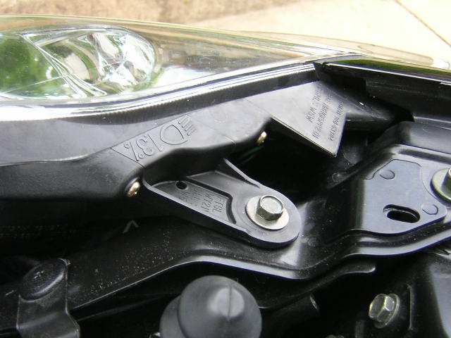

Hey someone on this website had them in this forum, well I just got them in today, but I can't install them! there isn't enough room to work in there... how do I replace them ? (If the person who orginally made this thread would please respond also)
Here are pics of the area..

ares's Avatar
ares
Veteran
Posts: 10,816
From: ATL
pull the housing out for access no?

You can't change bulbs from under the hood. Take the fender well out you have easy access.

Its possible from there, undo the bolt there, you can pull the light forward slightly. But you need to have small hands. Its possible, thats how I replaced mine.
Or you can jack the car up and remove the splash guard -- I believe this is what PowerZ is referring to.

Damn nissan and their tight engine space. Removing the fender is a crap load, have to remove those screwes, then yank fender down, then reach through bottom car, but then again, my hands are too big to just reach into that hole. That corner of plastic is what is blocking my hand.. Maybe I should cut that piece off! haha.. damit.

Ricky, put yur car up on stands then remove those plastic splash guards that sit below your headlights, you should have enough room to get it from there.

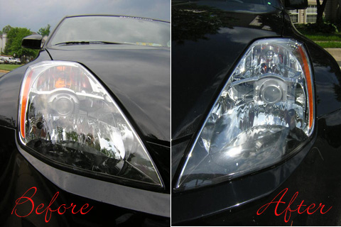

Forgot the picture! Here, enjoy!

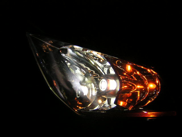

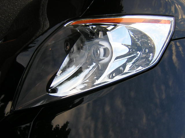

More pics
Old May 20, 2003 | 05:43 PM
Ricky's Avatar
Ricky
Posts: 1,814
From: Northern Virginia

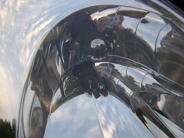

Close up of bulb.
Old May 20, 2003 | 05:44 PM
Ricky's Avatar
Ricky
Posts: 1,814
Bulb at night, with HID on
Hope these pics helped some of you decide if you want to buy them or not.
