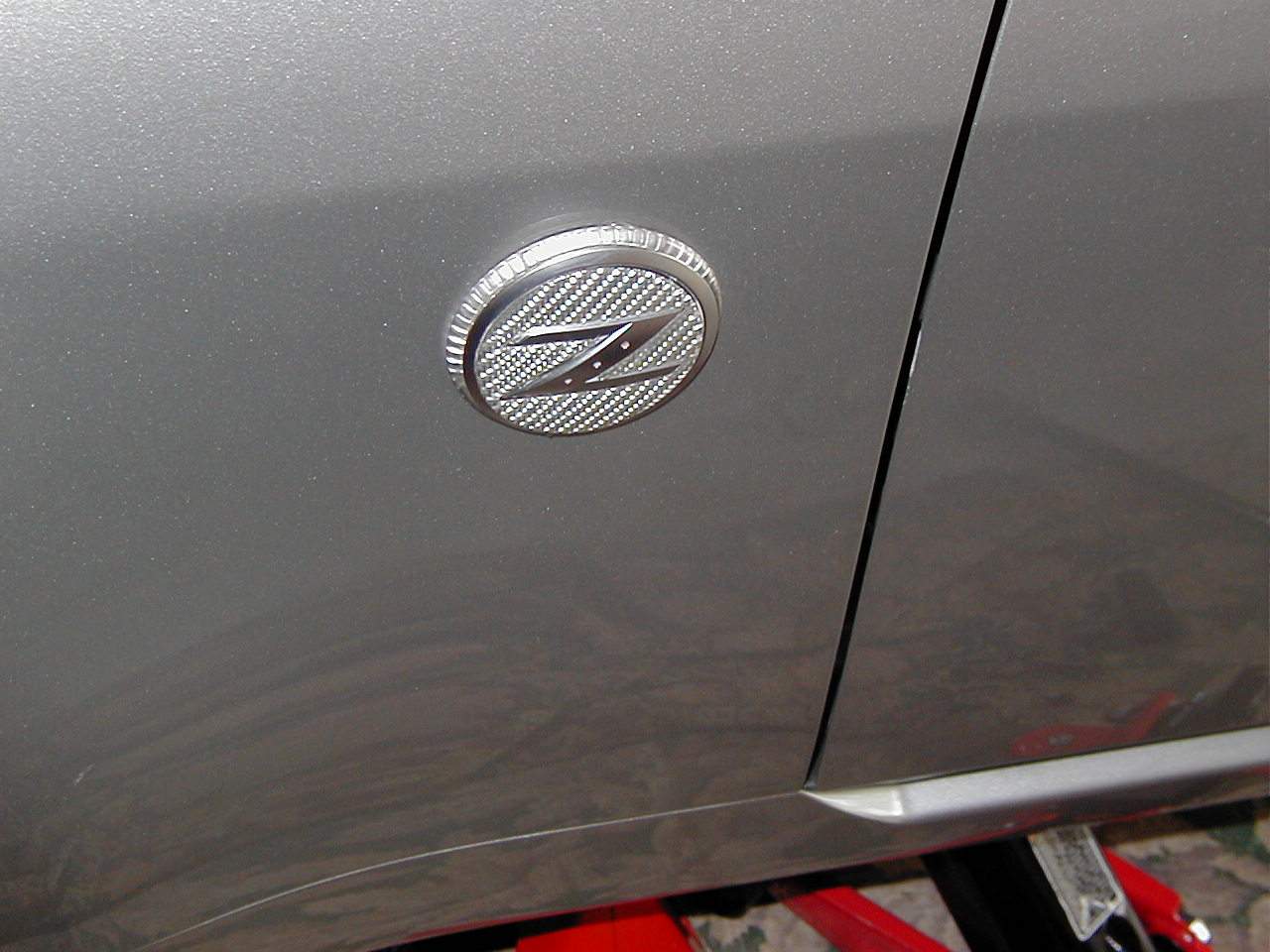

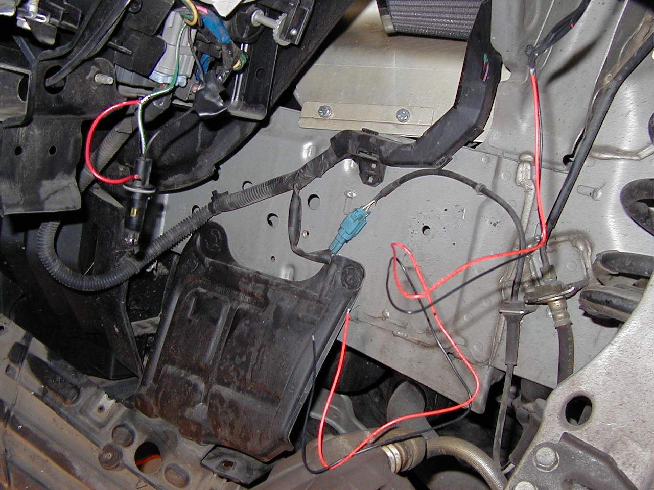

Default side marker & halo lights
Dont no why they say to remove the front bumper ,took the wheel off and removed the split inside wheelwell liners , did both the halos & reflectors at the same time ..
Attached Thumbnails Front bumper sidemarker LED installation???-p1010085.jpg

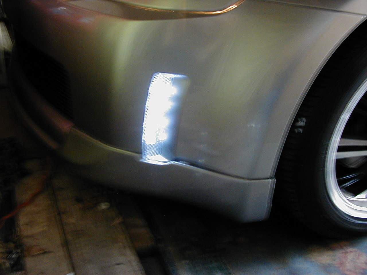

Reflectors and haylos
Attached Thumbnails Front bumper sidemarker LED installation???-p1010093.jpg   Front bumper sidemarker LED installation???-p1010087.jpg

Passenger side reflecter screws are a pain to remove, are up against the windsheild wiper bottle , need real short philips screwdriver to loosen the two screws and also remove the fender bumper screws to help get to them ..
