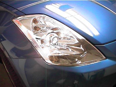

I didn't like how the driving lights looked in front - the were too orange / halogen looking. None of my local part stores carried 194 bulbs that were blue tinted, so I thought I'd try and make some myself.
First the before pic:

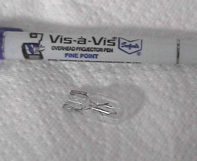

I pulled the bulb out (careful about finger grease - always use a cloth) and got out my trusty blue overhead projector pen. These are water based, so no oils to cause breaking.

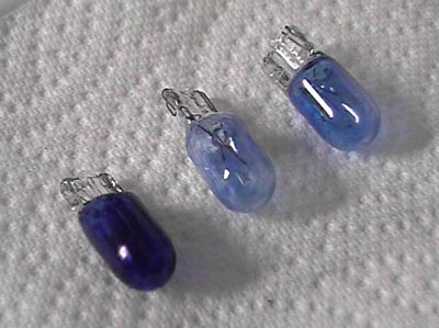

Then I started coloring the bulb. This is where you have some fun. After it is all colored in (do it fast) start wiping it off with a lint free towel. Depending on how wet the ink is, how thick you applyed the ink, and how much rubbing you do, you can get various levels of tint.

Here is the final result. Shown are three levels of tint.

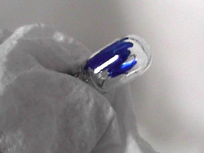

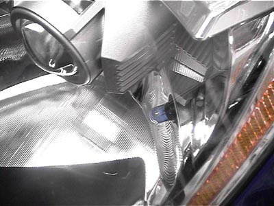

Once the tint is set (completely dried) re-install the bulb. The blue matches my paint too.

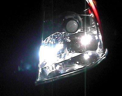

And here is the result. Now I know what you are thinking, base model owners - I'll do that to my headlights. Nope - it won't work. The extreme heat will vaporize the ink right off the bulb. This process only works for low voltage bulbs like the driving lights and the interior lights. But its cheap and a fun do-it-yourself project.
