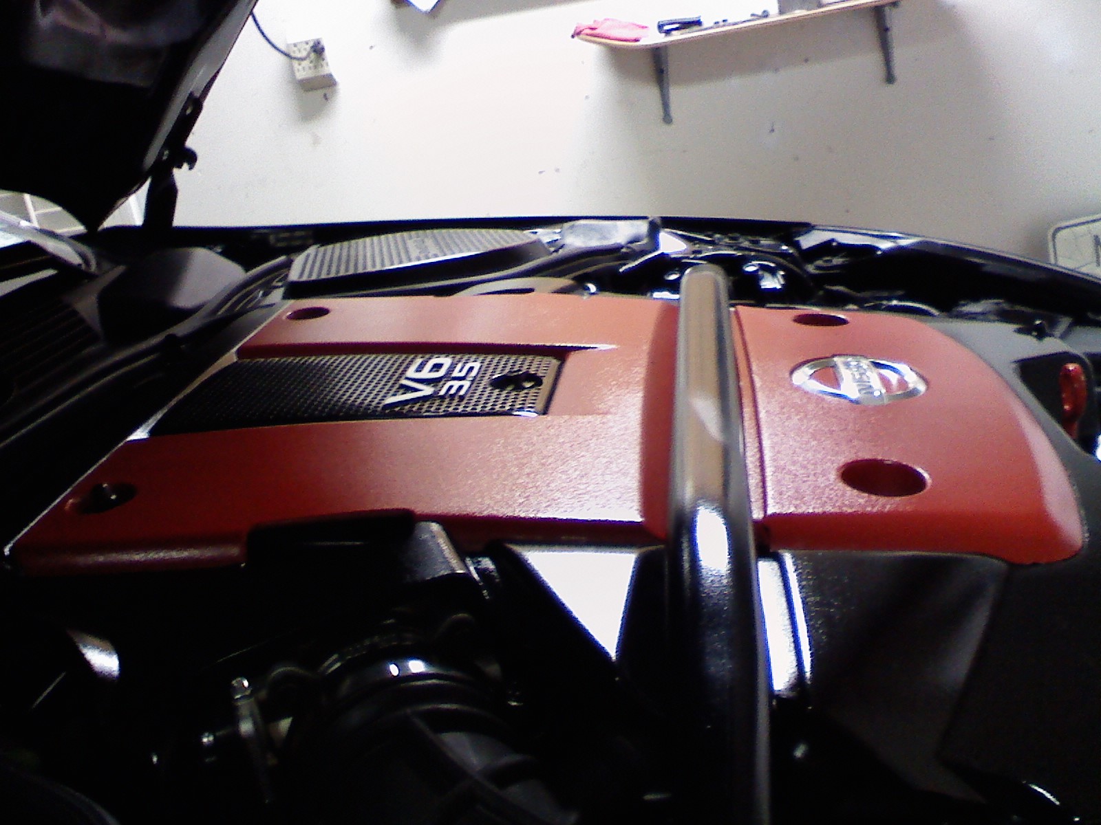

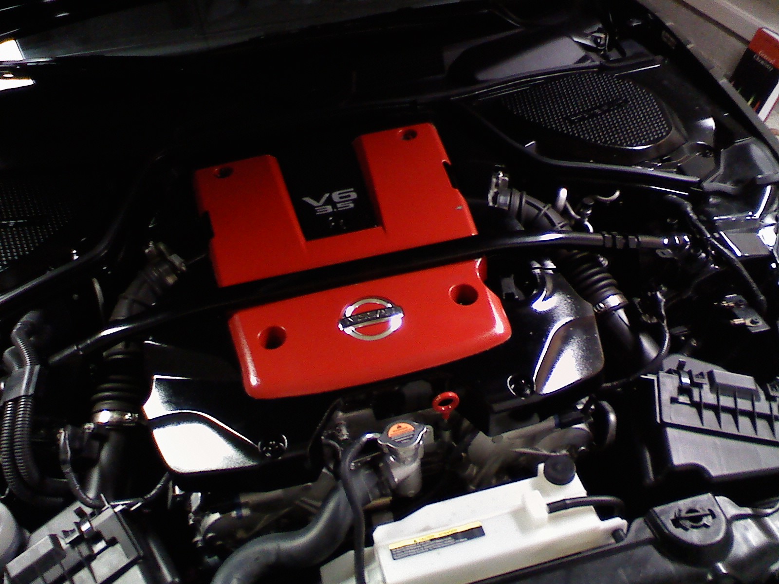

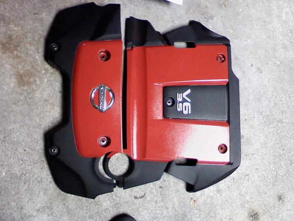

i did it the right way and got great results...
took me a while to do cus i used alot of coats
high heat paint FTW

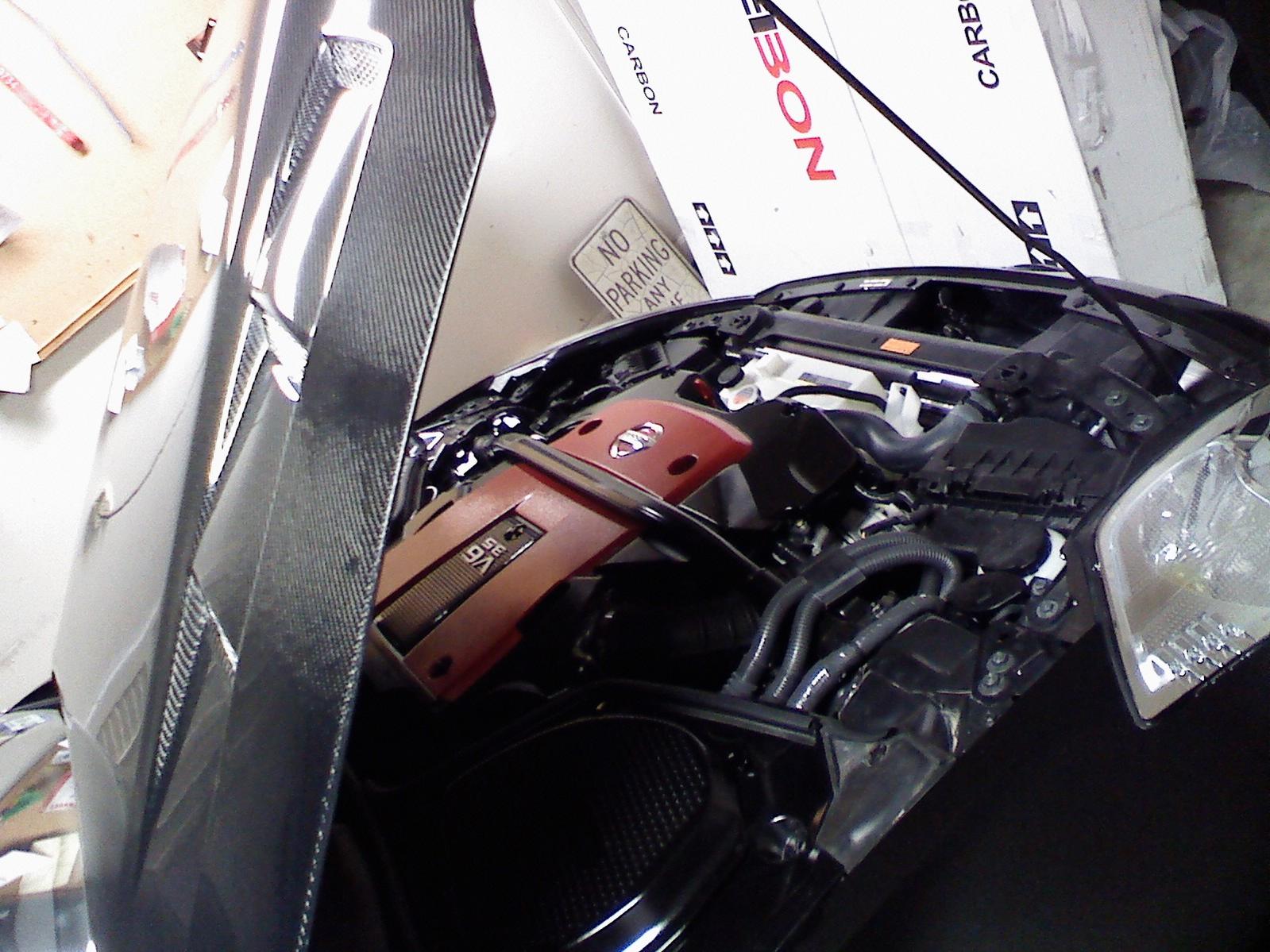

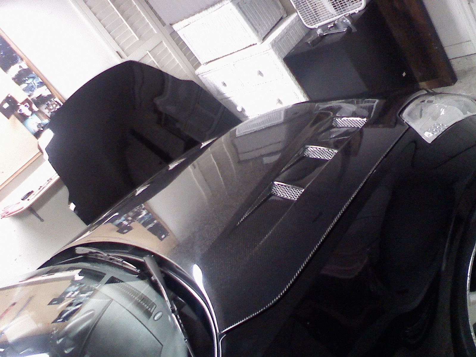

got um...
people love this at car shows
*note if anyone want that hood in the back ground in selling it.
