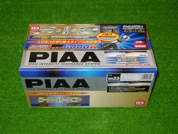

Get this... Direct from Japan
Attached Thumbnails base z owner please come, HID expert welcome!-piaahid.jpg
oh where did u get that? and how much? how does it perform?

overnight parts from japan? you going to get some koni shocks to shave off 2 lbs of weight and get two of the big nitrous bottles tonight from harry? maybe get some Motec systems exhaust, 3 spoon motors, t3/t4 turbos and Moshimoto ZX tires as well?
got it from Japan, I believe PIAA HID are only available in Japan right now... so ... yup... It's good... I really like how it turned out... great stuff...
