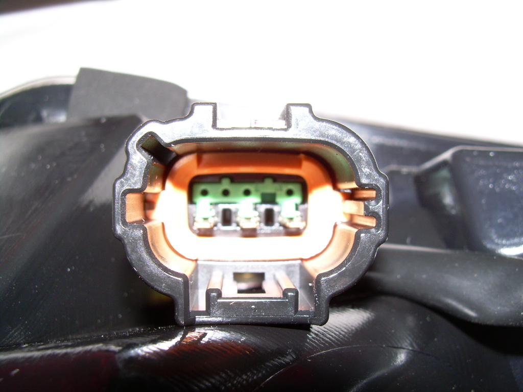

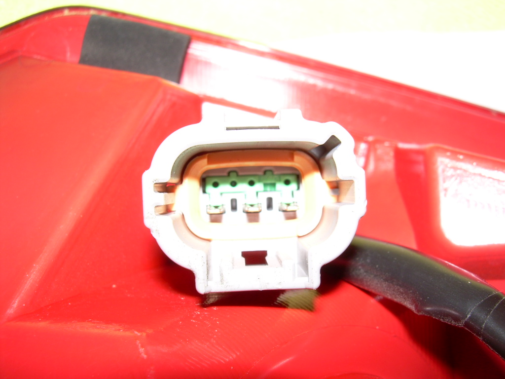

I'm installing the JDM tails this morning, and obediently filed off the piece on the body plug that obviously needed to be filed off. Problem is, the entire indexing system on the JDM taillight is different than the US taillight. (Pics attached; the JDM tail is black; the US is red.) As you can see, there's a "double slot" on the left on one, and it's on the right on the other.
I suppose I could do the appropriate filing, but at this point I'm concerned that the electrical connections may also be opposite. I was assured that these were "plug and play," and they appear to be anything but.
Please advise.

They absolutely will not plug in. As you can see from the pics, the "one slot" slot is narrower than the "two slot" slot, and the double ridge won't fit into the "one slot" slot. The other side is problematic as well; the single ridge is "taller" than the double ridge, so it hits against the middle of the "two slot" slot.

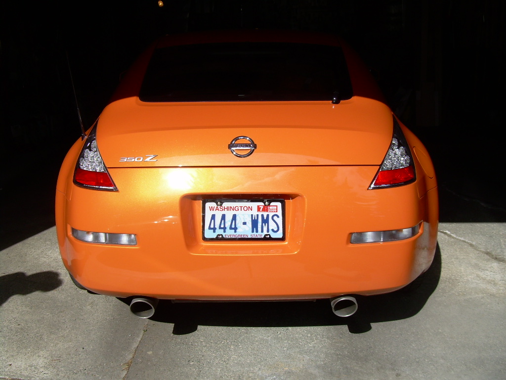

Sorry for the crappy pic. And yes, the "double" tab, the opposite side wide tab, and the narrow tab ALL had to come off. Thank you, Mr. Dremel.
Thanks guys for weighing in on this one.
