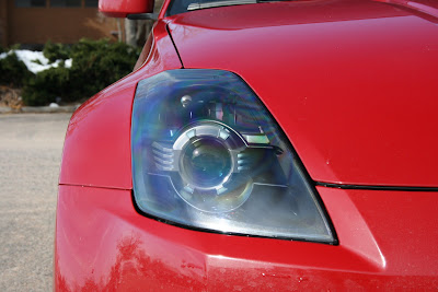

I just did the 03-05 HID to 06+ Bi-Xenon swap and I have the exact same gap on the headlights. It seems to be that way with everyones. I'll post pics of mine when I get home.

I tried everything and they just seem to stay that way. I did not see any adjusting screws or anything like that. I cant remember what the 03-05 headlights look like on a car.

Please excuse my dusty car. She's been sitting for a few months waiting for winter to be gone. So I have a few pics here. I think you need to get your weather stripping and the side skirts checked out. I still think the lights having a gap are normal.
Here is a shot of the passenger light:
Here is a close-up of the gap in the headlight:

thnx for ur input guys. i think i'll just live with it. and bout the rubber thingy, it's cuz of our weather/direct sun on the car. replaceable i guess.
