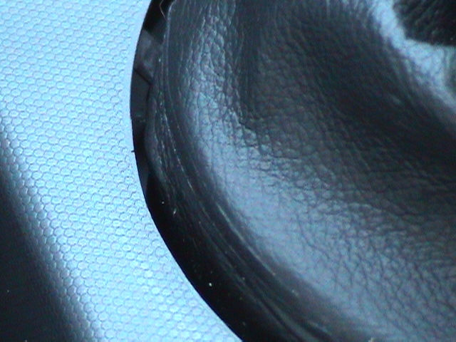

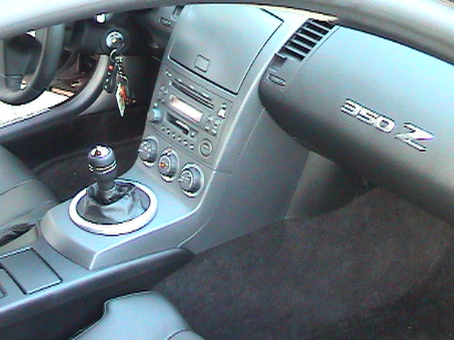

Is this what you guys looking for?
Attached Thumbnails Installing Shift Boot on 5AT-pics-from-camcorder-011.jpg

Here's another shot from passenger side.
Attached Thumbnails Installing Shift Boot on 5AT-pics-from-camcorder-012.jpg

The only thing you need to remove first is the shift ****, then the trim ring. Work your fingers around it until it pops out. DO NOT use screwdriver cause it will scratch the plastic. Once its out, bend off the plastic tabs (bigger) leaving the smaller back piece.
Attached Thumbnails Installing Shift Boot on 5AT-pics-from-camcorder-006.jpg

You need to trim the leather shift boot about 1-1.5 inch from the bottom. Tuck in the leather and glue it to the "neck" of the shifter console. I used rubber glue in case I want to return it to stock, its easier to take off. Next put the trim ring back, you need to push it down a little harder as this will grip the leather tight. That's all there is to it. I used MOMO auto shift **** and boot if you guys are wondering. This is my contribution to the Z community.
Attached Thumbnails Installing Shift Boot on 5AT-pics-from-camcorder-008.jpg
Old Oct 16, 2003 | 10:14 PM
ZDUB's Avatar
ZDUB
Posts: 151
From: KALI
That's nice....can't even tell it's an auto....good job.

Good job man, I would've thought none the better.
