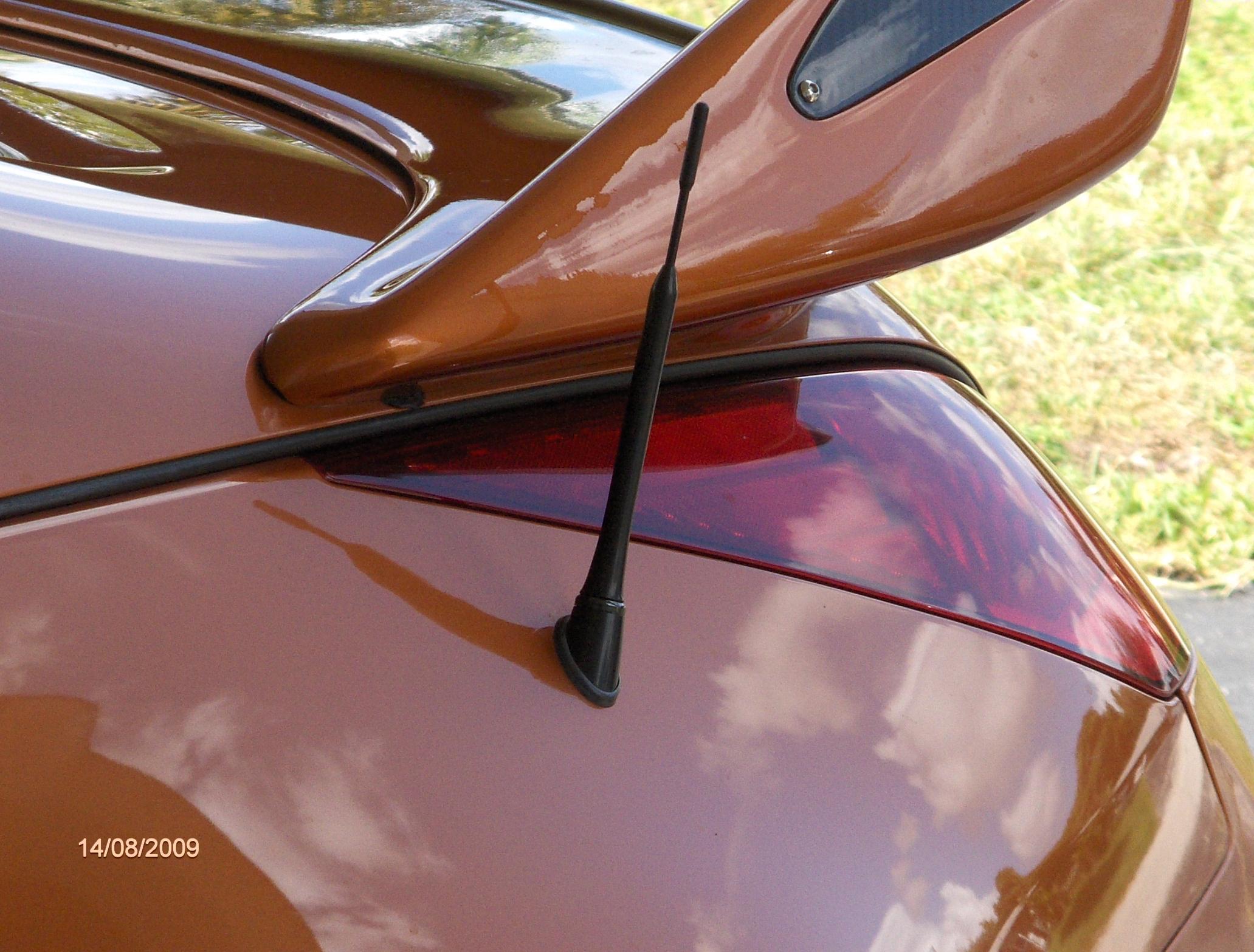

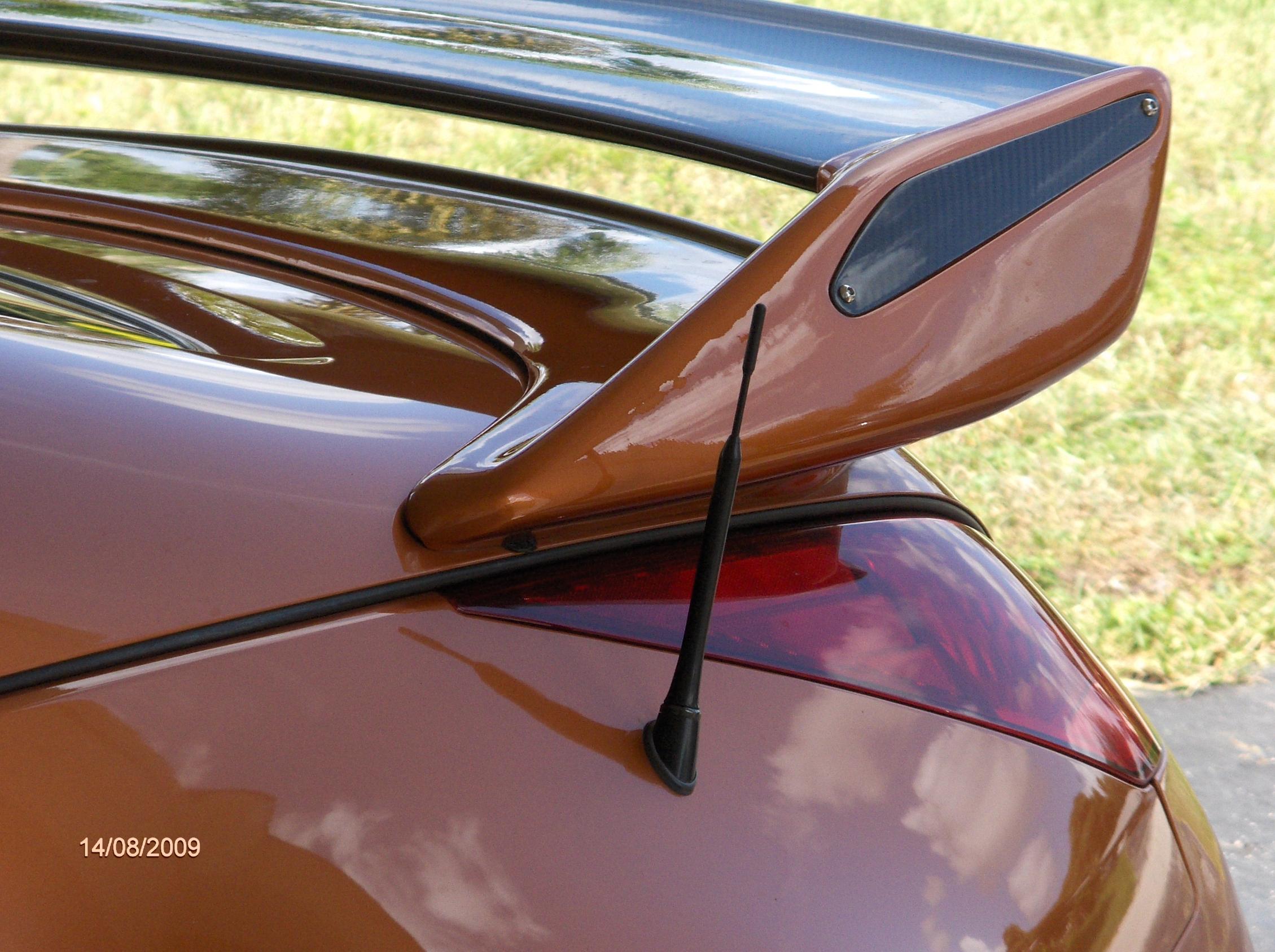

Since everybody seems to switch the OEM antenna for the shorter S2000 or RDX one. I decided to modify my OEM one just to be different, and I really like the way it came out. Hope some of you like it.

did you just cut it or what? if you did what did you use?

What I did was I cut the antenna to where I wanted it. Then I cut the top part off at its base. I took the top part and drilled into it from the bottom slowly about 1/4 inch deep. I put some crazy glue on the skinny antenna portion, and capped it with the top part.

Did it mess up the reception? Cause if it didn't im doing that this weekend lol

Reception hasn't changed at all.
