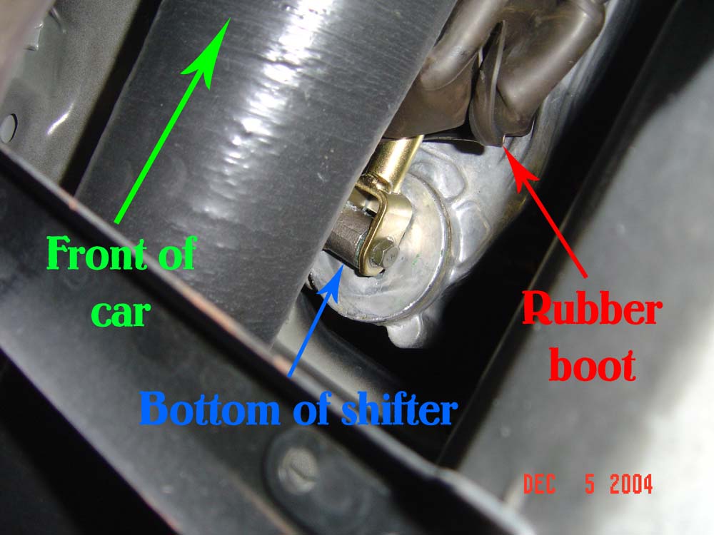

Here's a pic of what the bottom of the shifter is attached to. No need to worry about breaking anything.
that is not true if you twist the shaft enough it will break ...do a search and find out and I know you have been around since 03 so your not a noob but the metal that holds the shaft is flimsy Myke. I remember someone had damaged it twisting it and the tsb even states you must hold the bottom part to keep it from twisting ....
