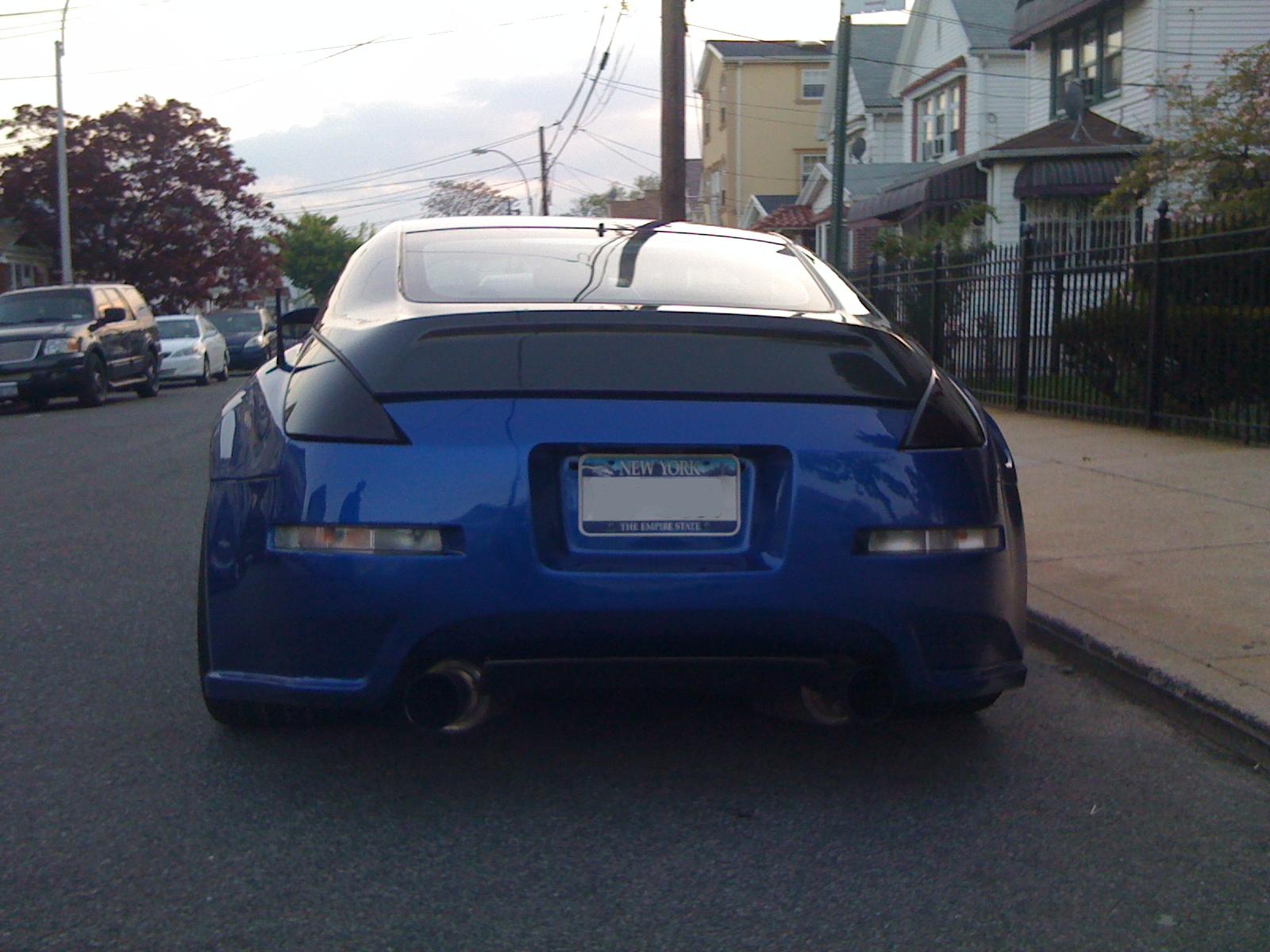

Id say 8 for mine.
Attached Thumbnails Asuka/Mastergrade Hatch owners... assemble!-img_0429.jpg   Asuka/Mastergrade Hatch owners... assemble!-no-plates-3.jpg

yup i met that guy at a meet in queens. his ride is very dope indeed! his hatch was nice and flush

Thanks guys, boomer...your wheels = WIN btw lol....Sorry to hear about the guys who had bad fitment...mine isnt perfect but I did hear better things about seibon. If you do decide to go with the asuka/mastergrade one problem people usually have is that the where the hatch meets the a pillars the hatch looks slightly raised. Instead of adjusting the hatch and not having it line up at the bottom now you can remove the a pillars and add some small washers to slightly raise that instead.

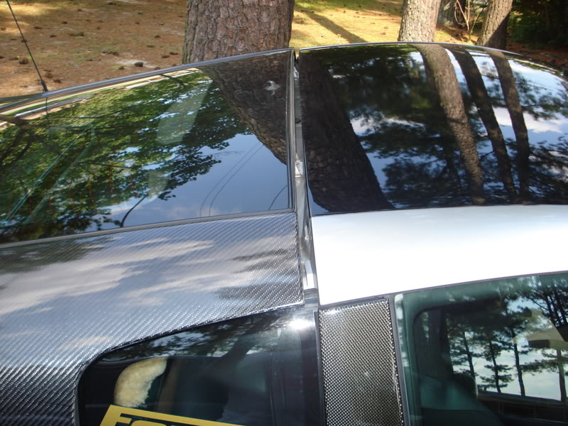

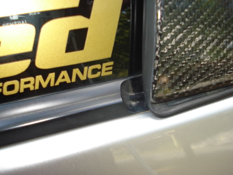

The fitment of mine gave me hell man! Looks good, but not worth the headache...
Edit: I also had to reclear the hatch, the damn thing looked like a piece of dry-carbon!
"The Gap"

Good God man... Holy Gap!!???

You have to take it to a body shop that can drill out the hinges and align the hatch. If you do this, you can not revert back to stock without repeating this process. I would estimate the cost $300-$400 dollars. 3hrs of labor + parts and paint (if needed).

I would have been happier if I got your hatch. My gap was just as bad and the height difference is even worse.
Flip the hinges. Gets rid of the gap 120%. In fact, I needed to use spacers or else it would be TOO tight. The only other problem I have that I couldn't fix with mine was the difference in height between the hatch and the roof.
