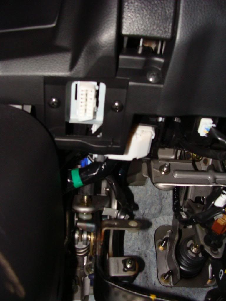

Under my dash is a port that keeps hitting my left foot every time I shift. I try to place it back under the dash but it just falls down again. I am trying to figure out if it is from the Nissan Dealership not putting everything back together or if it is from the Best Buy installers from my audio upgrades. I have been to Best Buy many times and have a pretty good system. I have uploaded a video on youtube showing the port as well as a couple of pictures recorded from my Droid X (yeah I had to throw that in there lol ).

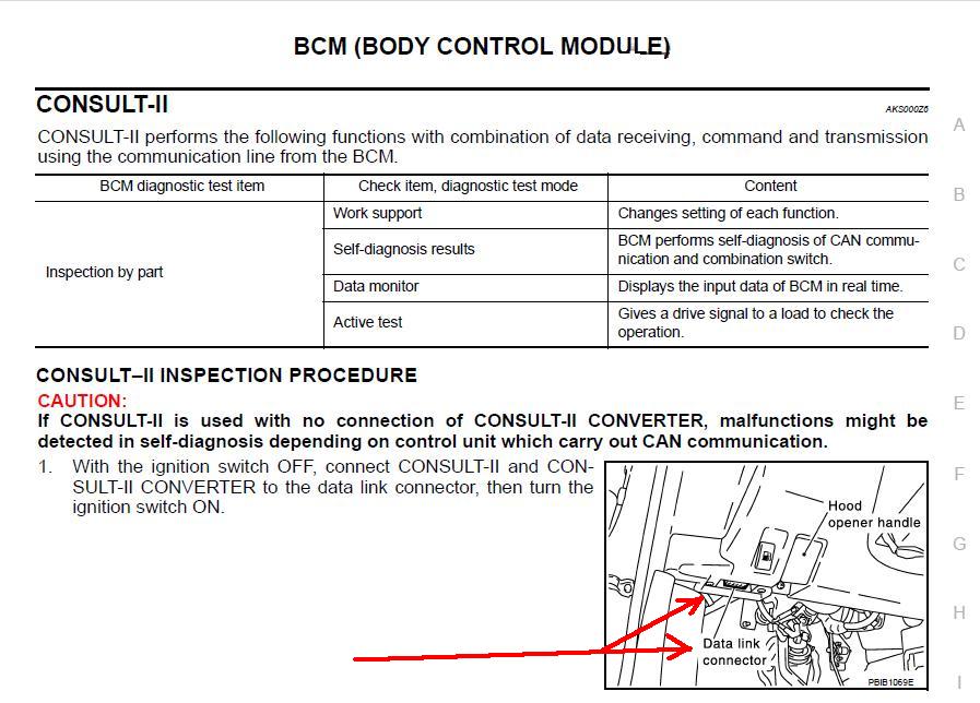

LINUX is right...
its the obd2/nissan consult II connector used for to check engine diagnostics.......
as you can see it has two mount holes......take your time and look up under there and find the oem mount hole locations......reinstall or zip tie it up the hell out the way and shift knee obstruction free...

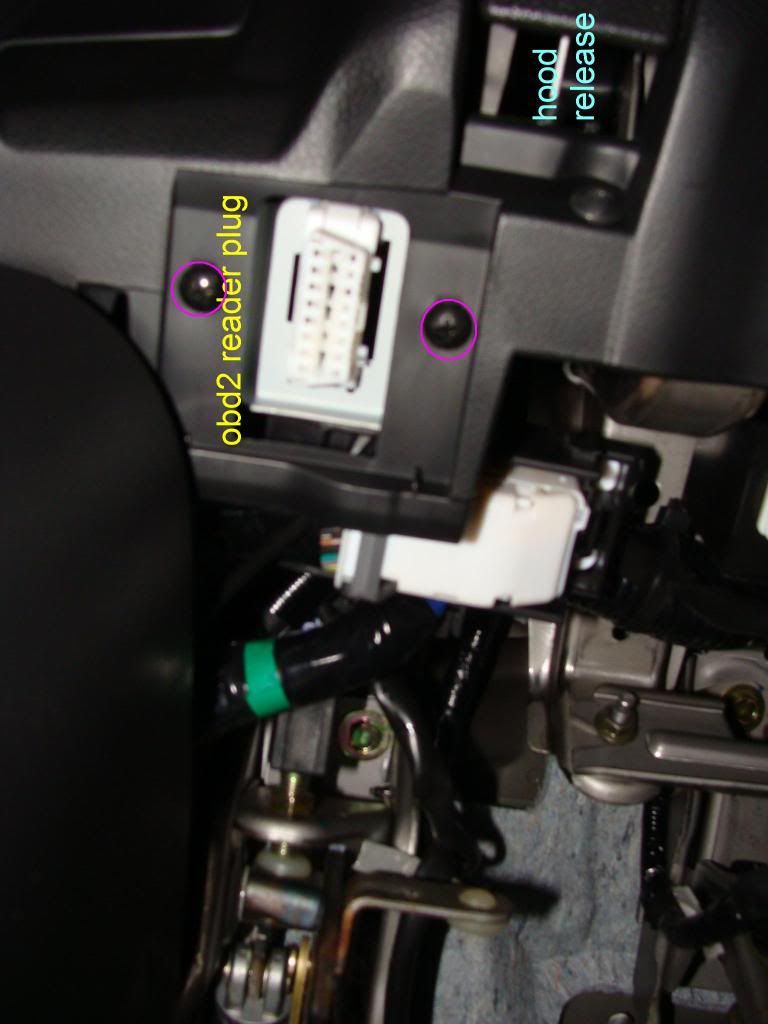

2 small screws, perhaps m6 are holding the plug in place, it has a hole in the plastic for it.
I took 2 pics of it, you can see the hood release to orient the pic for yourself.
Try the threads and mount it in the open hole, it should be visible. Sorry about the pic quality, i guess it needs more time to focus and all the light came from the flash alone.

Looks like the morons who ran your wires form Best Buy never screwed it back up. if you look under a lil more you'll see where it fits snuggly.
