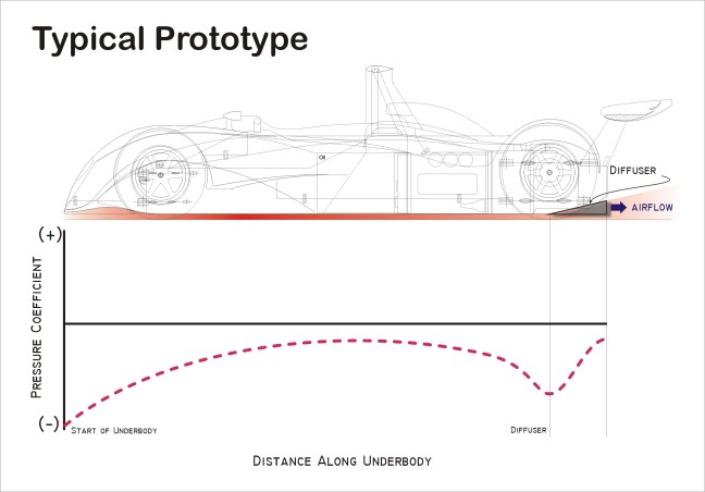

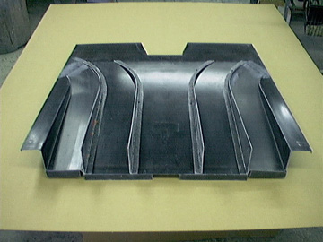

A diffuser is designed to be a functional item.....half the oooh-la-la diffusers out there are just a part of the puzzle.....half the guys on the road courses hitting 100+ on long sections of the track wouldnt get light rear ends and wouldn't need huge wings if they just built a flat diffuser that went from the rear subframe beam to the bumper to eliminate the pocket of air that lifts the rear....
The factory oem muffler even has a triangular sheet metal mounted off the front of the muffler itself to help eliminate this as well......
Most are made from adequately sized sheet metal or marine grade plywood...
Then angles can be calculated for divergence angle, pressure coef and fin orientation to help roll characteristics...
Those are prudy though....slap one on and call it a race car........
-J
