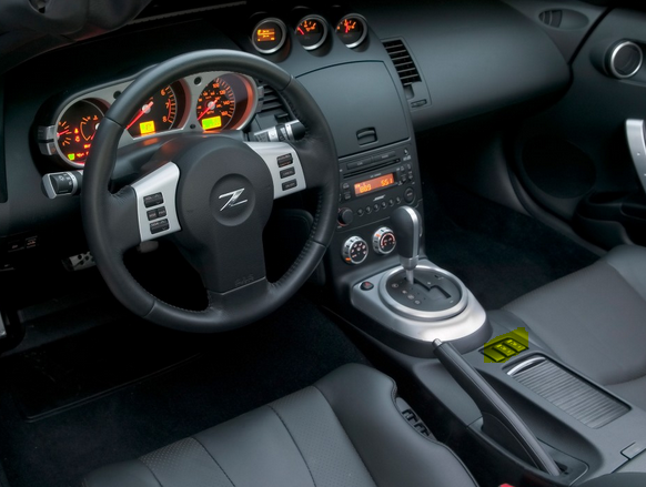

I'm considering attempting use the spot where the seat heater switches go for a iPhone pocket with connection at the bottom. Anyone ever do this? I don't have heated seats (nor need them) and I'm not sure what the far left switch normally would be anyway. What I need to figure out is how deep this space is.
Bad idea? Good idea?

That's a perfectly logical spot to do it. I know that the holes for the switches exist under your blank panel, so you'll need to cut those out. I'd guess that you've got ~2" of space under there to work (just measure the depth of the cup holders and you should have that much space to work with). Also, if you are going to run a cable to connect the iphone to your headunit, you'll have easy access from there.
I personally ran my ipod/iphone cable back to the cubby behind the handbrake. So your positioning will be easy.

If you need to figure out how deep it is, move both seats forward and you'll see a screw on each side. Unscrew those and you should be able to lift the panel - You might have to remove the shifter ring and the part underneath. There's a few inches of space below the buttons, and I believe the far left switch is an optional winter/snow mode on some Z's, but in general it's blank.
