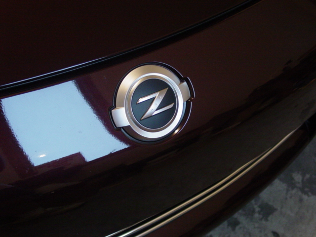

Are these the ones you are referring to?
If so, I just used the tape that came with the emblem. Just peeled and stuck it on. It's been there around a year and no problems so far. No special method but I don't think you want to wax the paint before you put it on. I just cleaned the area with alcohol to remove the last of the old adhesive.
