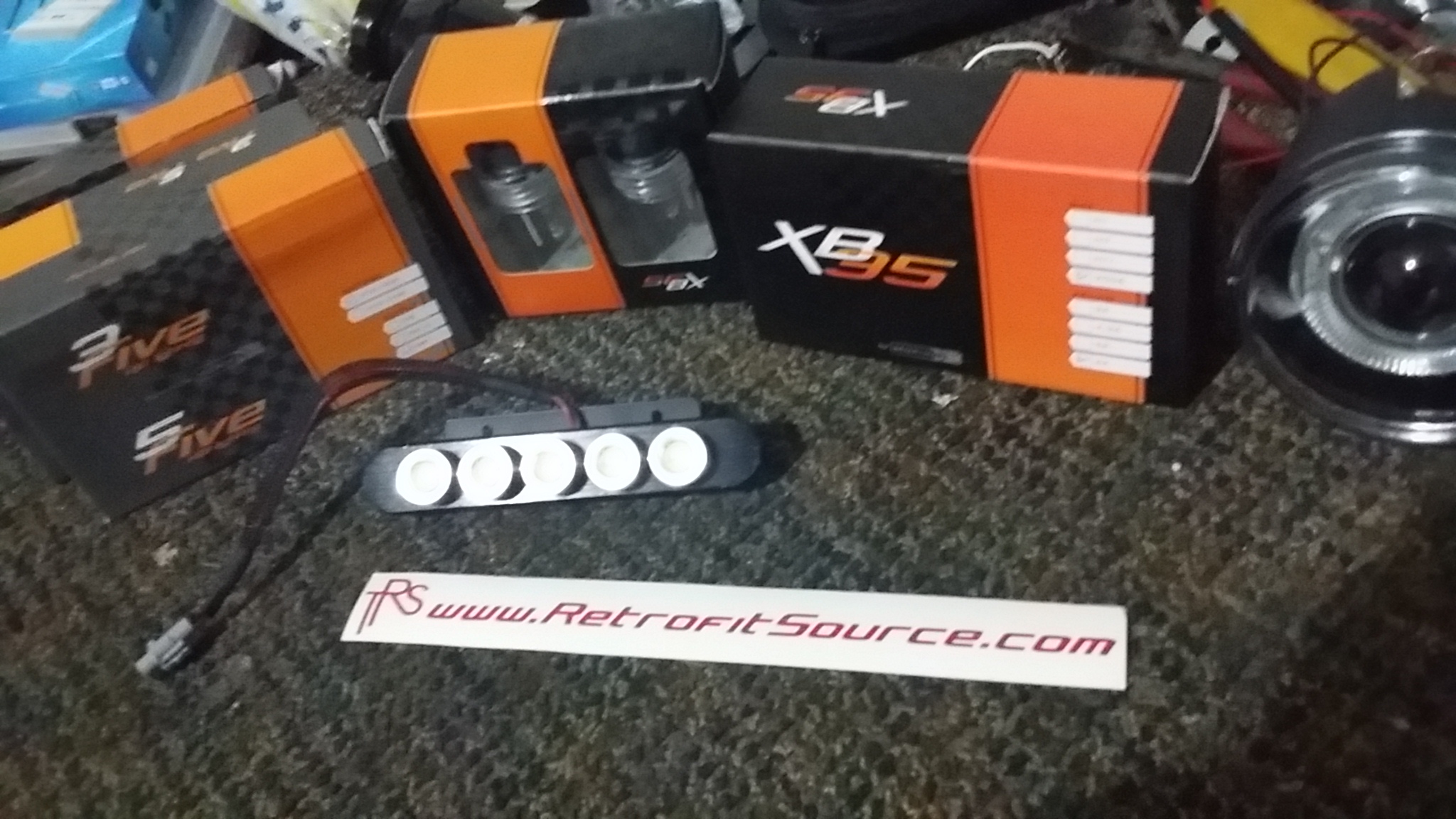

A big box of jazz from The Retrofit Source...
Xb35 bulbs and 35 watt ballasts n wire Harnesses for the Chrysler...some new bulbs for the z...

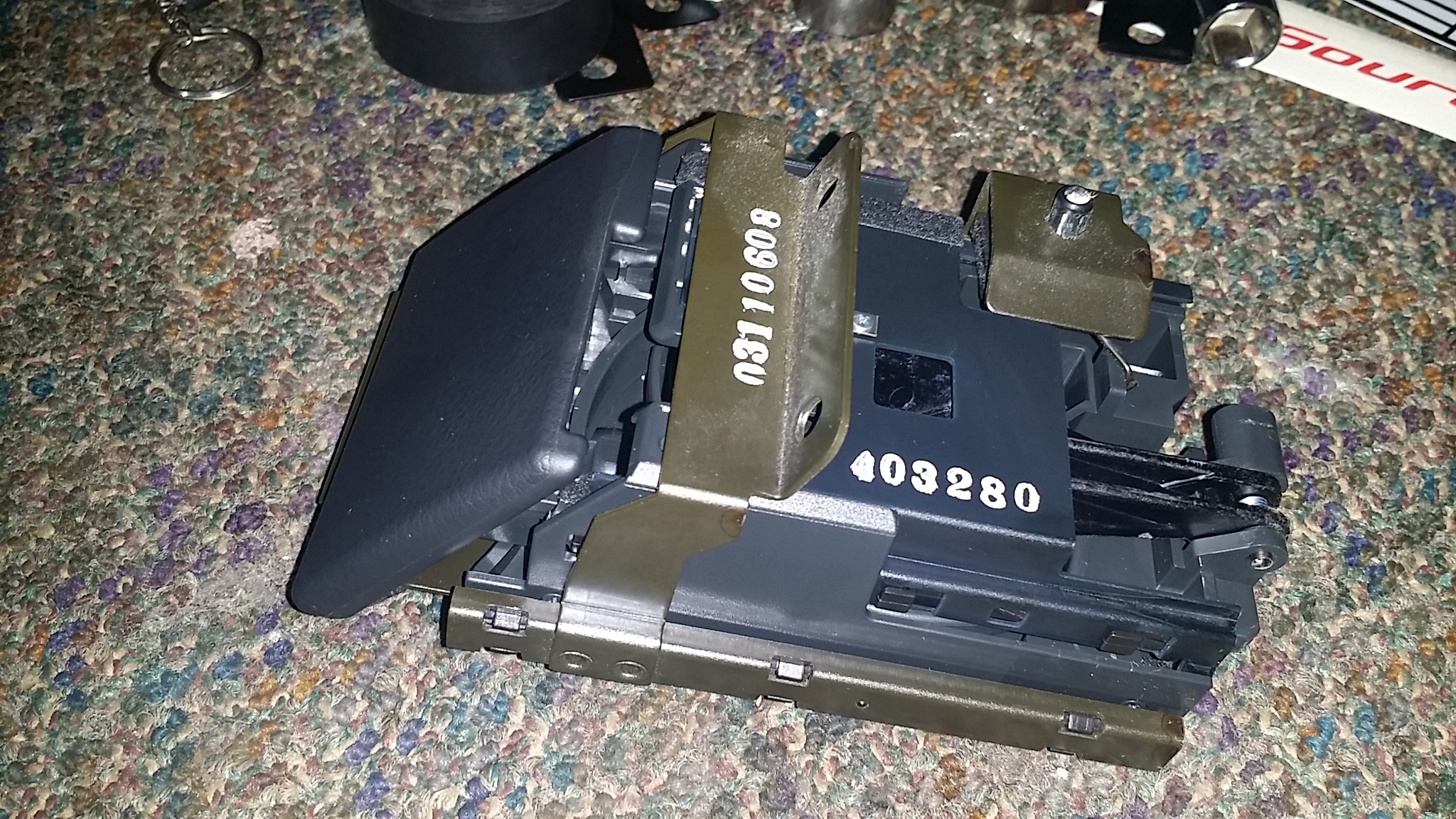

Also thank gawd Cobi is parting his z.. found some.nice trinkets I've been missing.. namely the bracket that holds the cupholder in.. i coughed up.the 70 bucks for the cupholder only to find its just the inner slide out part. ..faaaaak!
Picked up the bracket and the battery compartment fuse cover and some Weather stripping from him

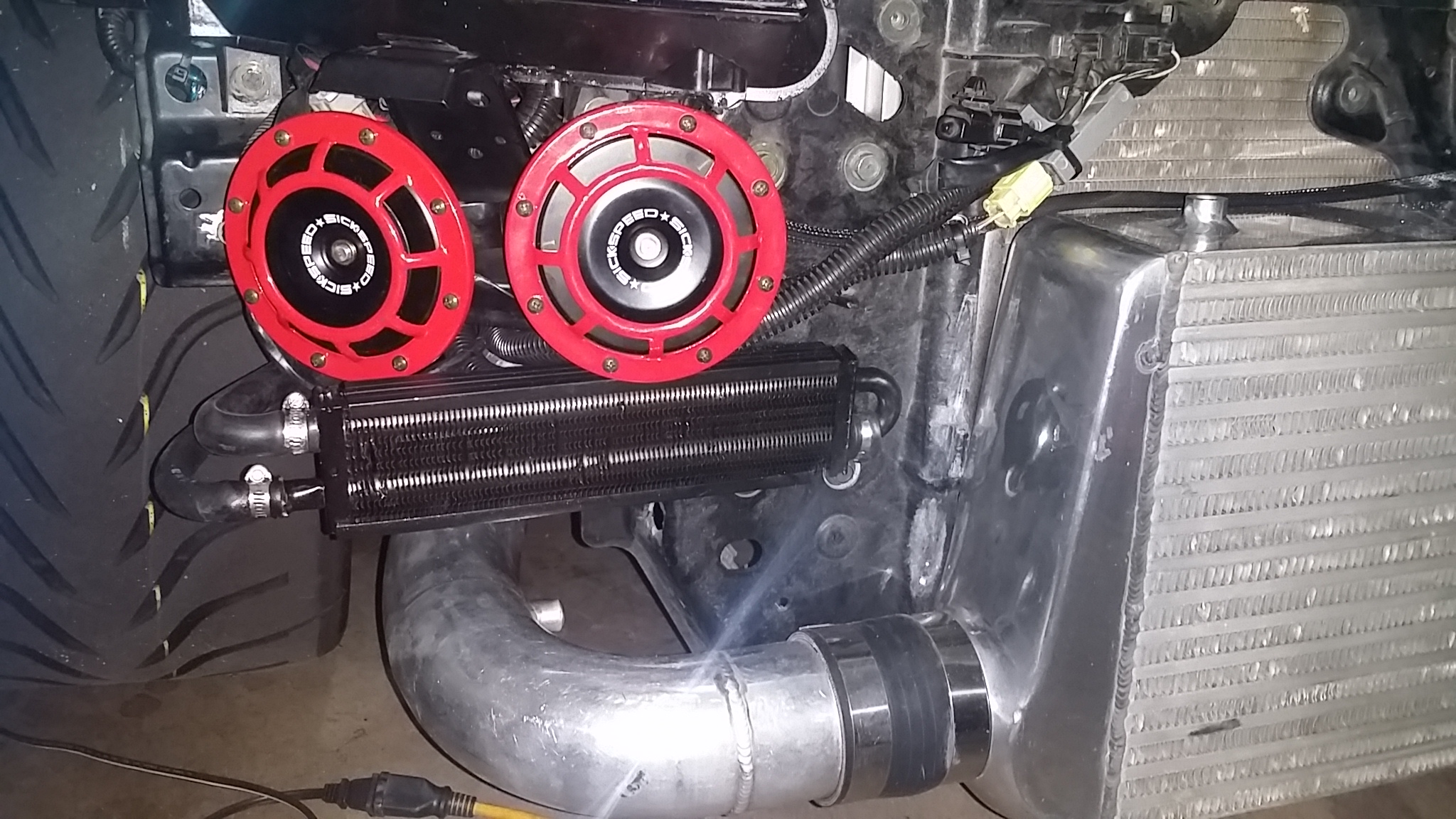

Threw down on some Hella Supertone horns... btw Sickspeed sells the exact same.thing for half the price.. 32 bucks shipped.. it's manufactured by Hella..same part #s etc.. these are super loud and shrill as hell... scary.

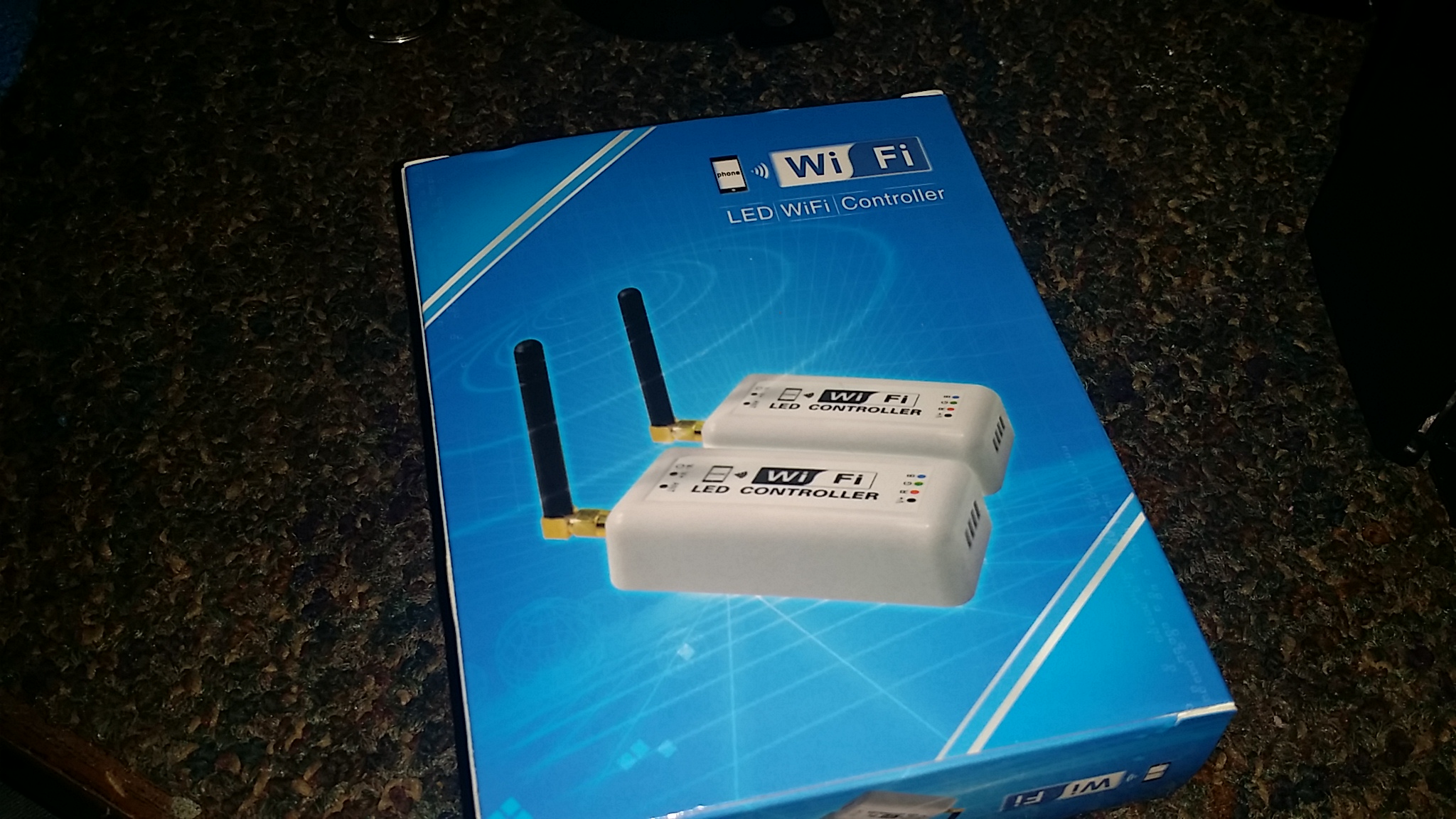

Also got my wifi Android controller for the Showtime rice tastic rgb lights I'm putting in under the hood , footwear and rear stb..

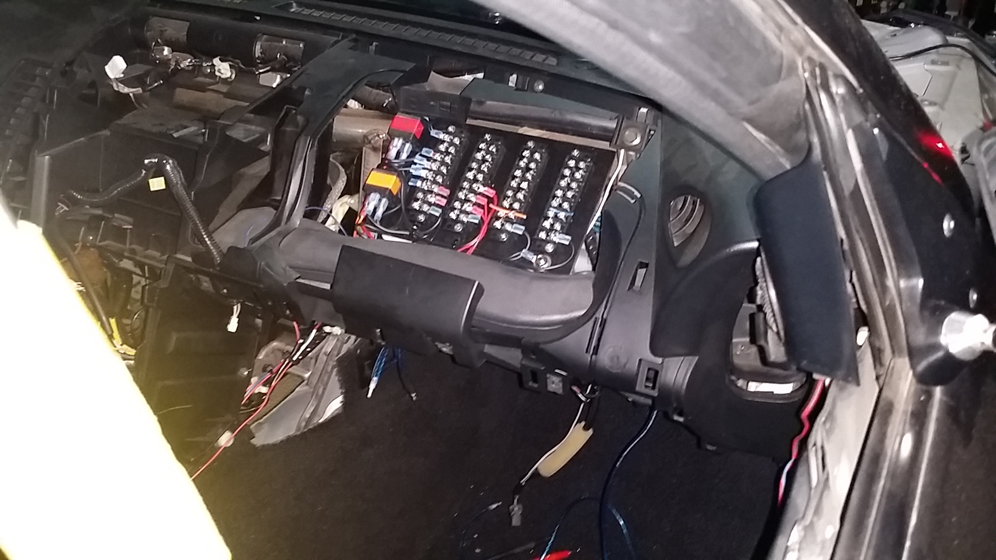

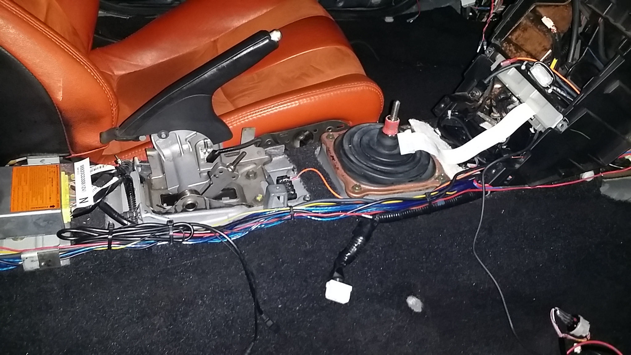

major wiring projects over the weekend..
doesnt look like much, but i made a "relay board" so that any item i want to wire up can just plug right into this thing and be completely and cleanly powered up and relayed w power direct from the battery post.
I pulled more of the dash sides off than i had previously and it helped run wires in a better cleaner manner as well.
Ordered a z33 specific ignition harness for my turbo timer ( totally unnecessary item, but its cool and does o2 and voltage as well) , rewired my Defi basis HUD, my Apexi throttle booster/controller.. and wired up provisions for back up cameras etc.

did you remove the passenger side airbag?
You may want to look into a DC-DC power supply. Voltage off the battery is not very clean at all. Has lots of spikes with load. LED's wont last long if you put 14.7 on them instead of 12v (when wired for 12v). But if you do the DC-DC keep it only for resistive loads...no solenoids.

Yeah the airbag ahs been long gone.. once long ago, the concensus was that removing one airbag disabled them all.. later this was found to be untrue... and now i have aleady sold many of the bags in the car.. pretty lame.
anyways its an optima, i hear theyre a bit better about "cleaning up" power, but honestly, its not going to be any more or less buffered than connecting it elsewhere in the car.. this just makes it a cleaner install i guess.. no performance improvement was really sought.. i just wanted to get rid of janky wiring and make it easier to put in things that ive been seriously slacking on due to the wire mess my car used to have under the dash lol.
