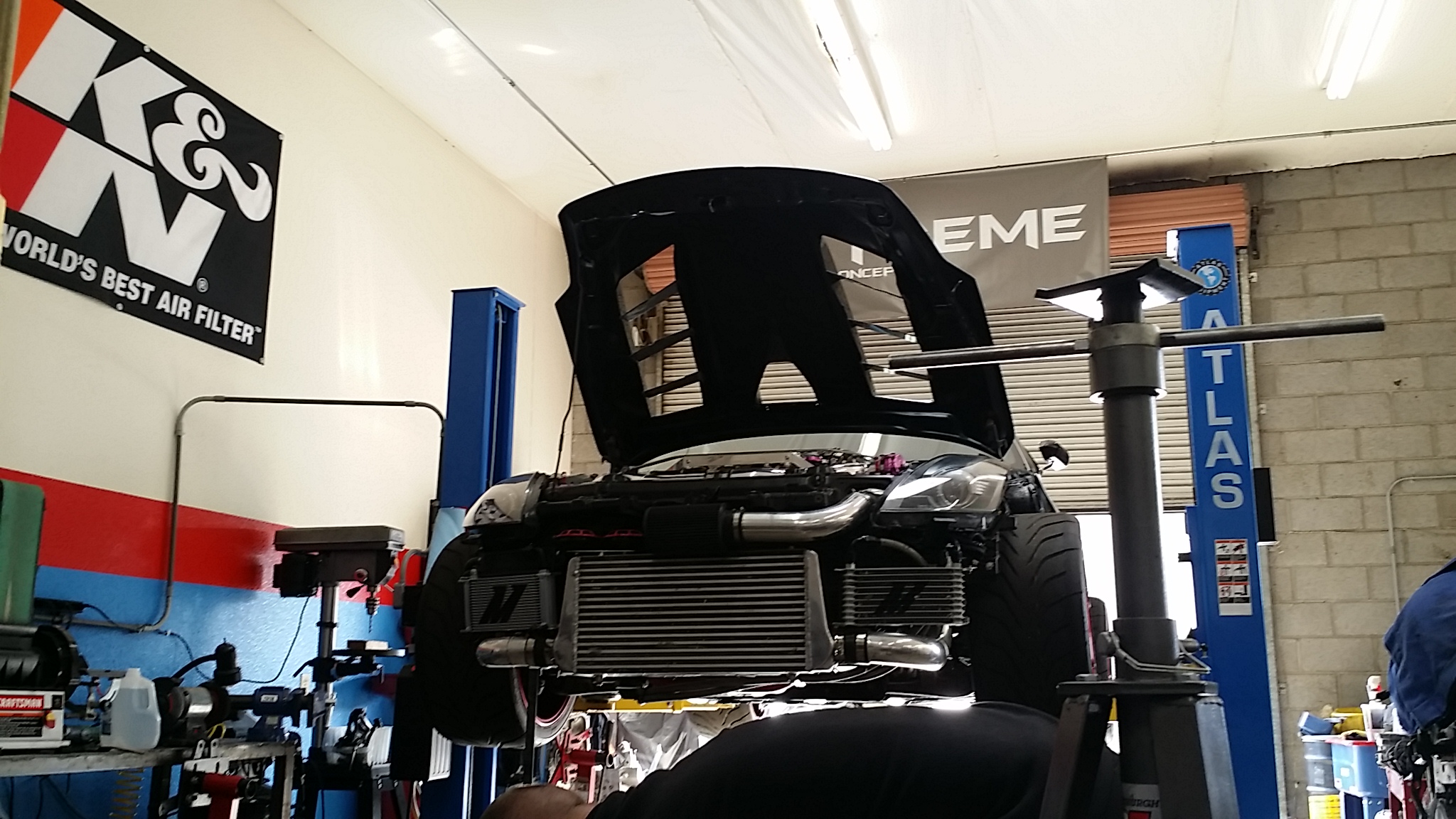

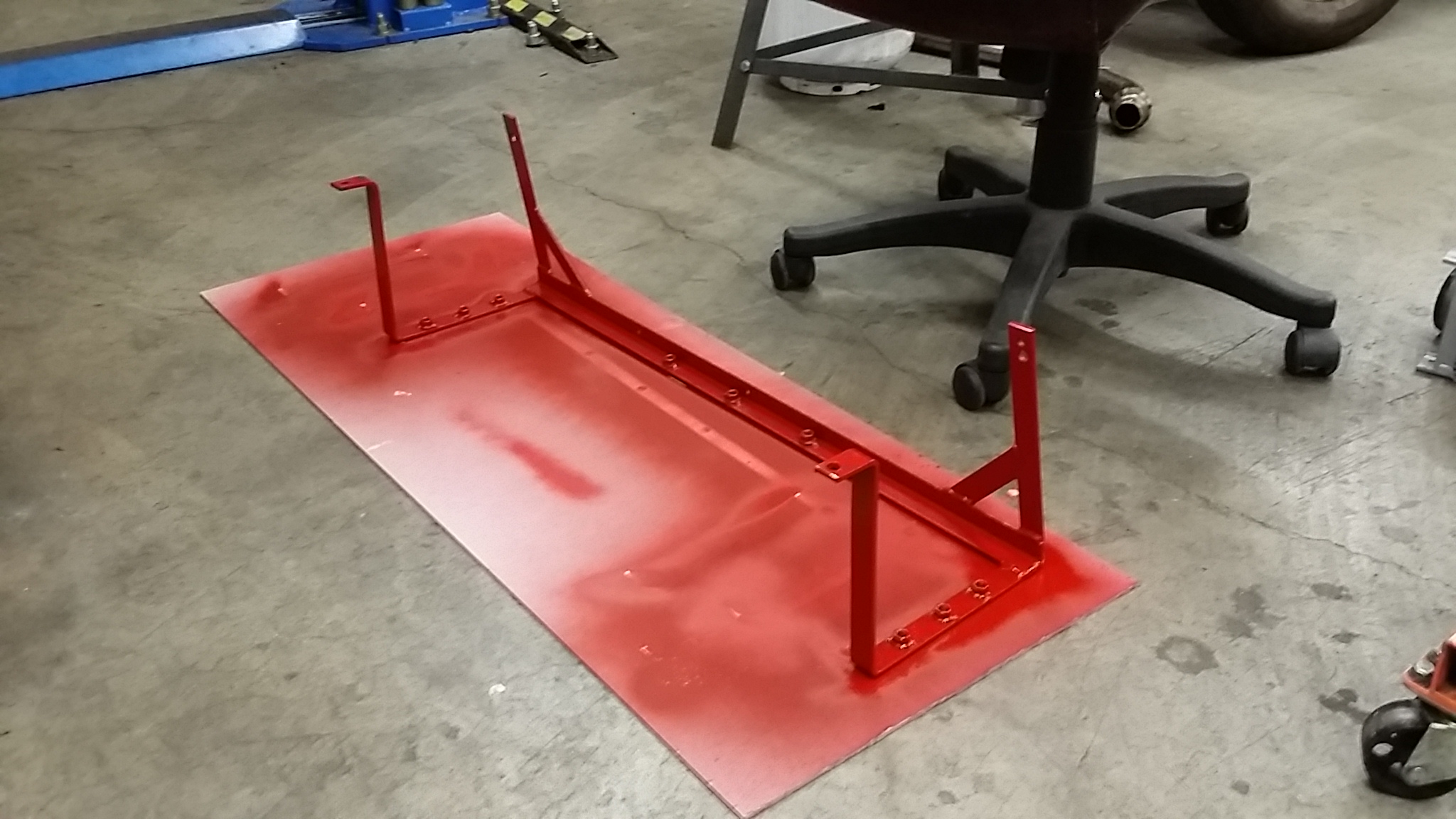

lots of movement over ther long holiday weekend.. we got the splitter rough cut )( nice and oversize.. so that way we have room to shape to our liking at the body shop)

The Evor R ti cover came in as well.. w custom finish.

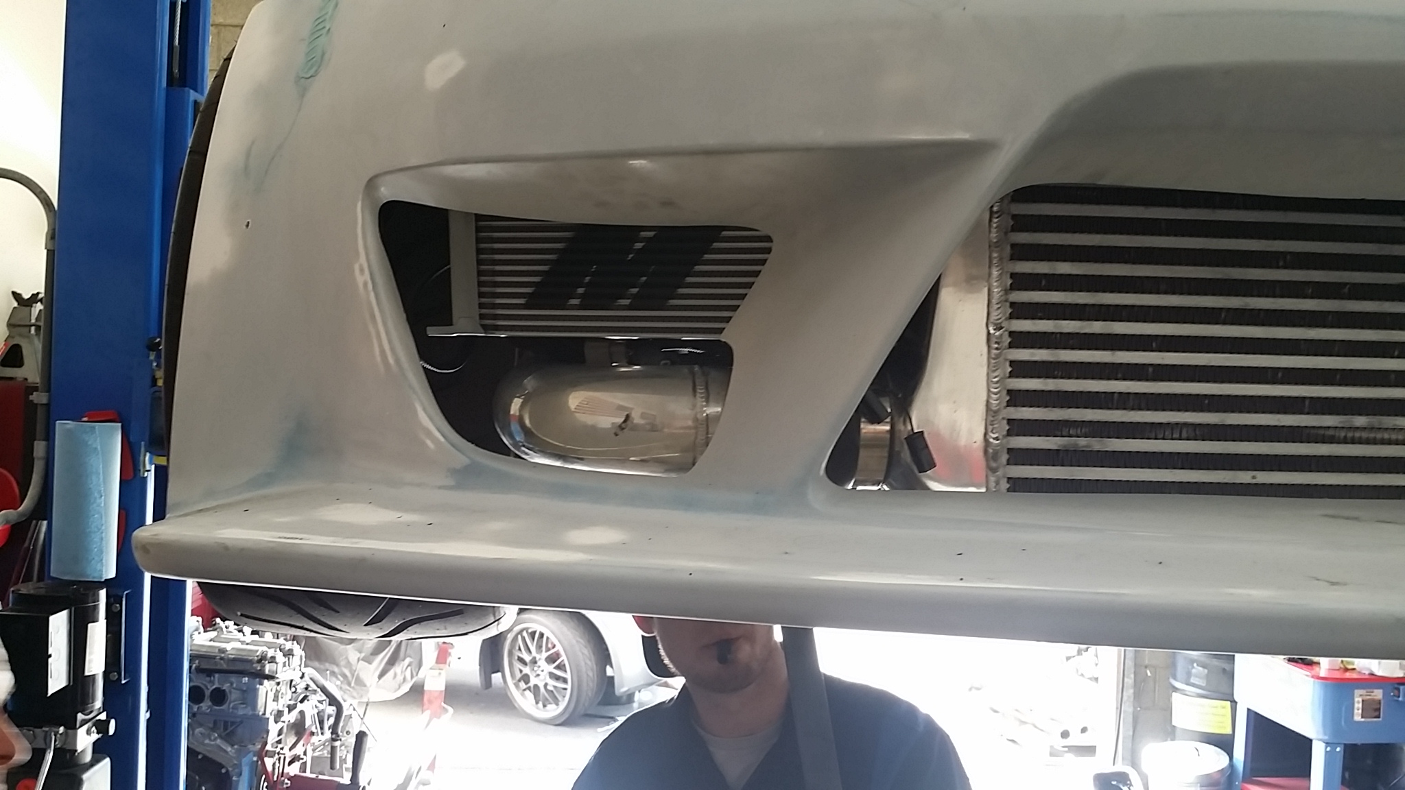

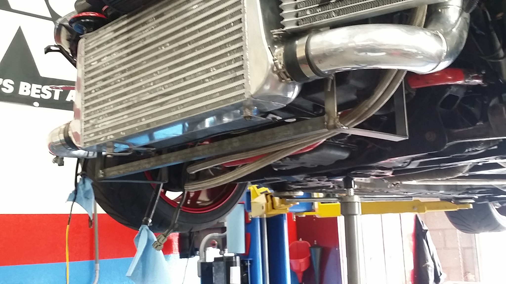

we also got the brackets for the passenger side Mishimito cooler core to mount up in concert w the oil cooler on the drivers side.

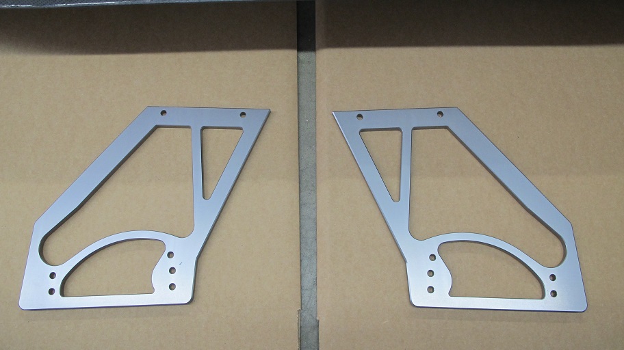

we got the steel splitter bracing bent and welded up as well.. and a quick coating of red caliper paint will protect the metal.. this will be the main piece that we will mount the longitudinal bars that protrude out to the bumper tips.. as well as a latitudinal bar that will span the bumper side to side near the wheel well opening.. as it stands its surprisingly light weight and very very stout. Thers no movement side to side as its gusseted.

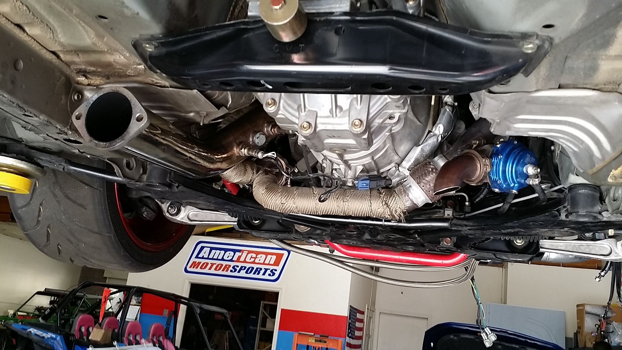

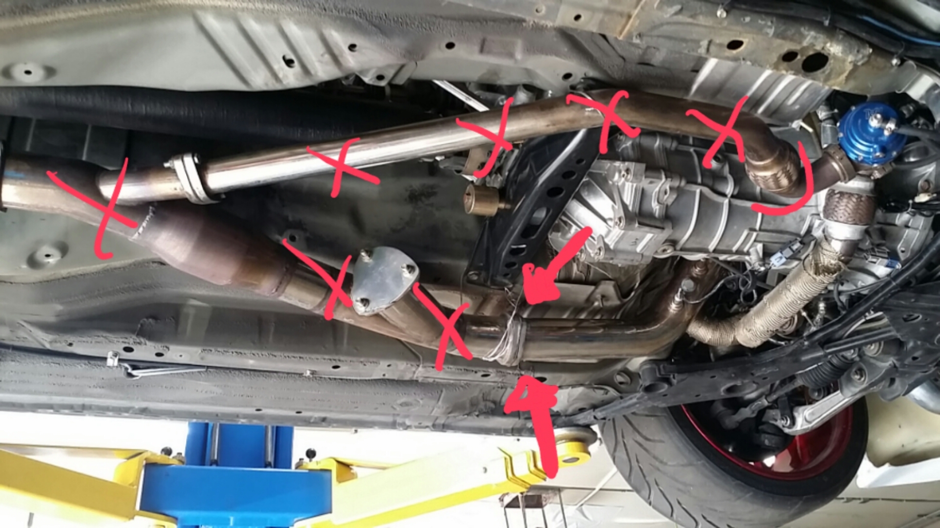

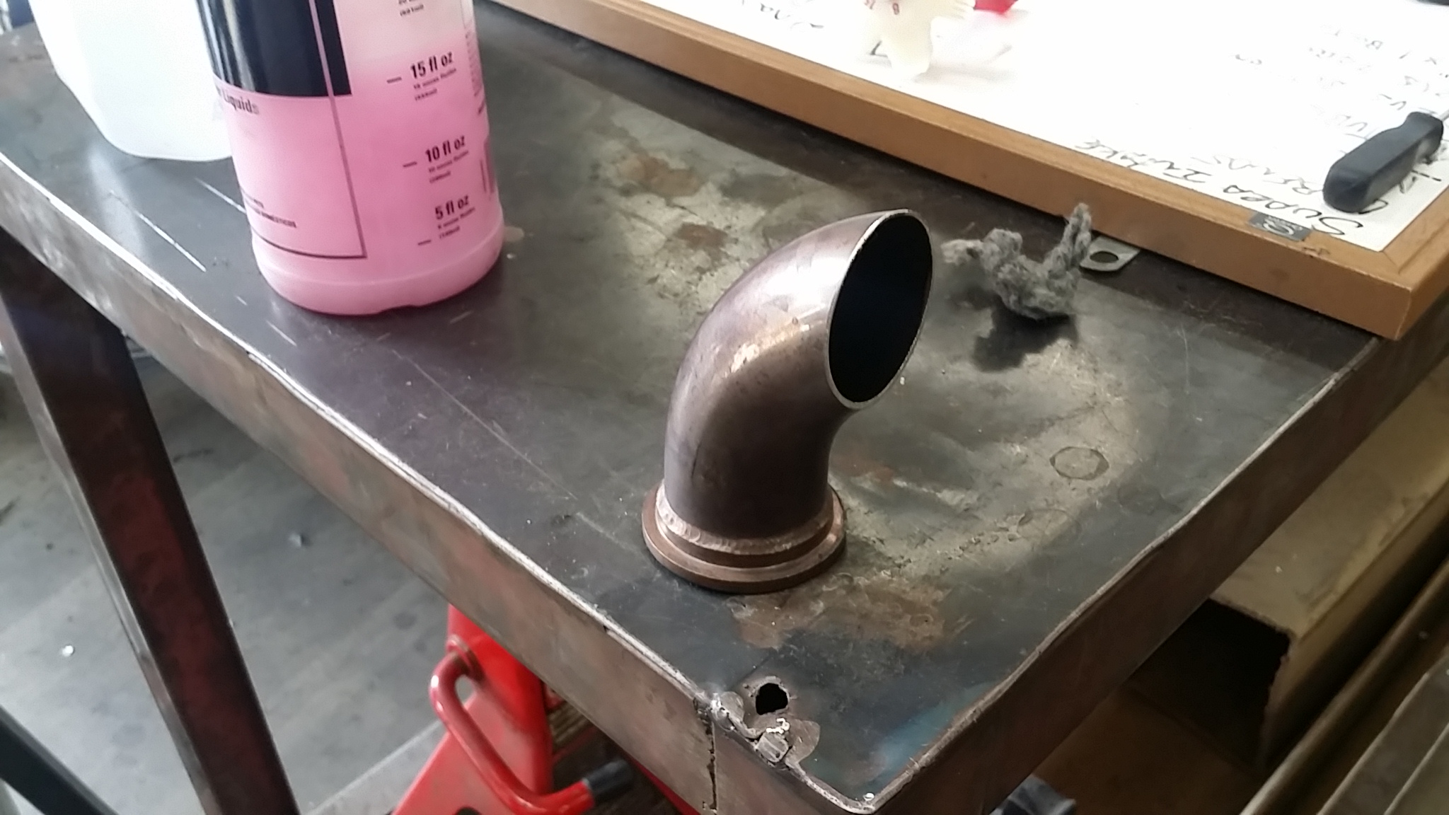

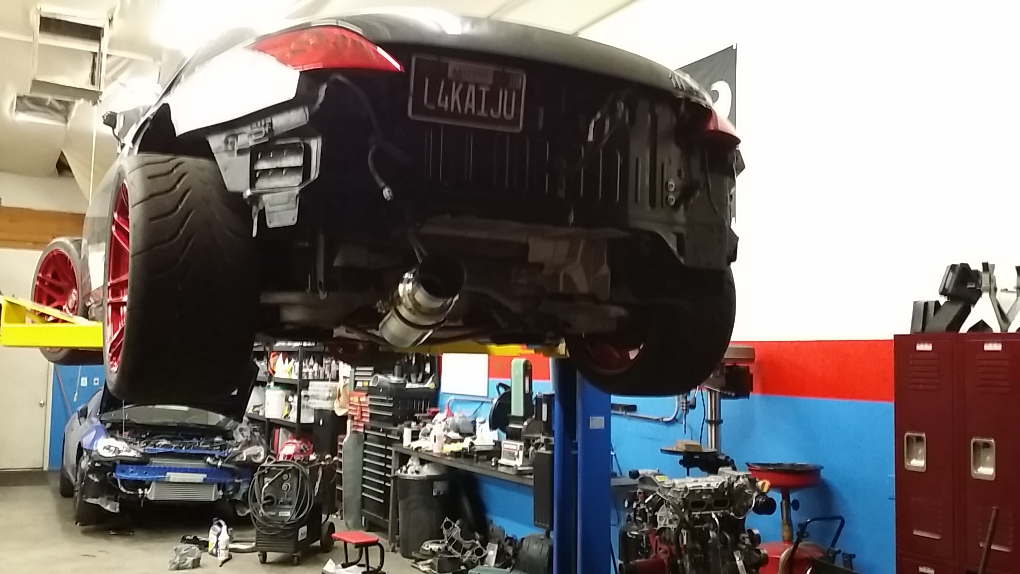

I sold my HKS rep exhaust back end... and we removed a large deal of piping from my previous exhaust.. including the wastegate recirculation.. it is now open dump!

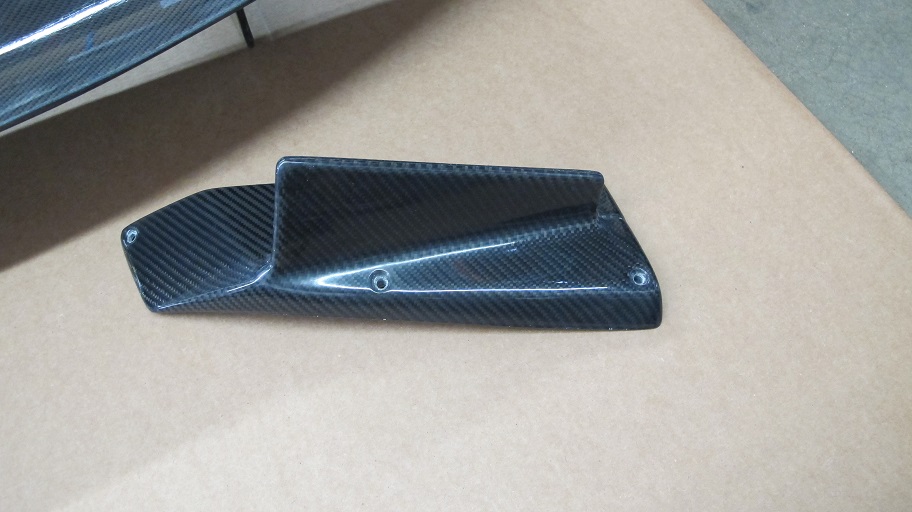

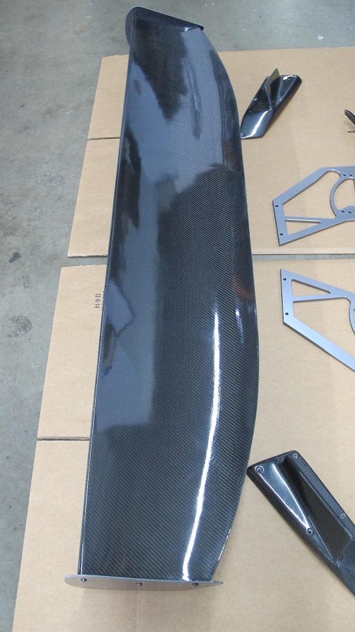

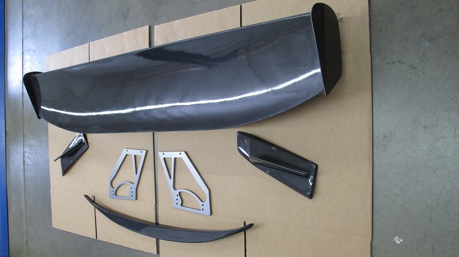

behold.. my birthday present to myself has finally landed..
sure beats a check from grandma for twleve dollars.. or uneventful, sweatpants and no make up bday sex from your miserable wife. lol.
Old Jan 20, 2015 | 08:22 PM
  #849
KingBaby's Avatar
KingBaby
Hardest Setting
Posts: 13,406
Likes: 130
So that was a three month wait?
Looks great !
Old Jan 20, 2015 | 10:30 PM
  #850
XM 1's Avatar
XM 1
Posts: 1,535
Likes: 33
From: Germany

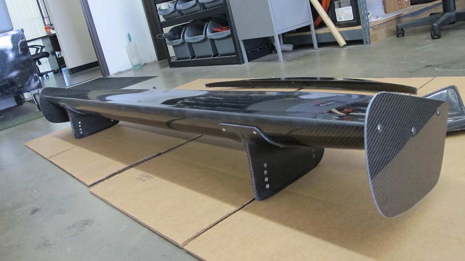

nice parts! do you really have to drill the holes on the wing stays by yourself????
Old Jan 20, 2015 | 10:54 PM
  #851
KingBaby's Avatar
KingBaby
Hardest Setting
Posts: 13,406
Likes: 130
Good eye
Old Jan 21, 2015 | 08:35 AM
  #852
bmccann101's Avatar
bmccann101
Posts: 8,321
Likes: 467
yeah thats super weird.. im lightly alarmed.
i messaged my dealer..
Old Jan 21, 2015 | 11:41 AM
  #853
bmccann101's Avatar
bmccann101
Posts: 8,321
Likes: 467
no reply from japan yet, but i went and zoomed in on various google images of the wing. and lo and behold.. all the bolt holes are different on each example lol.
I mean.. its not like its a nutsert or anything.. its straight thru bolts and the CF piece there is totally solid.. but DAYMN...
thats a sketch hole to have to drill through a new wing.
Oh well.. man'd up.. ill be fine.. we will get it done easily enough.

haha no for sure man.. i just wanted to make sure that this is waht is SUPPOSED to be done .. vs " oh sht.. we forgot to build it right" lol.
as you can see in most of the pictures.. this isnt deep dark water, shiiny and perfect, cleaned up carbon fiber.. G Mak is kind of known for that unfortunately, but what it is is hand made to order.
You can still see the mold release wax on the pedestal bases too lol.
I would imagine it needs a clear coating as well still. Top of the wing is getting vinyl wrapped black anyways... everything turns yellow in the AZ sun.
it really is!?!?! first i was like wooow nice parts...and then wait! are there really no holes drilled for the stays doesn't make sense to me why they didn't.....because trust me i know carbon fiber and if you don't be careful enough with the drilling you can ruin the backside of the drilling hole .
they really should drilled the holes for the price this part costs.....but i'm pretty sure you'll handle the drilling just fine

yeah i want it done professionally tbh.. and i dont want ANY play in the bolts. that just screams out for stress cracks and wobbling.. i want the holes tight on the bolts so its not just the job of the fasteners to sandwioch it all together, but to hold the wing frmo mving on its own even if it was losely tightened.....so I will likely take it to a maching and composites place vs jsut drilling it out on a press.

good idea! still sort of shocked that Garage Mak didn't drill the holes in there...or at least epoxyd some steel tubes into the carbon fiber for better support.
