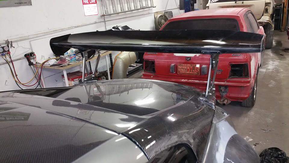

car and wing and titanium hardware have all been dropped back off at the body shop..
the alternator and voltage issue cured 99% of my dirveability issues.. very fkn weird.
and the parasitic draw comes from the constant power on the Accuair ECU.. almost .7 draw.. added an 80 amp continous realy in line for the stereo wiring and accuair power supply.. accuair said the ecu is ok to be moved to keyed ingition too.. which is double weird..
Also swapped out the optima for a big @ss lead acid battery.. an inch larger than our usual group 35 battery.. its a snug ft but im happy w it.
90% of the interior was reinstalled Saturday...
wing being installed this week too. Pics to come soon.
Car is almost complete.

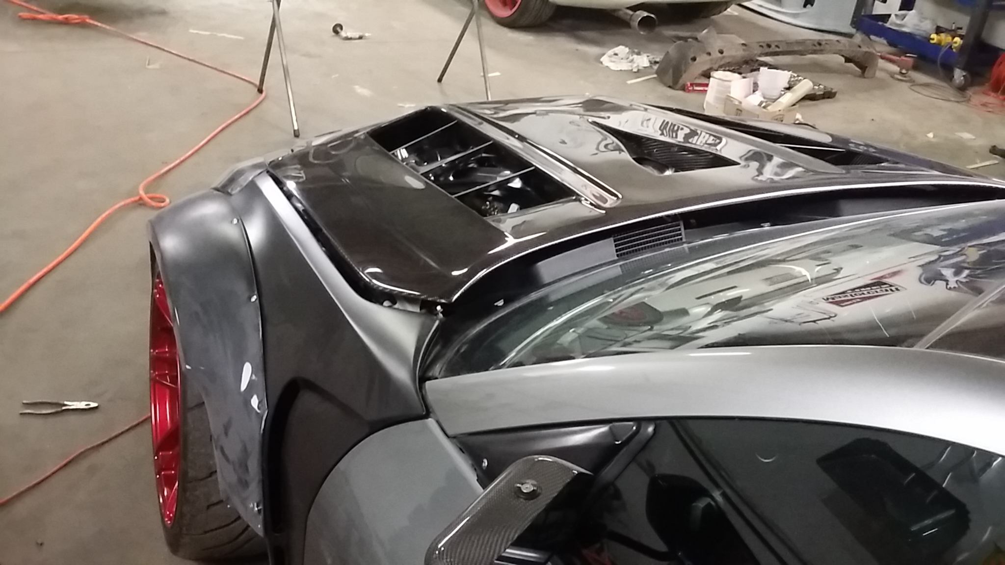

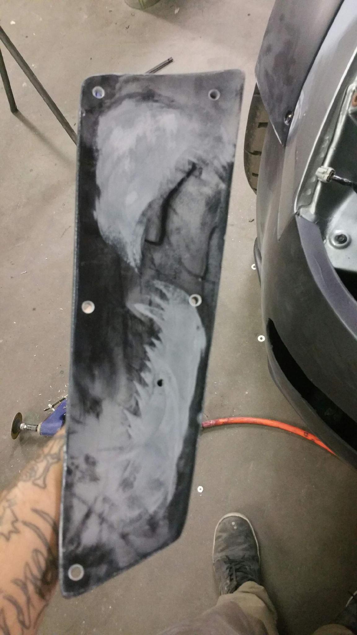

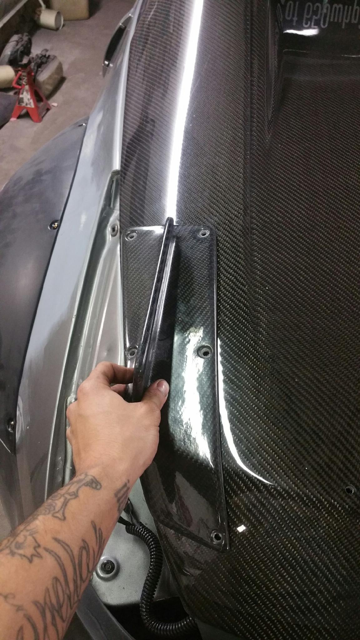

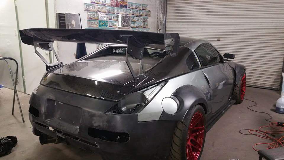

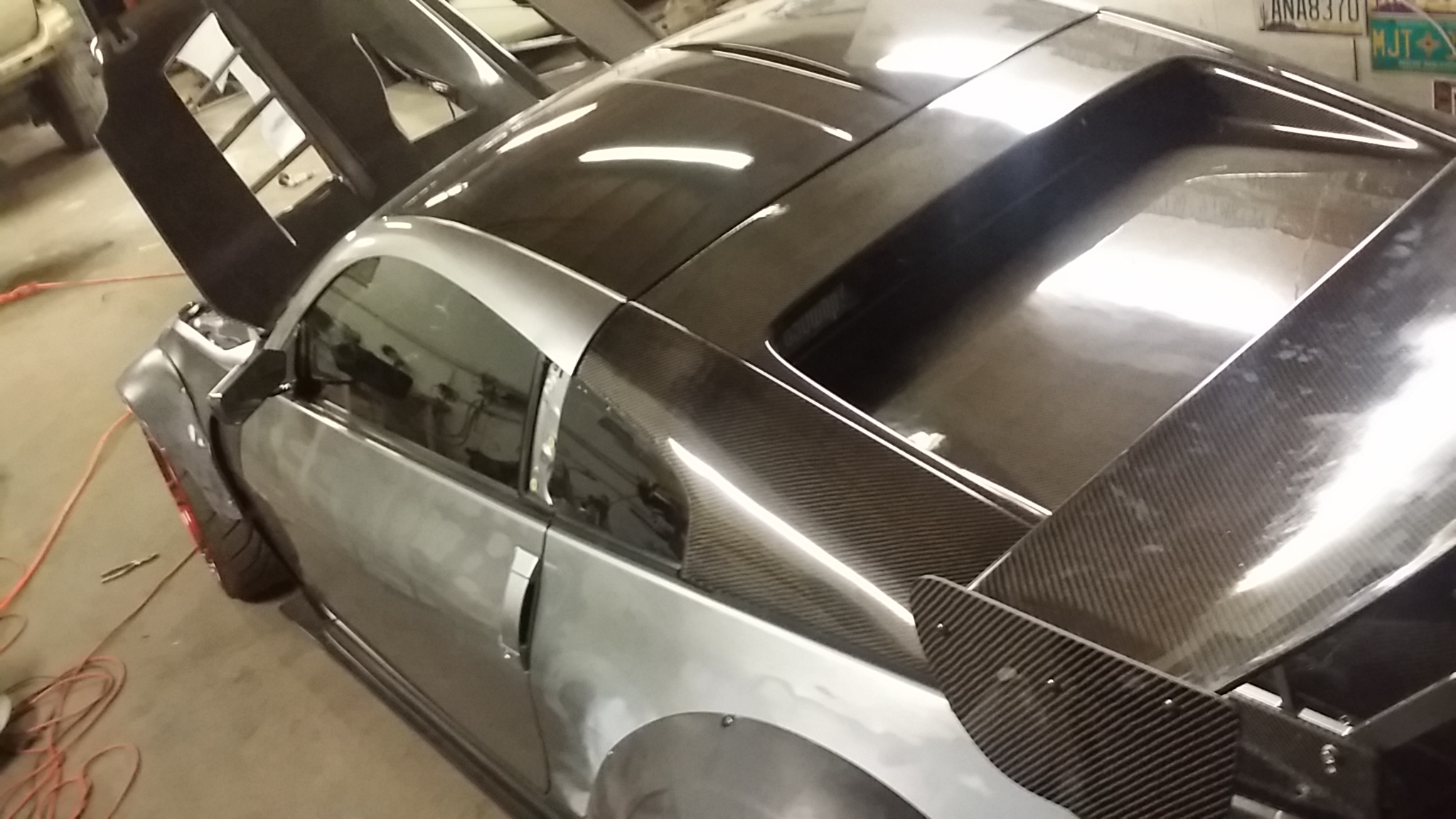

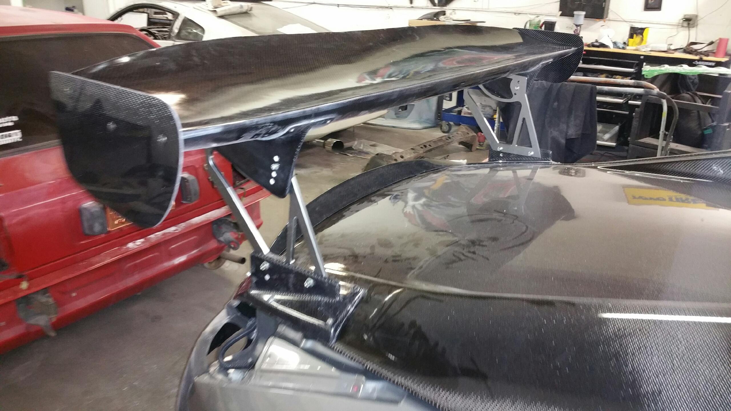

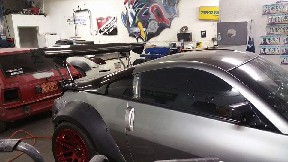

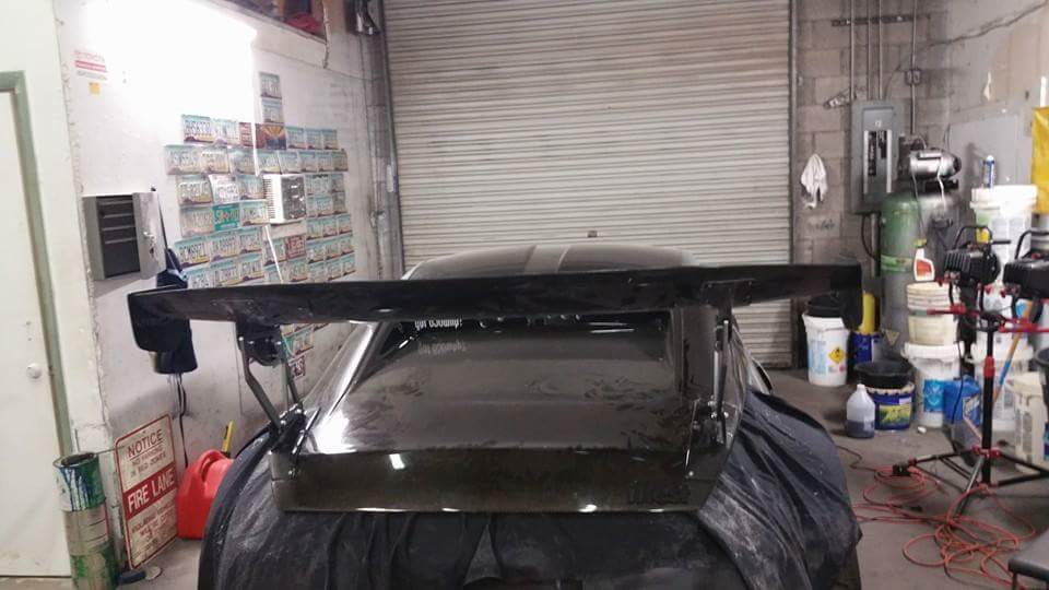

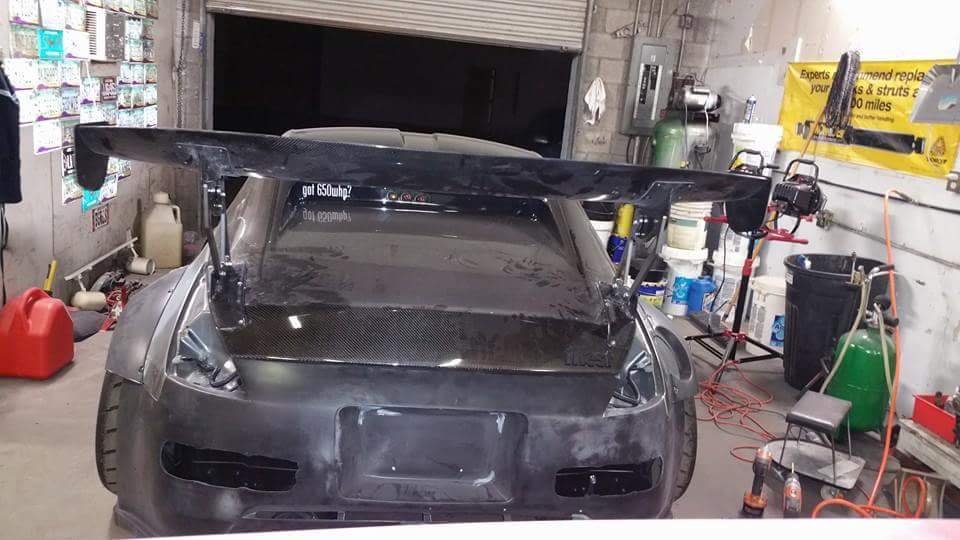

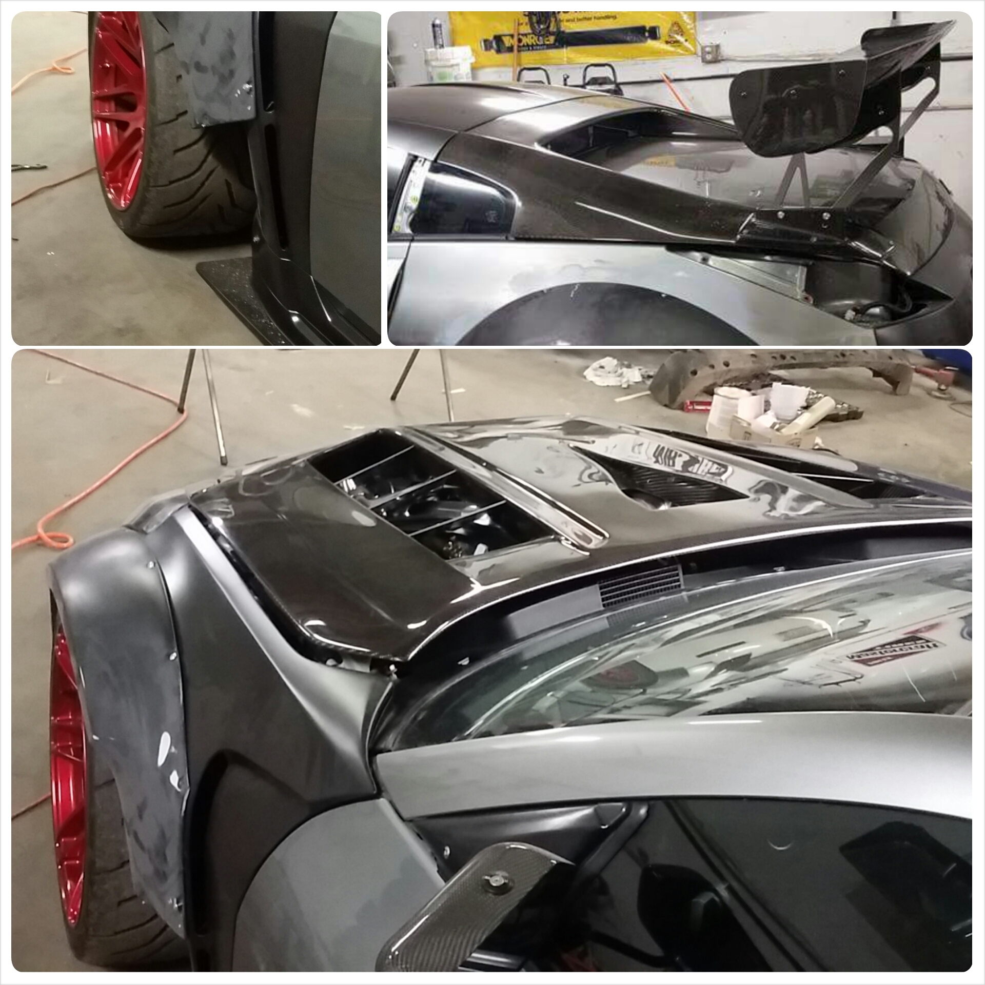

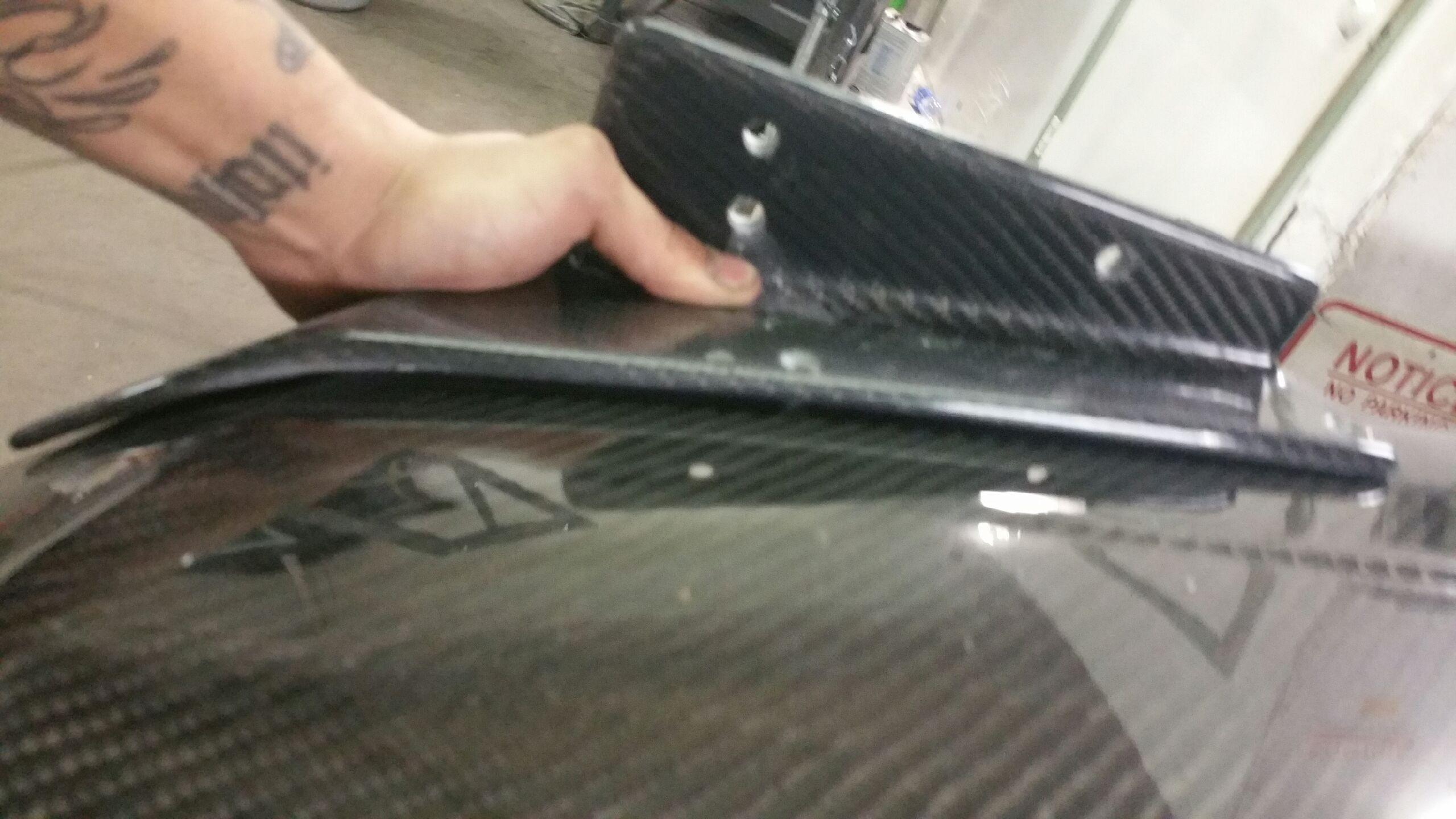

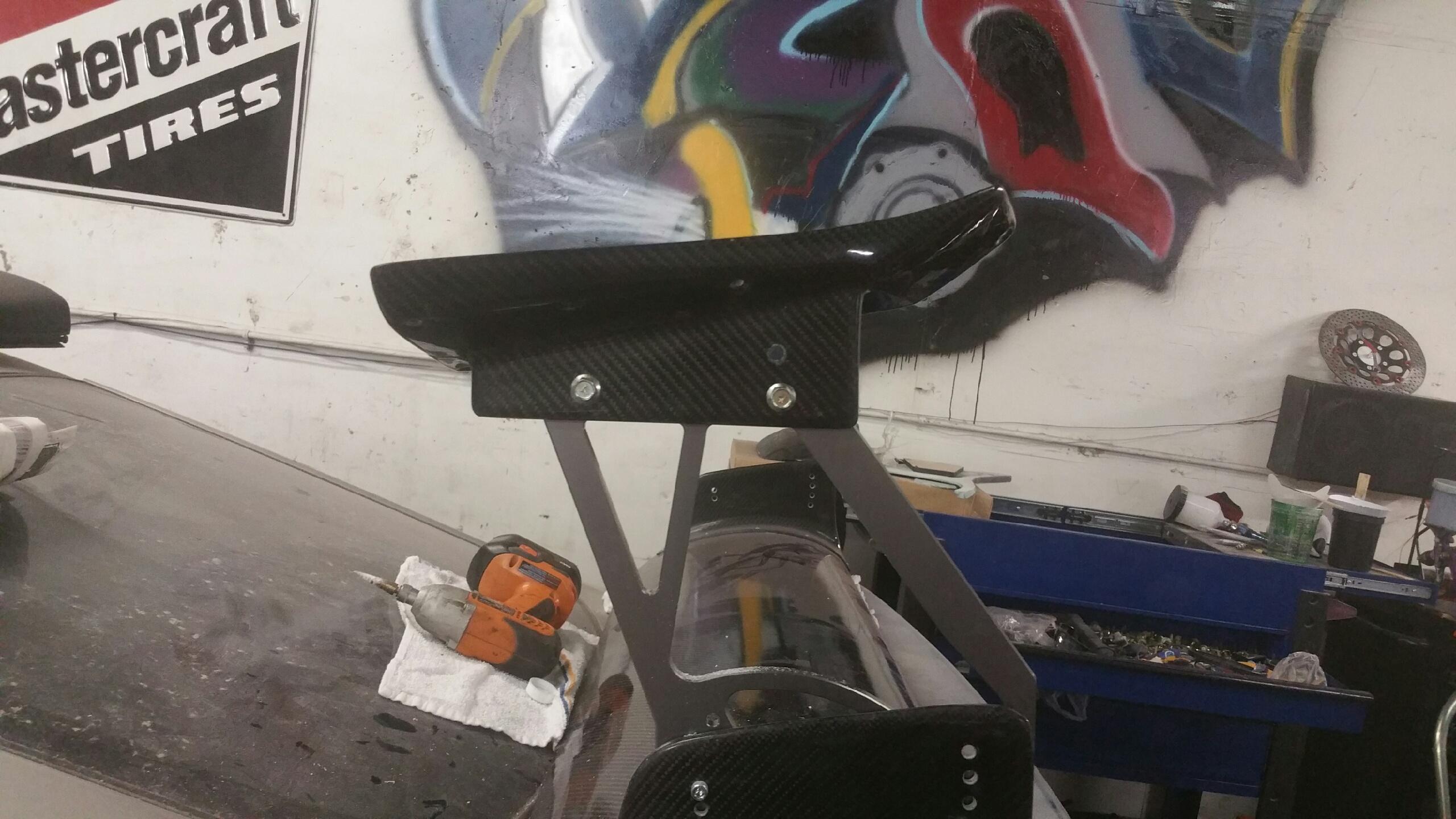

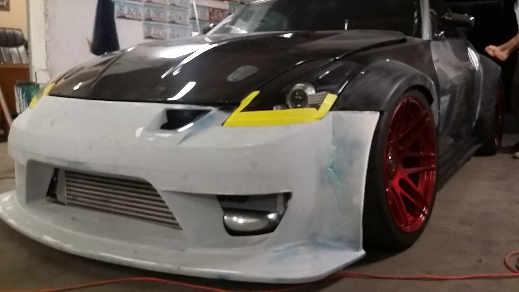

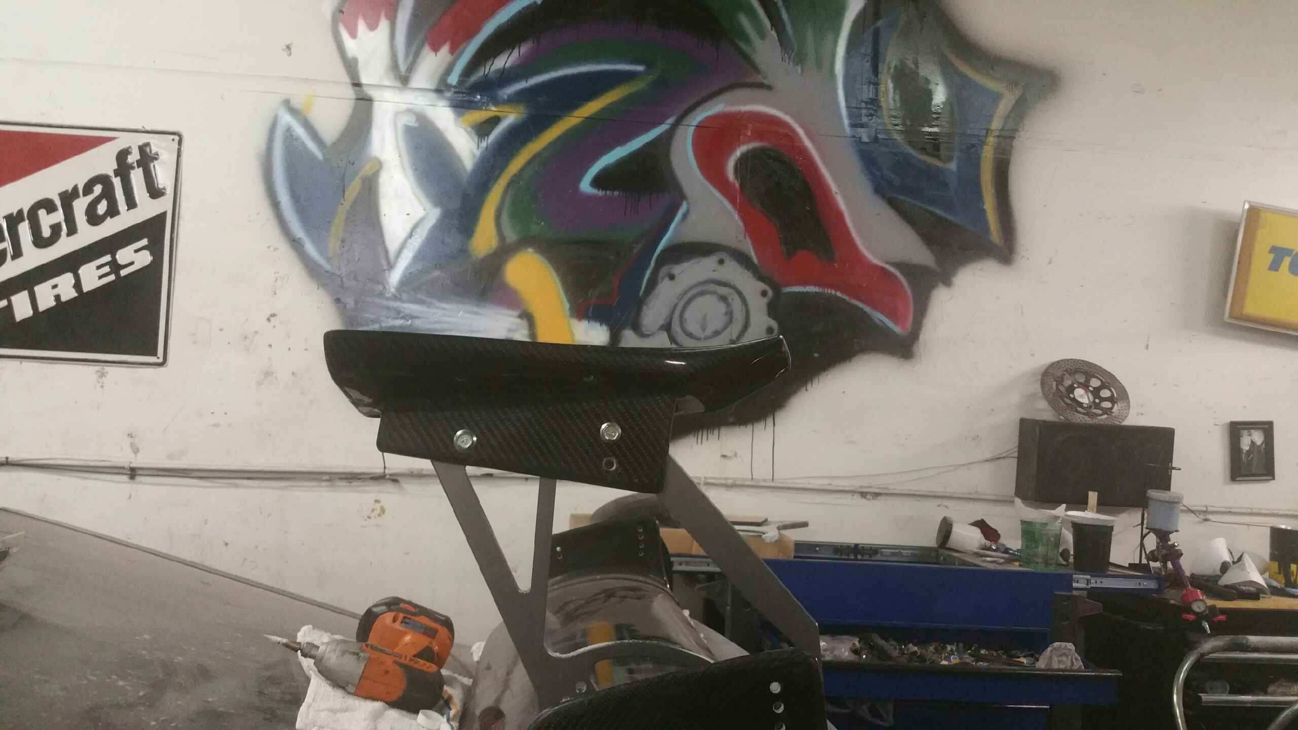

since thers very little in the way of Garage mak built progress shots so far.. here...
have 6 million of mine lol.

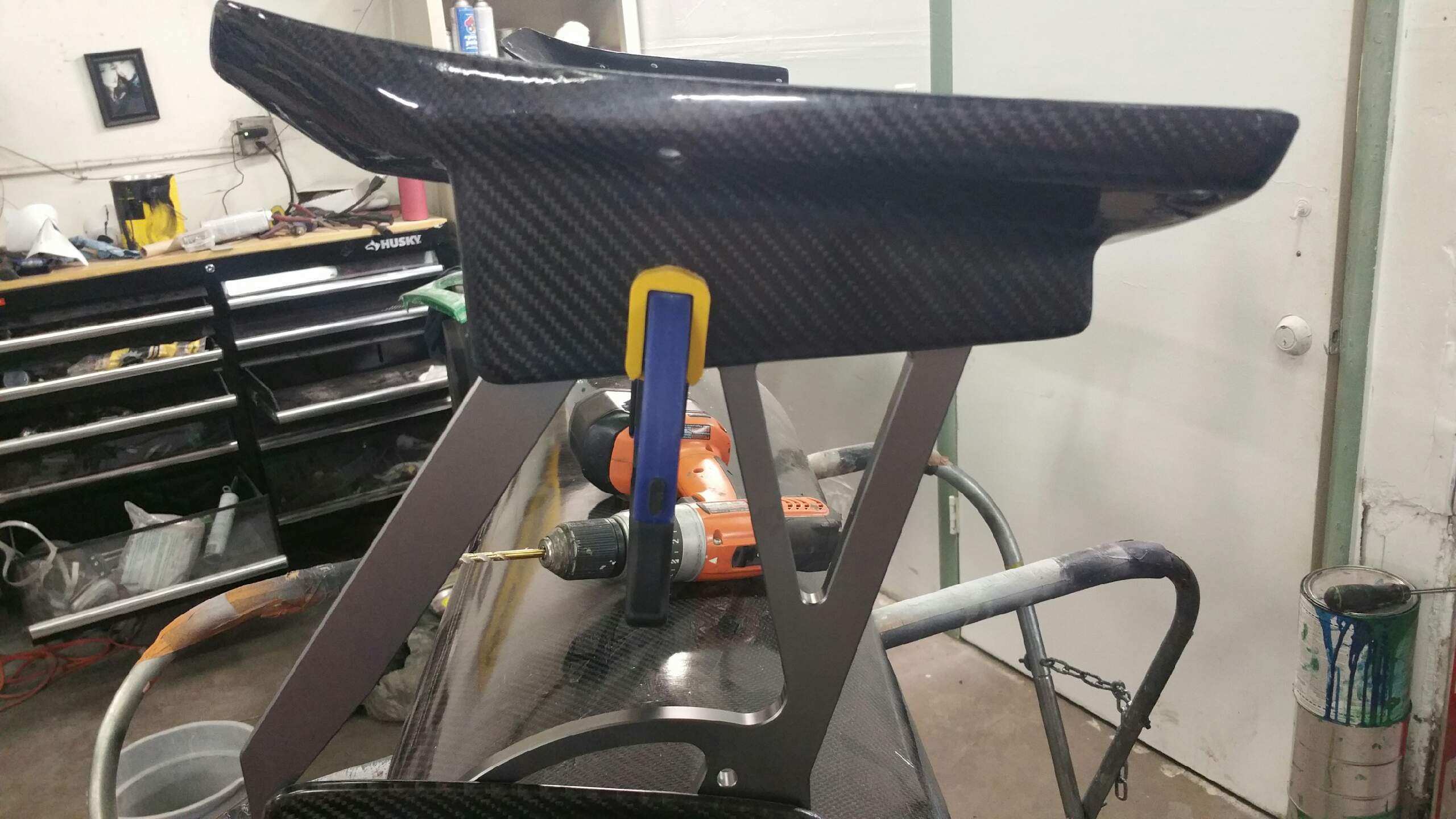

drilling holes for uprights..
feet had a bit of a gap exhibted.. some light scuffing and knock down fixed it though..

They did a good job. I would've been scared to attempt that on carbon fiber trunk.

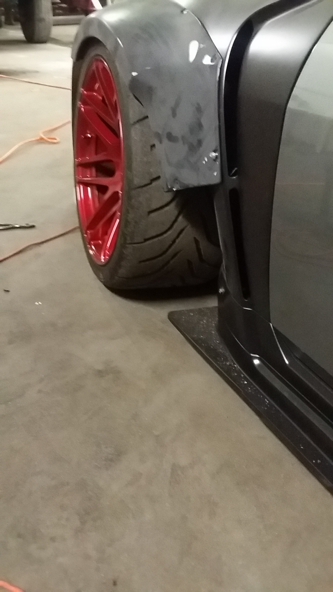

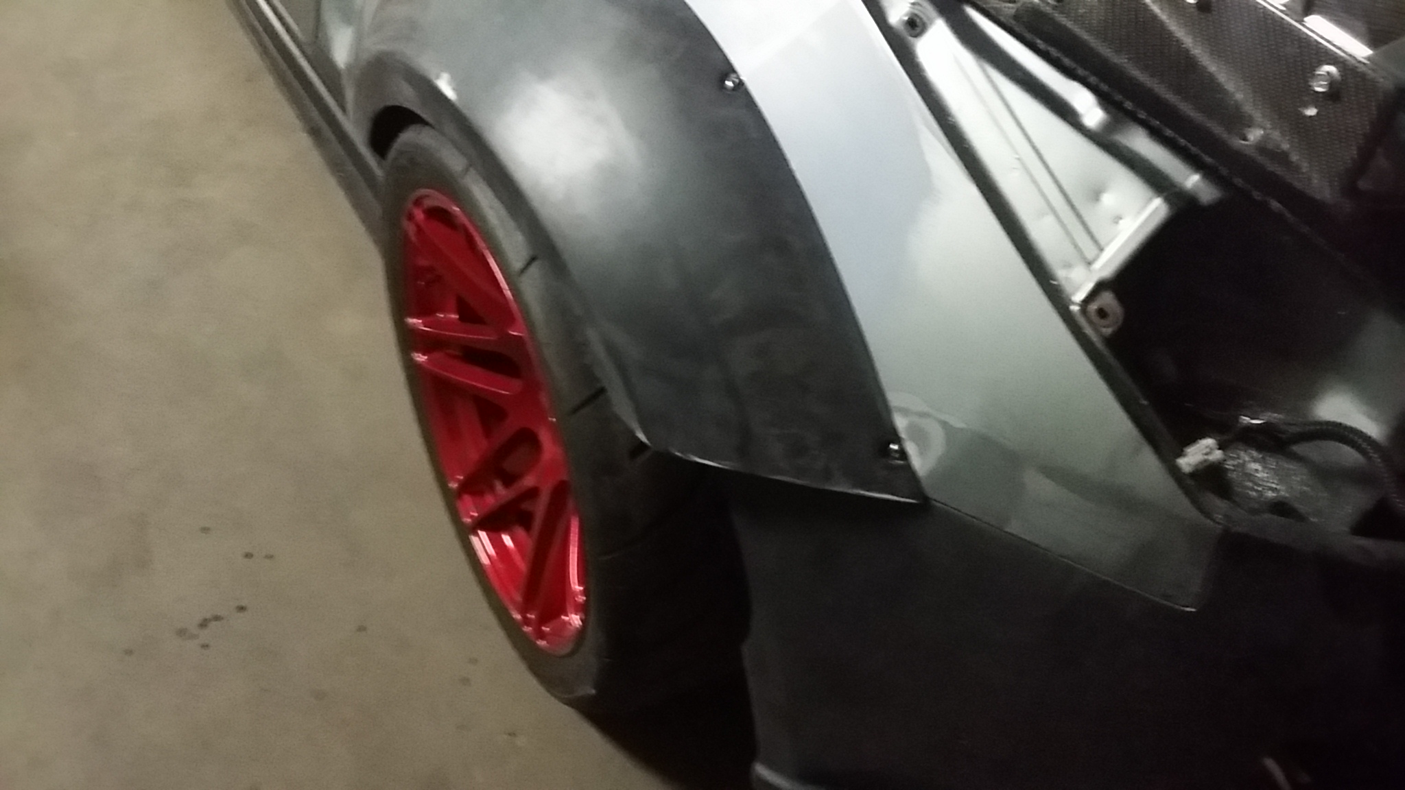

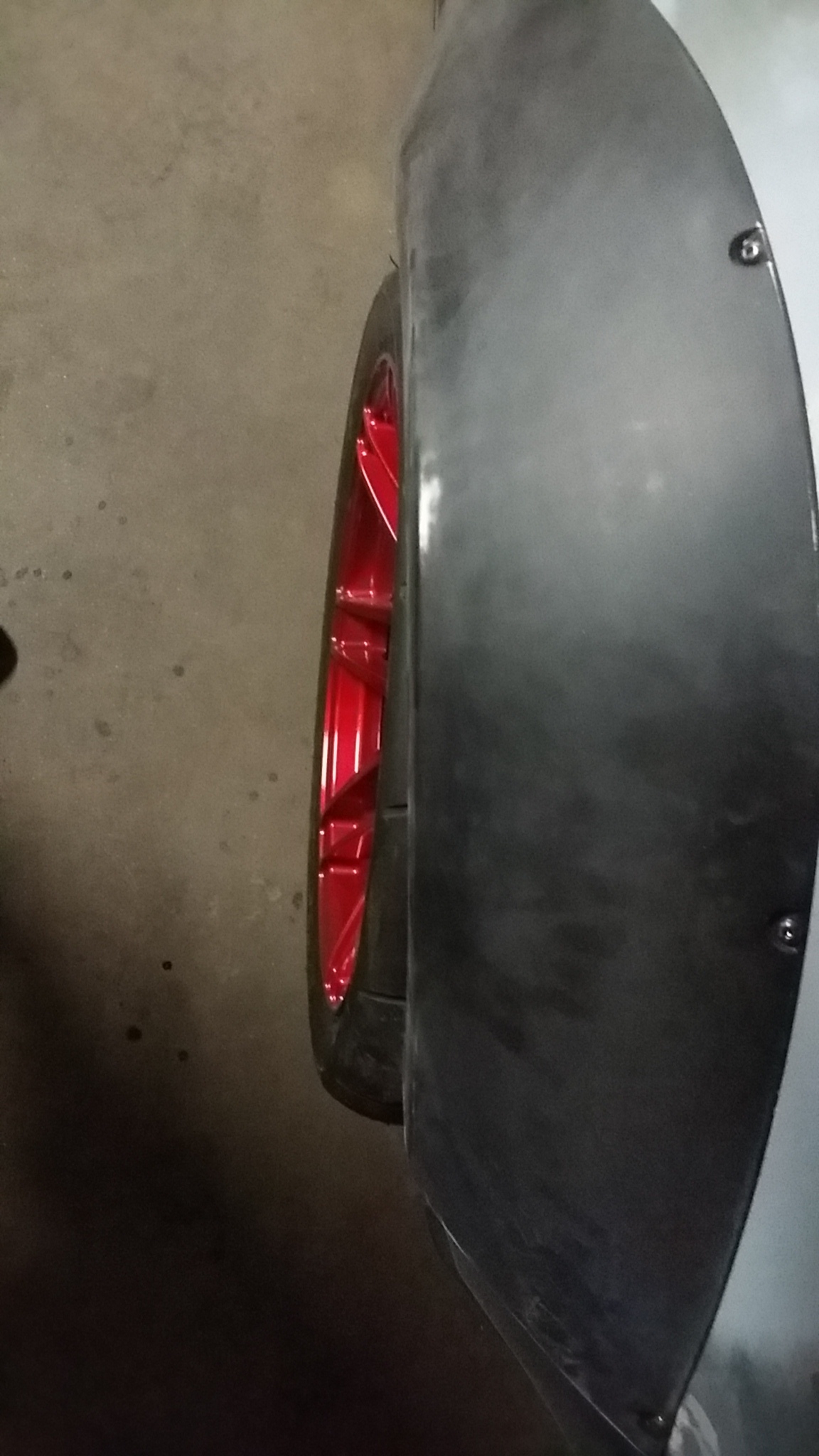

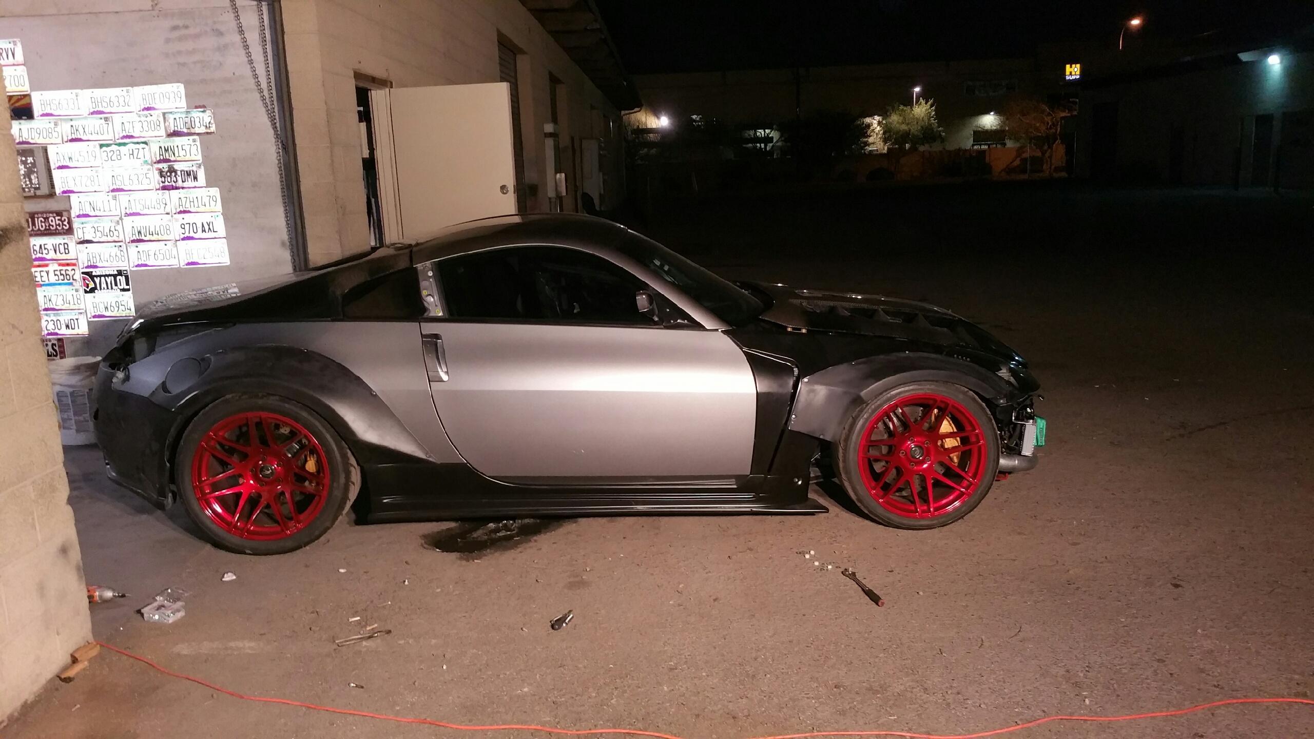

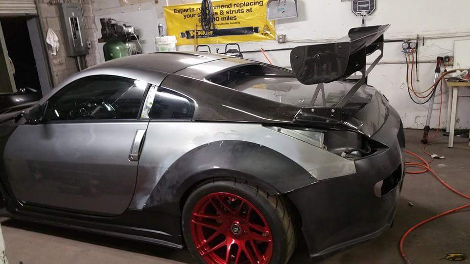

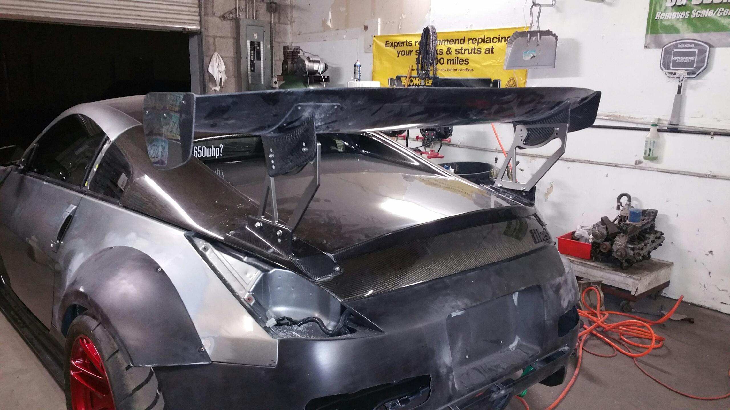

holy cr@p.. these back tires dont fit at ALL lol
the sidewall bubble is just terrible.. so no go on the 325s on an 11 inch wheel.. i should have known better and i kind of did.. was just in denial as long as i could be though lol.
It looks like "the veilside that wasnt" lol.. eff that.
So im going to run 295 square and call it a day. Fronts look great..
rear also has a toe in problem and is going to need some serious adjsutments to fit and look good, but thats the same w any car and wheel fitment.

so in the pics its a 295 front. why not run a 305 in the rear
Old Feb 24, 2015 | 01:41 PM
  #918
bmccann101's Avatar
bmccann101
Posts: 8,321
Likes: 467
see all of the above comments ^ lol.
its a shape limitation.
These flares arent built for meaty tire fit... and things look sunk w a big sidewall.. has to do with scrub clearance and other things. They were out of stock on 305 at the time i ordered, so this was just what i did in a pinch

...so you're going to a smaller tire on a flare that's already swallowing up a bigger tire?
Do you have a pic like 15-20 feet away of the rear "aired out"?
