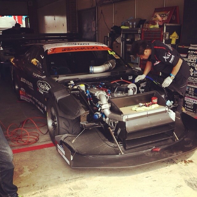

Here is a picture showing the front wing/splitter setup on the Scorch Racing S15. Take a very very very good look at how the end of the wing (end closest to the engine) curves up and notice just how long the cord of that wing is as well as how far back towards the engine it is. This car did a 52second lap around Tsukuba (Ludicrous speed) and doesn't seem to need any metal rods to hold the front of it's splitter up so that someone can stand on it.
Here's another 2 very fast TA cars (~55seconds at Tsukuba / stupid fast). They are the 2 Exceed Moat s14s and as you can see: huge splitter, no rods at edge to hold the front edge up, and I guarantee you that if you step on the front edge of them you will have some explaining to do to some pissed off japanese guys.
I don't mean to be a dick, but continue reading and learning as aerodynamics is in general pretty f-ing hard to get a good grasp on and spreading misinformation helps no one.
The s15 does indeed have rods connected to it. It may not connect directly to the splitter but it is connect. Also, the s14 could easily have support in the underside of it.
