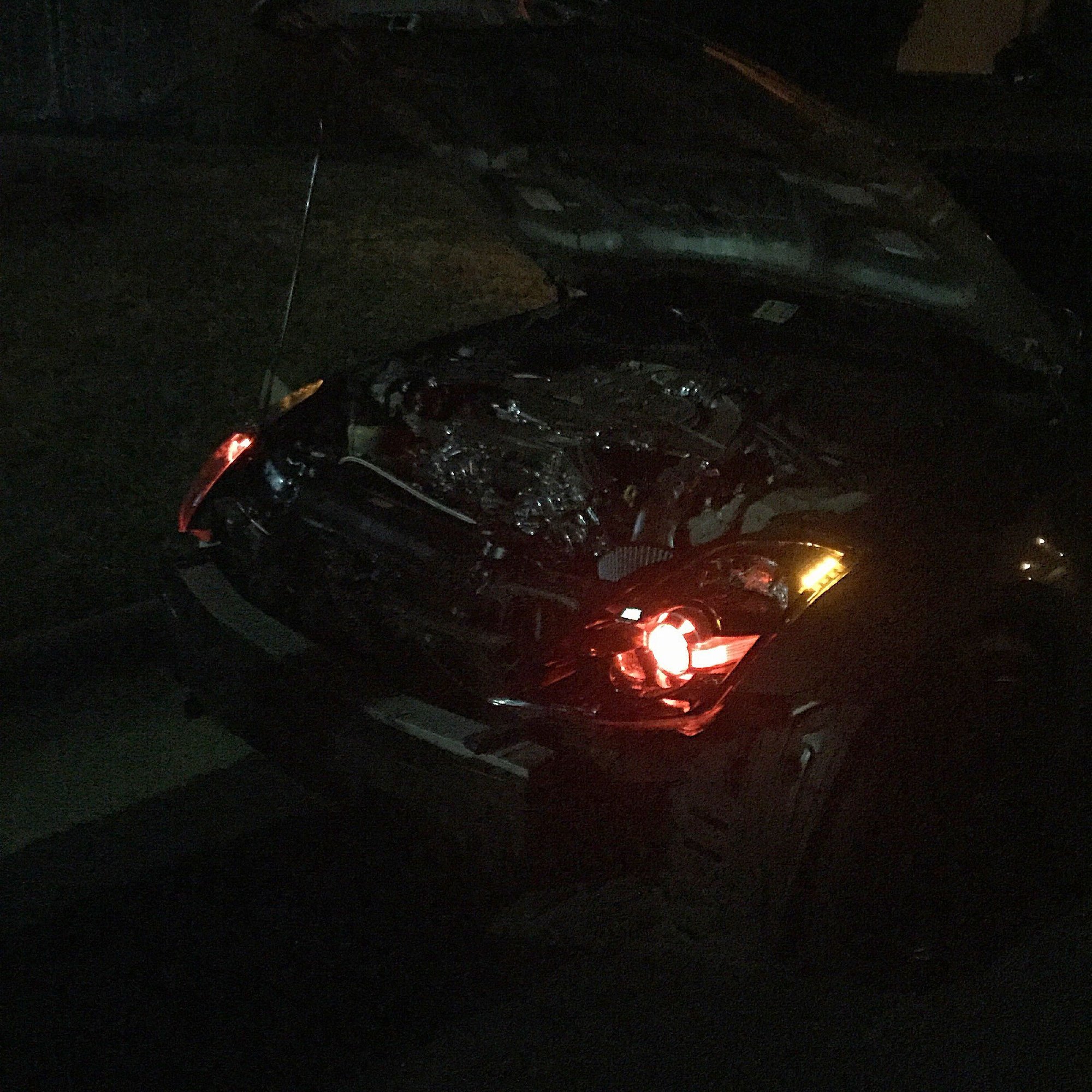

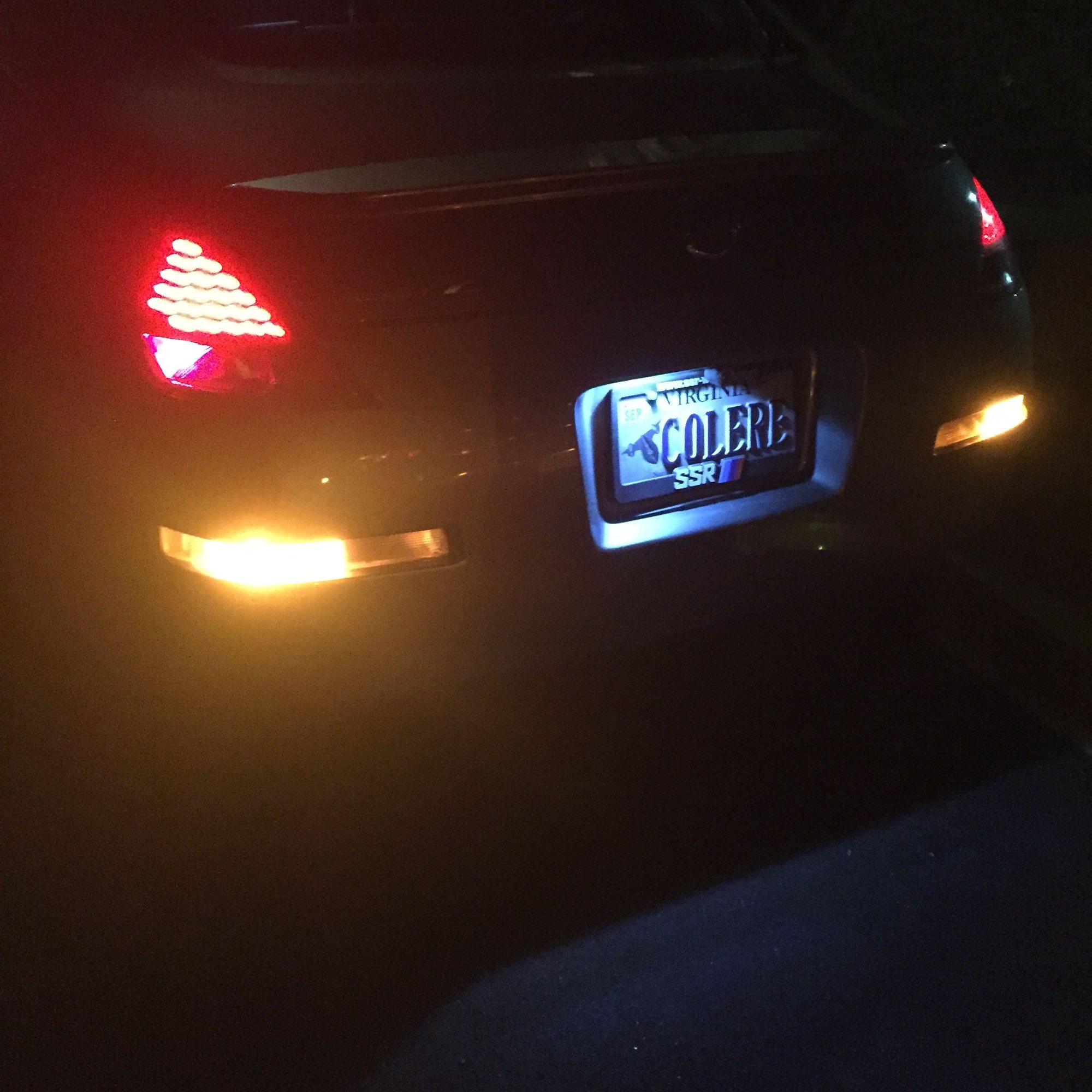

Question: I recently upgraded to the DEPO headlights. I have an 05 35th anniversary 350z. So I had to upgrade my bulbs to D2S and change my turn signal bulbs. After plugging everything back up, when I turn on my DRL and even with the low and high beams my rear blinkers stay on. When I use my turn signal it sounds like it's hyper linking but it won't blink. When I leave the lights off and cut on my turn signal, both blink as well as my tail lights as if I had my hazards on. Any insight would be great, thanks. SIDENOTE: I don't think this matters, but I also had the headlights modified before receiving them(demon eyes/iron man)
When lights are on
Top orange LEDs active??

Did you wired it right?

I'm pretty sure yes. Only thing I had to transfer from the old unit was the HID ballasts and the actual bulb cap.

Sounds like something isn't wired correctly. Who did the demon eyes? I just installed depo headlights on my Z and my neighbor did some as well at the same time, both are working flawlessly. I upgraded from an 04 with factory HIDs and had to notch my bulb housings, he upgraded from beat 2006 HID housings and was just a direct swap

Definitely a wire issue. Do the demon eyes just come on once you turn on the parking light. (BTW that is extremely illegal) I hope you have a switch for the demon eye and not hardwired into the parking light.

mine did the same thing. turned out my blinker bulbs weren't plugged in all the way. you have to really put some force on them lol. it might be something different for you though considering you have the demon eyes.

I have the same headlights and I cut the blue wire going to the turn signals. I think it was for daylight running lights.
