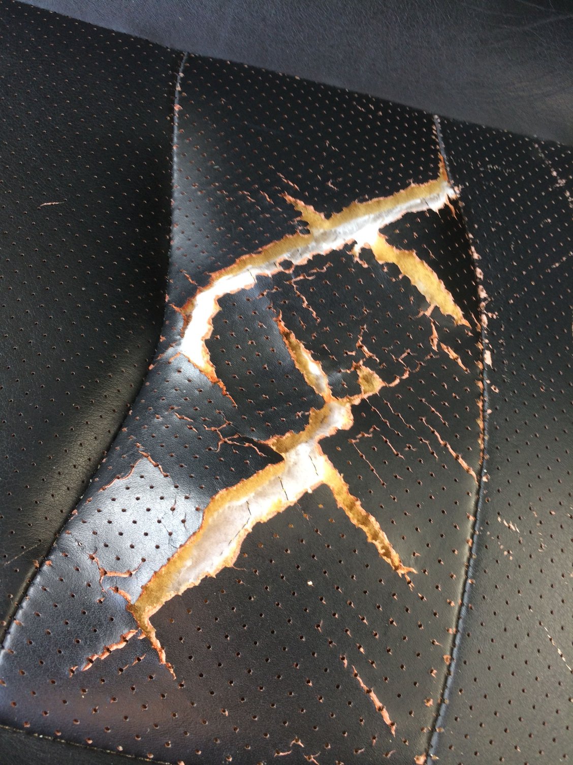

My 04 350z leather seats needs replacement. What’s a good and affordable fix? Thanks

You will def want to use a high quality conditioner at least once a year. Any leather becomes paperlike when it gets overly dry.

I am not sure if my solution repairing worn seats fits your budget, but here is a link describing recovering stock seats with a quality leather product.
https://my350z.com/forum/exterior-an...-orange-2.html

The problem you describe is based in the fact that so many car manufacturers and leather seat manufacturers us PU leather (Bicast leather).
https://en.wikipedia.org/wiki/Bicast_leather
This leather solution is prone to surface degeneration, as shown in your pictures.

If you have a fully-leather seat covering, you treat this with a leather conditioner. If you have a PU “leather” covering (Bicast leather in some definitions), a leather conditioner is not enough. You need to treat the surface with a dual treatment product that provides both leather and vinyl treatment. PU ( leather) is prone to cracking if not treated with a vinyl and leather conditioning product.
