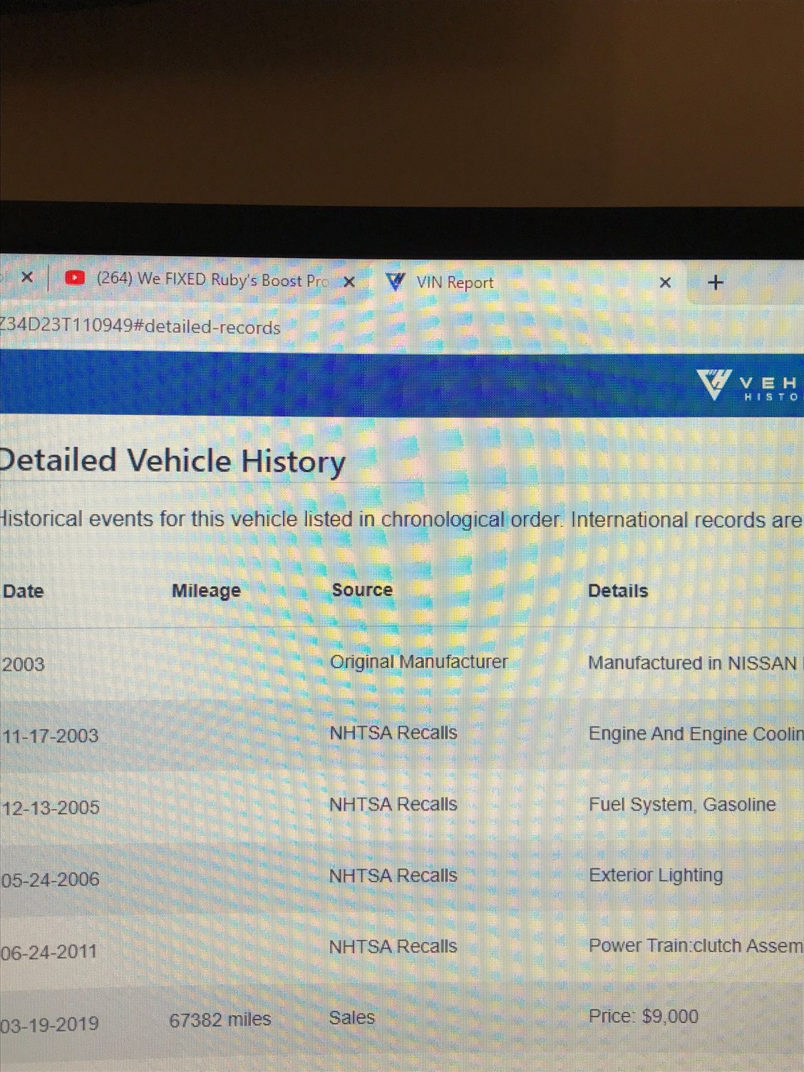

Unfortunately it did not come with service records. I took a look at the rear diff bushing and since it wasn’t leaking, I assumed the car has been taken pretty well care of. That and all of the other fluids look really good. I will be swapping trans fluid to hopefully “bandaid” the crippled 3rd gear, and it’s horrible grind.
little update, my friend today wasn’t paying attention and the wind took and slammed the door shut, and immediately both windows went up, and stayed up and now all of them work like normal. It’s the weirdest thing guys haha
This is all I could find on the vin about service, not much
