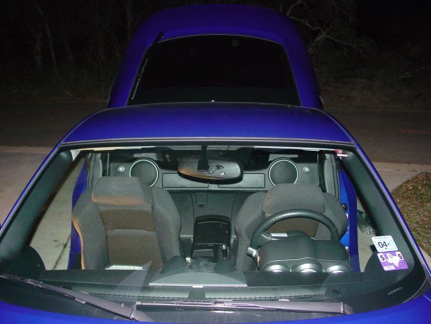

Yes it does sound much better ehhh. I did mine about a month ago. reference series components front and back.

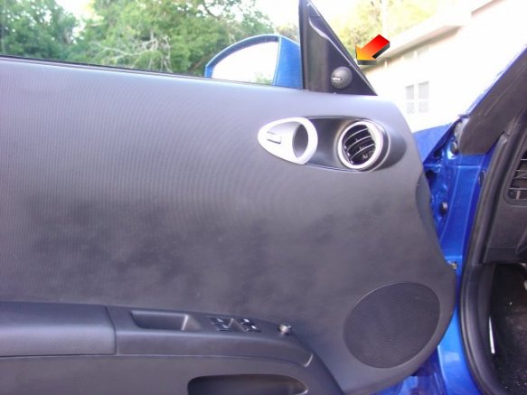

call me crazy but is that a tweeter I saw behind the driver seat?

Sure is, i'm running components front and rear.

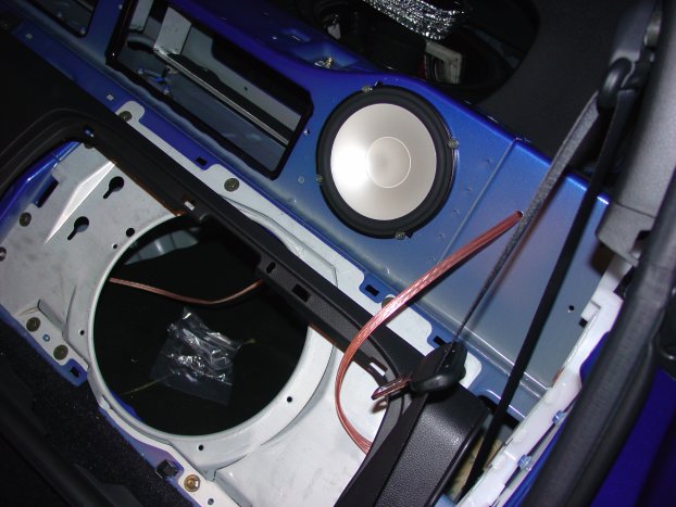

Well I put the front crossovers in the door - velcro'd them on the inside. I did the same with the rear - just put them on the back of the metal inside the speaker hole - plenty of room. I ran new wiring for all of my speakers... I left stock wiring alone. Ran wire through the center console to get to the rear and ran the fronts throught the rubber gomets into the doors. And yes I replaced the stock tweters with infinity tweeters.

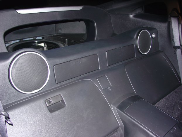

the rear
