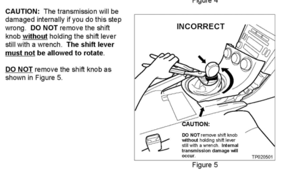

http://www.provtech.co.uk/350z/Nissan_TSB_MT02-004.pdf
there is the link to the pdf which holds the correct way to remove the shift ****. It has some nice diagrams as well!

here is what i was talking about...

OK - I found the answer. This info. is in a technical service bulletin.
Whole bulletin can be found here:
http://www.350zgt.com/forums/index.php?showtopic=63

Did you guys apply any threadblocker to the shift lever?
THE TSB mentions applying a High Temperature High Strength Threadblocker Red to the threads of the shift lever.

ISH - up to you. Threak lock will make sure shift **** doesn't work loose and is part of the official procedure. In my case, it was tight enough to stay put and I decided to leave it out to make life easier if I do other changes.
As it happens, I subsequently changed to a Nismo shift **** so glad I left thread lock off.

Ohmygod, i can't even get the friggin shift **** off, and i'm scratching it!!! I'm turning to the left. It turns reluctantly but doesn't loosen. Pls help!!!

SERVICE MANUAL SAYS NOT TO REMOVE **** THIS WAY, THAT IT WILL DAMAGE TRANSMISSION!!!!!!!!!!!!!!!!!!!!!!!!!!!!!!!!!!!!!!!!!!!!!!!! !!!!!!!!!!!!!!!!!!!!!!!!!!!!!!!!!!!!!!!!!!!!!!!!!!!!!!!!!!!! !!!!!!!!!!!!!!!!!!!!!!!!!!!!!!!!!!!!!!!!!!!!!!!!!!!!!!!!!!!! !!!!!!!!THIS PAGE NEEDS TO BE PULLED!!!!!!!!!!!!!!!!!!!!!!!!!!!!!!!!!!!!!!!!!!!!!!!!!!!!!! !!!!!!!!!!!!!!!!!!!!!!!!!!!!!!!!!!!!!!!!!!!!!!!!!!IF MY TRANSMISSION IS ****ED UP, THERE WILL BE HELL TO PAY!!!!!!!!!!!!!!!!!!!!!!!!!!!!!!!!!!!!!!!!!!!!!!!!!!!!!!!!! !!!!!!!!!!!!!!!!!!!!!!!!!!!!!!!!!!!!!!!!!!!!!!!!!!!!!!!!!!!! !!!!!!!!!!!!!!!!!!!!!!!!!!!!!

Whew! Used the tsb to remove the shift **** properly. The radiator hose stopped further damage to the bottom edge of the ****. Used a black magic marker around the bottom of the **** to hide the scratches caused by trying to used a towel to remove it. Problem solved. My bright-orange boot is installed. Matching seats and steering wheel leather next!
