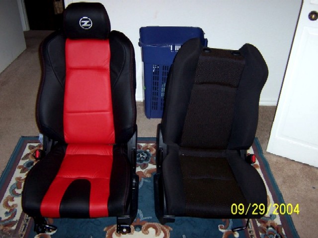

Orderred them through leatherseats.com
Awesome quality
check them out
before/after

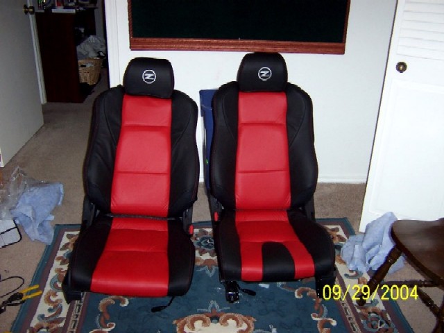

after 5 hours of tugging leather both were done

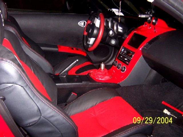

here they are in the car

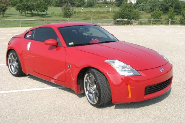

picture of the car they are in ( my baby )

how easy was the installation? Does it work with side airbags?

serisously, dag man you should of taken pics of DIY.
looks great though, fill us in on the install, if its something that is possible to do on our own, i'm going to order new seats tomorrow.

It definately takes two people to do the install. Lots of tugging and pulling. It doen not come with instructions. The headrests are just covers. You pull the leather right over the headrests. As for the seats, you need to remove them from the car completely.
Then you have to remove the cloth on both seats (back and seat). There are many clips you have to pull out that hold the cloth.
I started with the driver's seat. Did the bottom first. Make sure you order the installation kit (YOU WILL NEED IT!!!). You have to crimp it together just like you pulled it off. It startes out slow but then goes faster once you get the first few in.
It works with airbags, I have them in mine. Just specify it when you order. A good write up can be found on this website:
http://www.**********.com/forums/portal.php?pg=FP001
It took me and a friend roughly 5 hours, but the result is wrth it. We did stop and eat inbetween seats though.

look great. its a fun install, took me and my buddy about 6 hrs and a lot of beer to get it done.

Man those seats look wild. You got any pictures under the hood, I'd like to see what the stainless bolt kits looks like.

I like the seats but inside oMG Thats 2 much red for me!!
