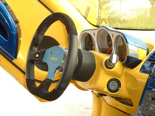

I searched for 3 weeks before I found a company in California who had one. Now I can't remember the companies name! doh! lol.
Anyway, I found this one and it will work for sparco and momo steering wheels. This is the exact price I paid for mine. I'm sure this one is imported from Japan, therefore the air bag kill connector will not match up. You'll either have to make your own adapter, remove the light, or just put up with a flashing air bag light.
http://www.sp-power.com/catalog/prod...oducts_id=3008
Good luck!
Here's a pic of mine.
Oh yea, don't forget to sell your drivers side air bag and clock spring. That should pay for your new steering wheel and hub, and a quick disconnect if you want. (at least $400 for the air bag and $150 for the clockspring)
