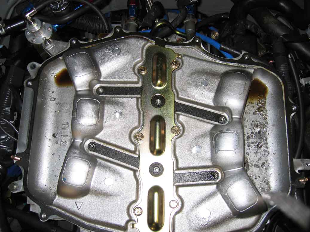

Default plenum off
so far here's what I see...
Attached Thumbnails 04 G35 Twin Turbo BLOWN stock boost-copy-of-img_1662.jpg

Default Re: plenum off
Are those metal shavings and pieces on top of the lower plenum? Doesn't look to good?

Default Re: Re: plenum off
had metal shavings in my plenum too ernie!!!
Yep
Yikes

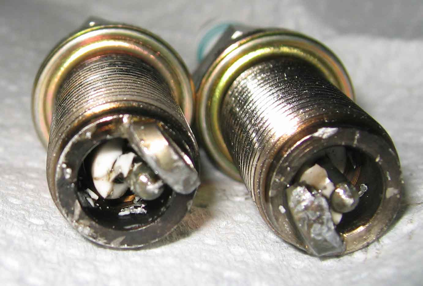

2 plugs were messed up, 3 OK and 1 still stuck in there
