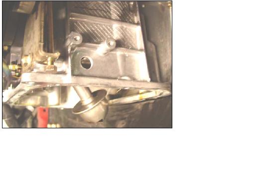

While I most certainly agree that oil starvation could in fact be a cause of the failures seen I do see some discrepencies that I would like to point out. First off it was mentioned that there exists a possibility of oil running away from the pickup during acceleration. Based on what I have seen in regards to the location of the pickup I find that hard to believe. Attatched is a picture of the stock oil pick up with the lower pan removed. As you can see the oil pickup is angeld to the back of the car. This is the only place if any that the oil would "run" during accelartion. This in and of itself should alleviate the theory on oil starvation during acceleration. Furthermore should oil starvation be my concern it would be more concerning during cornering when the oil could slosh away from the pickup. Unfortunately on neither pan I have seen available is there I believe suffcient baffling for side to side slosh. Yes the baffling is there and should help some but from the looks of the primary baffles it is more intended to prevent front to back slosh.
Now I know I have been branded as an APS hater. And I will agree to an extent I do have my questions as to the motives in which they have when they post. For example their deep care and regard for the community in bringing to light the CAS wire issue. Although it did seem rather intriguing that it was only brought up by phunk and that even he was asked not to disclose it by APS. (I do not have proof as the thread has since been deleted although some may remember the post). My ultimate point is that like others have said everyone needs to make an informed decision prior to going F/I. However I must say that the statements constantly stressing a well baflled oil pan (with gratuitous plugs to the APS pan) focusing on even straight line acceraltion are IMHO overblown. Yes I believe its an issue. No I don't think its an issue during regualr acceleration and honeslty unless you are running a road course I do not believe it is as serious an issue as tuning and timing. I myself am working with another board member to design our own pan based on a stock pan with baffling welded on by him. I will be coupling this with an JWT pan spacer for added volume. No I am not plugging this and it is entirely possible this will be the only one ever built. I did not like the way the baffling was designed on the other pans as I said it looks as though by design or by general space restrictions they were designed primarily to prevent front to back slosh. Being that I do plan to track my car side to side is a far more serious issue for me. I will have a front to back baffle but the majority is designed to prevent side to side... Enough retoric from me... Oh and here is pic of the stock pickup. Note the angle it has pointing to the rear of the car. This should allevaite the percieved issue of oil "running" from the pick up tube under acceleration..
Not to totally punch a hole in your argument , but the additional "side to side" capacity added by the APS pan design should guard against lateral starvation considerably. That extra ~1/2qt per side has to go somewere during a cornering event. The result is deeper oil around the pickup area during lateral and fore/aft Gs..
Actually you didn't my main argument was that you did not need a baffled oil pan to prevent against slosh front to back during acceleration due to the angle of the pick up tube. The reason I am welding side to side baffles in the oil pan I am using is that it is a stock lower pan. Because my setup is simply increasing volume vertically it will not have the same effect as their pan does, not that their pans baffles actaully decrease the slosh as the increased amount of oil is the principle reason for the negated starvation efect. It is not becuase their baffles are helping in side to side slosh but rather that the increased oil capacity provids more oil thus somewhat reducing the possible effect
Not sure why you find this issue difficult to understand, if you look closely at the oil pickup it's located at the front of the engine, given the stock oil pan has no baffling if you accelerate quickly which direction do you feel the oil is going to travel? The answer is very obvious.
I don't follow your logic, where the oil runs to under accellartion had zero to do with the angle of the main oil pick up................if the oil runs away fom the pickup in any direction the engine may well be starved of vital engine oil supply and lead to premature engine damage.

One other thing to consider is the exact height of the pickup. When you remove the lower oil pan, the pickup is clearly visble and is actually at the same height as the bottom of the upper oil pan. The stock oil pan holds barely any oil....my guess is slightly more than 1 qt. The vast majority of the oil is located in the UPPER oil pan, which is the location of the pickup. So it seems highly unlikely that that pickup would EVER be exposed to something other than OIL.....unless the oil level was horribly low. In which case...nothing would save you.
Again, I'd like to say that I like the concept of a baffled and increased volume oil pan...and the APS unit is very nice. I am probably putting one on my car...as soon as I can find one in stock!
But I really dont think the oil pan has any bearing on oil starvation. My bearings showed little signs of wear and tear after 14000 miles of 8.5psi of boost. And I beat the crap out of my car...certainly didnt babe it. I did 10 or more 1/4 mile passes, and one road coarse track day.
