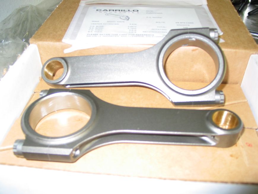

the 1st pic is H-beam Carrillo rod.
this picture of mine confirms that.
