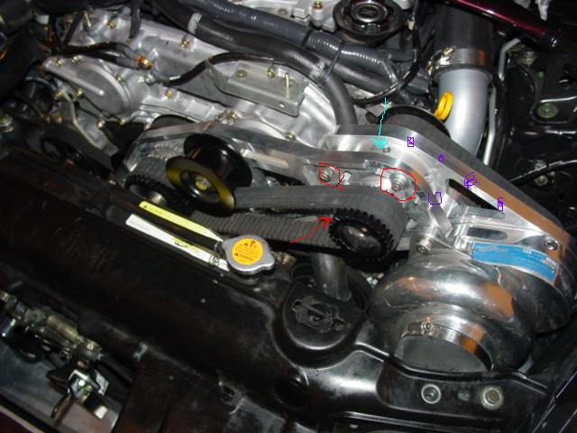

I got the new belt from ATI (just a little bit of a mark up on the $95 price!) and I had a TWO HOUR ORDEAL getting the damn thing on.
No matter what I did, I couldn't get that sucker to slip on there. You have to loosen these little hex head things and rotate this wheel to bring the two pulleys you are working with, colser together. You rotate the wheel toward the passenger side if you are putting the front (longer) belt on and toward the driver's side to install the blower belt. You have to stick a screwdriver or some other sturdy metal object into this hole on the wheel in order to turn it.
Mine wouldn't turn far enough! I had it as far as it goes (while still leaving the three hex head in) and no deal. I then took them off completely (not just loosened) and tried to turn it more to get me another fraction of a millimeter. Still nothing.
I tried heating the belt up but these things are so strong and thick that you can't really stretch them. I decided to try and remove my pulley to see if that would help and that baby was STUCK on there. I did manage to get it to move backward a little which aligned the belt a little straighter but I still couldn't get it.
Finally, I tried to turn the wheel even more (now burying the holes where the three hex head screws normally go) To do this I had to insert an Allen wrench into the hole and pound it with a hammer to get it to turn a bit more. FINALLY, I got the belt on.
This was only after dinging up my blower bracket a bit (not to mention my hands too!) and breaking a screwdriver and two Allen wrenches!
Then I had to get it to turn BACK so I could re-insert the three hex head screws! NOT FUN!
Anyway, I finally did get it all back to where I needed it and I am once again SUPERCHARGED!
Funny thing is that it seems like I get a little less belt squeal now!
I was all ready to go when the guy who was going to paint my front lip and my driver's side, side skirt says he was coming to pick them up. They are now off the car and getting repainted (had some curb rash and a nasty scrape on the lip). So the Z remains in my garage.
Can't wait to break it out!

This pic will explain what I was talking about.
The red circles show the two hex head screws and the red arrow shows where the third one is (can't see it in this pic)
The greenish arrow shows the hole in the "wheel" thing you have to stick the Allen wrench into to turn it and get your pulleys closer together.
The purple splotches are where I dinged up the bracket.

Forgive me if this has been addressed before, but I noticed that your routing on the belt seems different than the other Prochargers that I have seen, including mine. Shouldn't the belt go on top of the idler pulley? Was this intentional? any benefit to your routing? Do you think that had anything to do with your belt failing? Just an observation.

This has been brought up before. My belt goes under the pully, if I remember right. The idler pully is not cogged, so it doesn't really matter one way or the other, as ong as the belt is tight. I would tend to believe that running the teeth of the belt over the smooth tensioner would eventually wear the teeth out, or damage the smooth pully over time.
