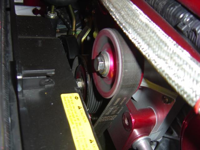

I have had the Stillen Stage II for 2 months and been somewhat pleased... I ordered the Red pully and they told me to use the same belt, but this pully is bigger than the other one and the belt won't fit! Also, its a 6 rib pully and the lower pully is only 4 ribs.... What am I missing here or did they ship the wrong pully... I was hoping to increase boost so shouldn't the red pully be smaller in circumfrence than the original black one??????? I don't know what to do?????

this is the one you are replacing, right? (mine is powdercoated so dont let the color throw you off). It should be larger than the old one, but have the same number of ribs. I think you are thinking that the new pulley goes on the supercharger, but it goes on the lower pulley assembly.

Jesus Christ! No wonder! I put it on the S/C... I am a so damn dumb! I wondered what was going on..... at least i put it back like it was till i got an answer.....

I ordered the pully that is red and it cost like 89 dolllars and is supposed to increase the Stillen Stage II to a Stage III and give me 7lbs of Boost. Is this pully located below the S/C on the motor and use the same belt as the one that turns the S/C pully? Maybe I should shoot myself.....LoL....

OK now i get it after reading the post again, I am putting it on the lower part and it uses a 6 rib belt, not the top belt that is 4 ribs..... Jeez...wtf was I thinking.........
