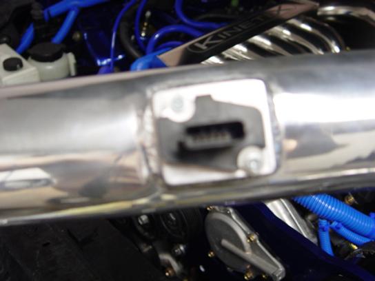

I made one it cost me about 90.00 to make.
Attached Thumbnails one piece Vortech MAF pipe..what happened to it-copy-of-picture-1195.jpg

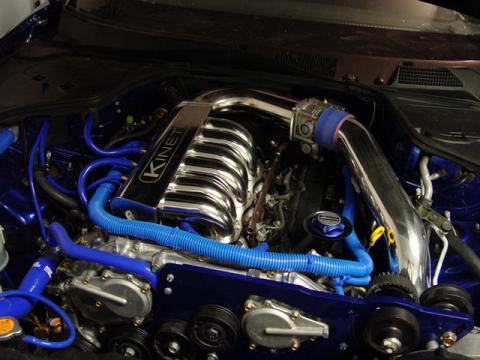

Yes Injen made one for Randy but I guess they dropped it. I wanted one so I just bought the pipe and cut it and had it welded. The hardest part was the part for the MAF sensor. That took me about two hours to make. If you want Ill dig up the links from where I got the pipe.

Heres the pipe I bought
http://cgi.ebay.com/ebaymotors/ws/eB...category=33742
As for the MAF sensor I bought a piece of Aluminum 1/4 thick two in wide and made the plate. I sanded down the welds and polished the pipe out.
Attached Thumbnails one piece Vortech MAF pipe..what happened to it-picture-1139.jpg   one piece Vortech MAF pipe..what happened to it-picture-1135.jpg

So you used the [ 2 ] 45 degree pipes for the two bends and a straight pipe with the plate for the MAF sensor welded into it ..looks great...thanks
