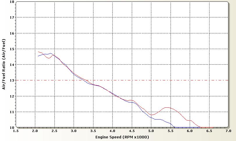

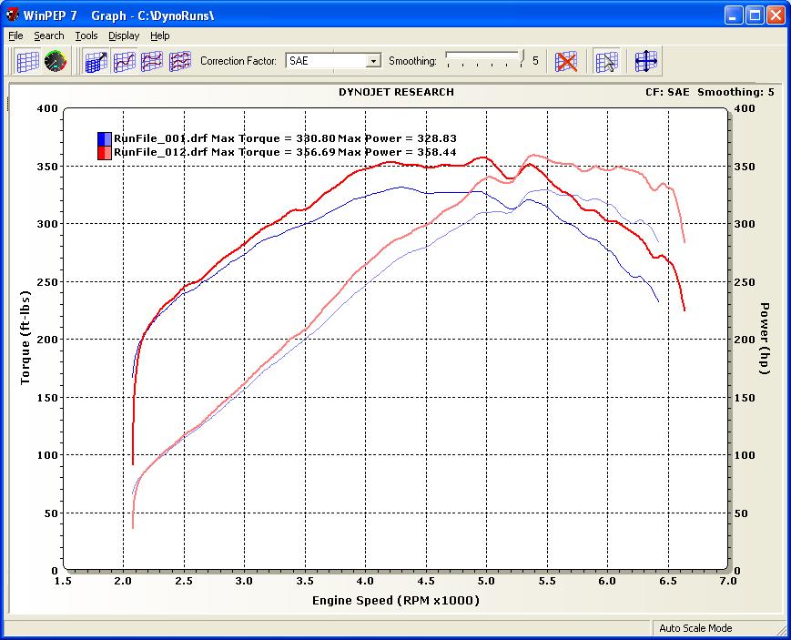

Here are the graphs...
CRAPPY A/F I know...

No wonder the afr on that graph is so rich, if you're running a stock exhaust the boost pressure (mass air flow) will be much lower than expected, low mass air flow at high rpm guarantees a richer than expected AFR.
