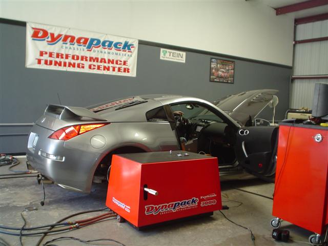

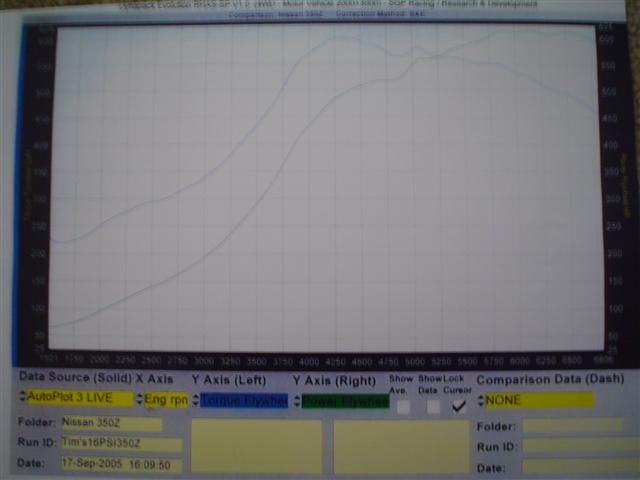

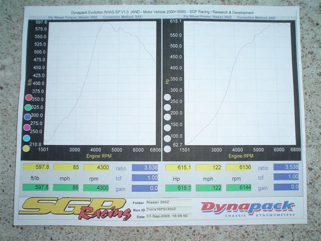

Default One More Try on the Pics
OK, the image quality sucks, but you get the idea.
Attached Thumbnails 615whp... On Pump Gas!!-350z-007-small-.jpg   615whp... On Pump Gas!!-350z-014-small-.jpg   615whp... On Pump Gas!!-350z-002-small-.jpg

You'll notice the second graph is easier to read. The car made power all the way to 6500 rpm's. We had it goint to 6200, but it was still making power, so we went to 6800. With the new exhaust, it should make power all the way to 7000 rpms.
