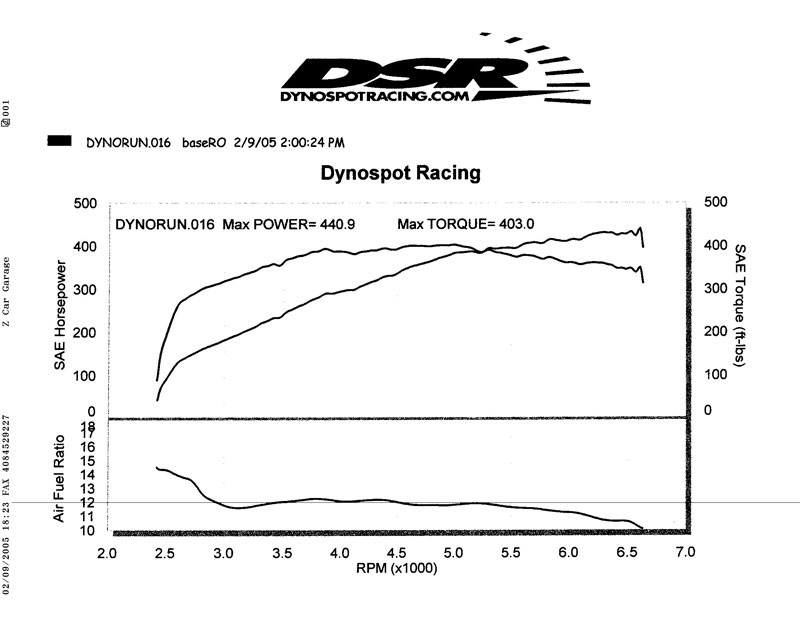

Vortech doesn't have the same software like the Greddy or APS which i know you are aware of. I've heard its more difficult to dial in. Here's an example of another "crappy" dyno.

Attached Thumbnails Who says Vortech can't make big power - Part 2-440-to-the-wheels.jpg
A/F looks ok on this tune. Well, pig rich up top, but much, much better than the other graph posted.
