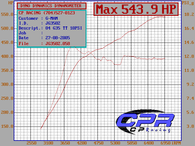

I have the greddy profec b II and greddy turbo timer. I am probably going to switch the profec for an HKS EVC. At my boost level the profec does not hold the boost steady. Here's my boost chart.
Attached Thumbnails What boost controllers and turbo timers do u guys recommened-dynoboost.gif

The e01 is better at holding boost than the bII as it has settings you can play with the increase boost at selected rpm's.
