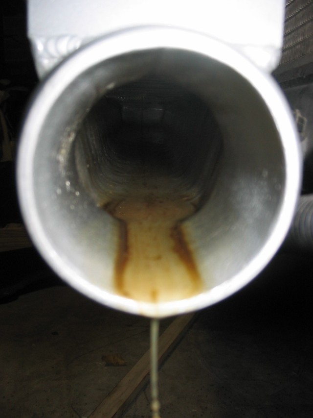

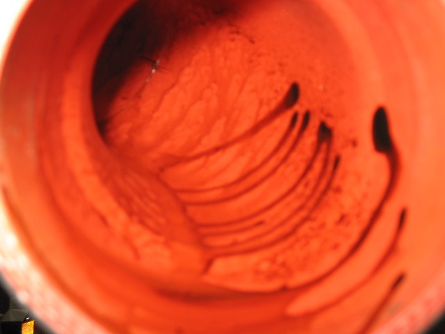

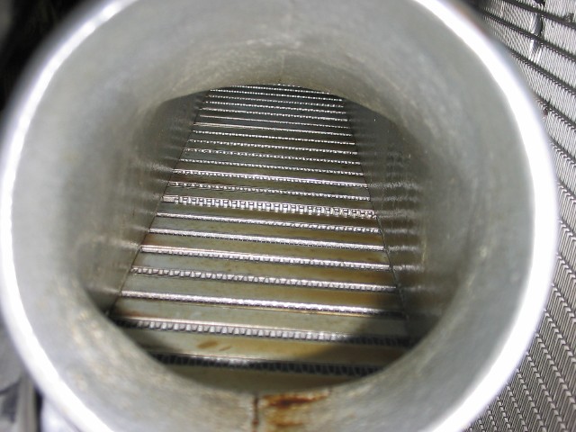

this is what i found in my IC today. lots of oil. i sprayed degreaser in it and let it sit for a while then washed it out with a lot of water. im gonna crank it tomorrow without the intake pipe connected and blow the rest out.

i cleaned the entire system then filled the intercooler with degreaser and sprayed it out. there was also oil all over the maf. thats what that last pic is, the watered down oil.
