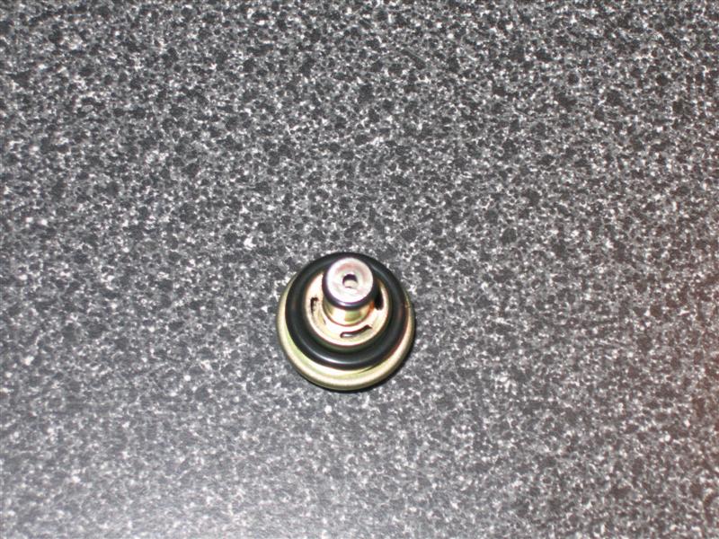

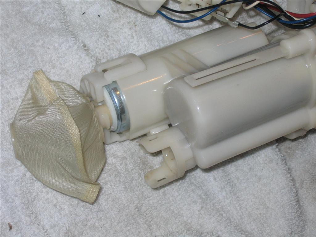

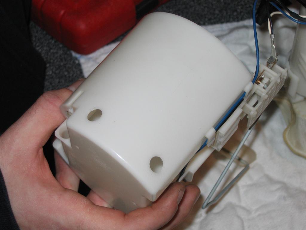

Originally Posted by Vadian
Take some pics of the install!
Ask and you shall receive
First pic is the fuel pump assembly out of the car and a shot of the Walbro pump sitting inside the assembly.
Second pic is the fuel pump assembly with the 2 3/8" holes you need to drill
Third pic is the fuel regulator orifice after being drilled out to 7/64"
All these steps were simple....

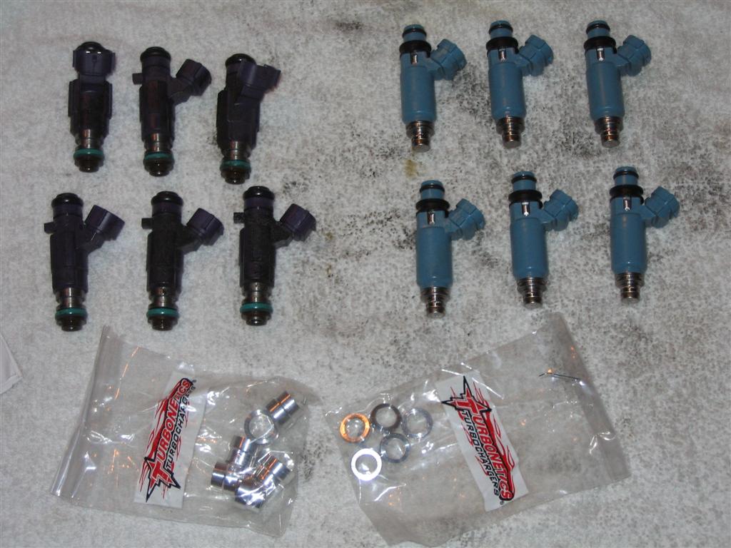

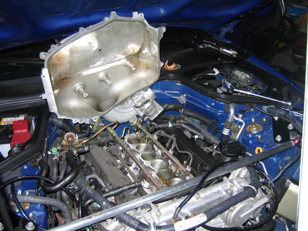

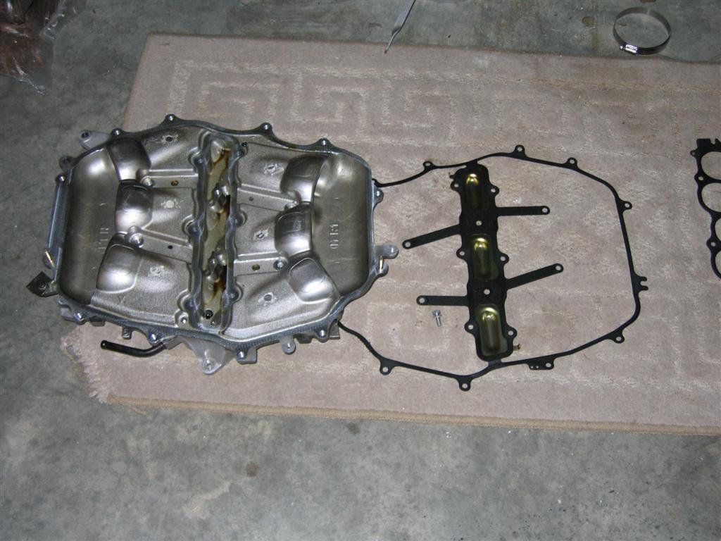

Thumbs up
Some more pics-
Close up of lower plenum, an under hood shot with no plenums on before taking fuel rails out, and a shot of the stock injectors (black) and TN injectors before moving the bottom o-rings around and adding the injector spacer to the top of the TN injectors....

what are the two holes drilled in the fuel pump assembly for?
Old Dec 28, 2005 | 07:08 PM
Alberto's Avatar
Alberto
Cranky FI Owner
Posts: 34,715
From: DMV
Not sure but it tells you to do that. Maybe when the fuel gets low the holes will allow the pump to pick up gas easier?
