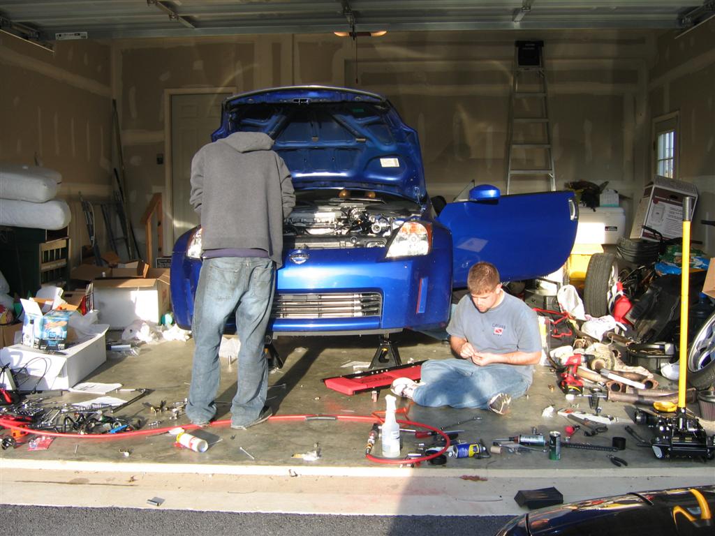

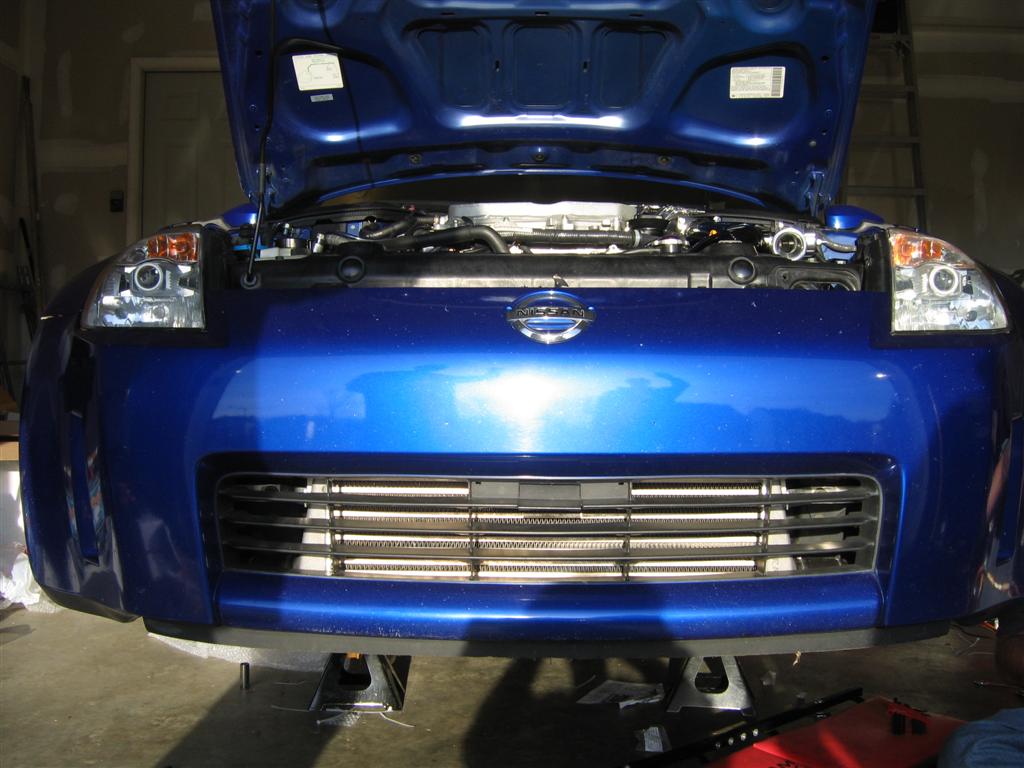

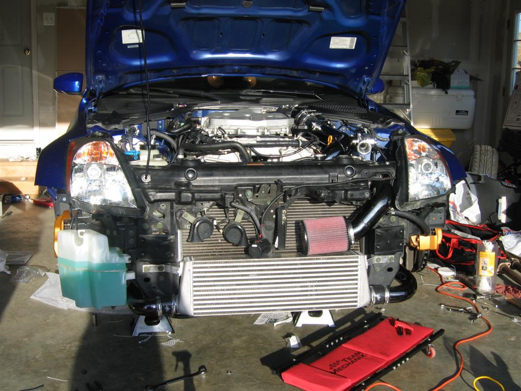

Here are 2 quick pics-Ill post some underhhod shots, fuel tap, and guage pics later. First pic everything is done but the fuel tap, and putting front end back on, second pic is myself and a friend finishing the install putting the front end back on. Third is self explanitory You can kinda see the mess of parts/tools everywhere....
