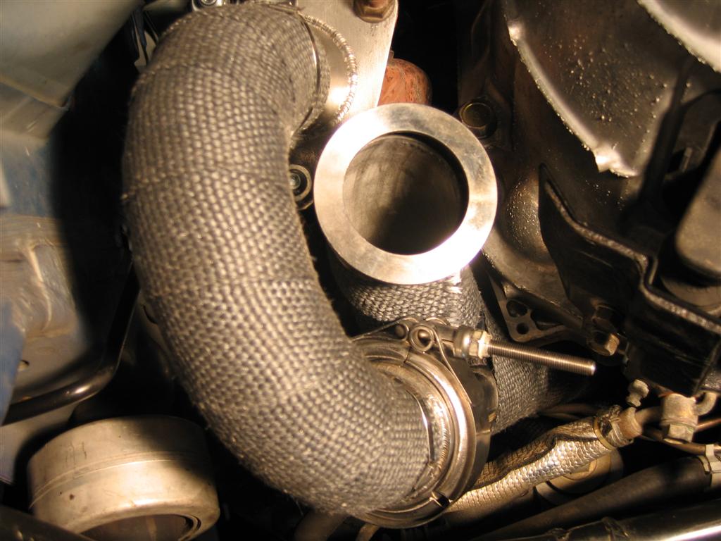

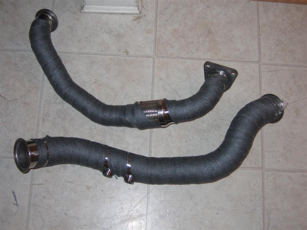

Ok well worked for a long time on the install today, got a lot done. First off let me mention some things that I thought were a pain in the d!ck that I hadnt heard mentioned before.
The 9/16" drill bit for the oil return tap, most standard 10mm chuck drills wont hold a bit that large, cuz that drill bit has a 13mm chuck, so I had to go to Home Depot and rent a drill that could barely hold it in. The weak bracket holding the a/c line you have to push out of the way sucks my b@lls because you reuse the factory bolt that holds the dipstick guide-which is a little on the short side after adding the bracket. We messed with that for almost 1 hour with no success so I finally said screw the guide and put the bracket in without it. The 1 hex bolt on the exhaust side o fthe turbo connected to the bracket connected to the ac compressor is retarded too, would be much easier if it was a regualr bolt head instead of a hex. And the worst part of all-THE WASTEGATE. What a PITA, it is very difficult to install the top bolts coming through the discharge pipe down into the wastegate. If you know a midget, call him over and have him put his little hands up there to put the bolts through, it was very difficult. We ended up running mad extensions from above with swivels to tighten those
Other than those headaches it was cool, oh and I wasnt thinking and cut the oil return to specs but my oil return is in the pan spacer so I shouldnt have cut that line because now it wont reach, so Ill replace it with longer hose tomorrow. All we have to do is mount that back down pipe which will take 2 minutes, and run the IC piping.

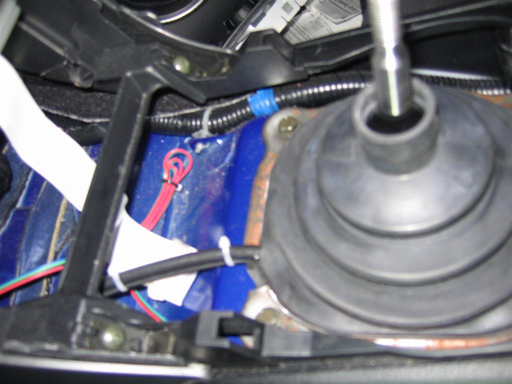

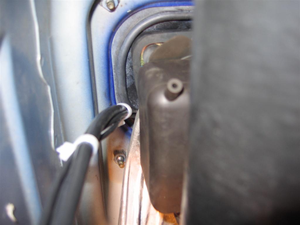

I had a friend that likes to do electrical start the Fuel pressure guage and Innovate wideband install. The FP was np problem Im runnign that to an SPT fuel line tap.I had heard the wideband wouldnt reach but I figured out a way. I had a friend run the wires down through the shifter assembly right down to the center of the car where the extra bung will go, no need for lengthening or drilling the floorboard which Ive also heard. Other than the pipes go together pretty smoothly, and we heat wrapped what we could.

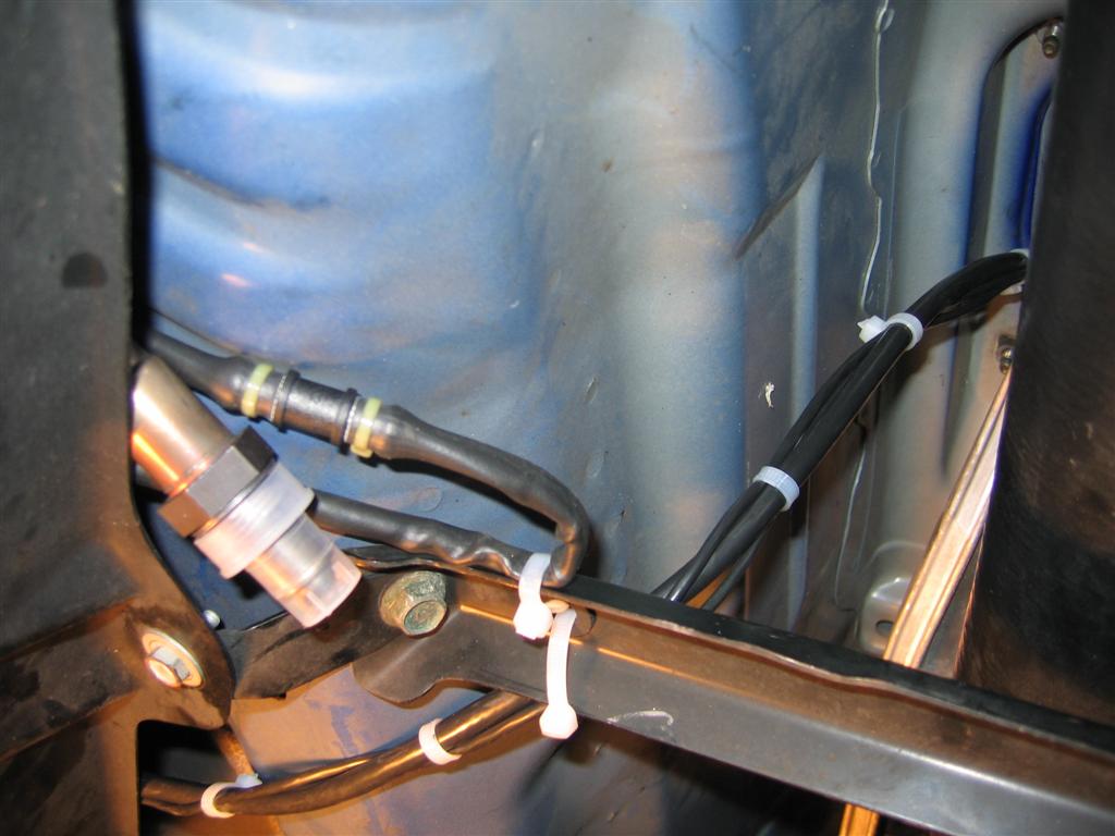

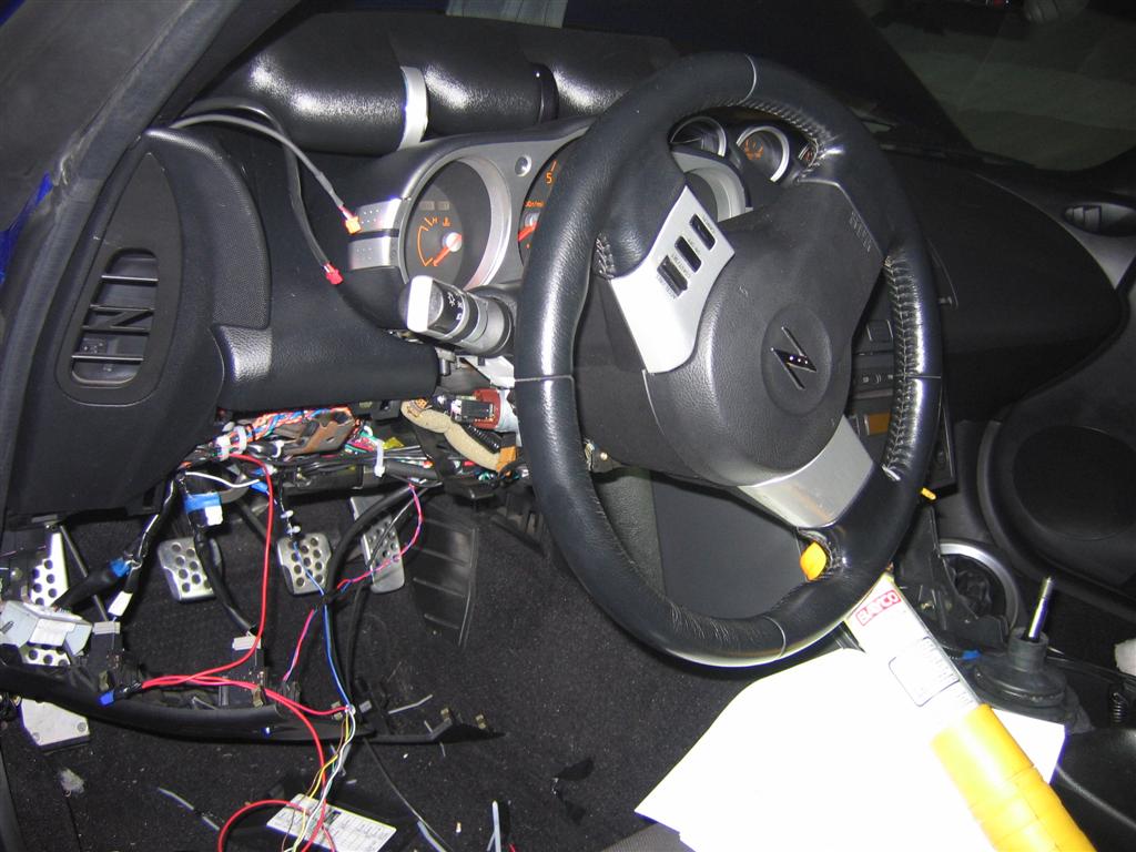

First pic are the Innovate wideband wires being run down the shifter assembly.
Second pic-under car shot of WB comign down through shifter assembly -dont worry its not close to the driveshaft.
Third pic-WB zip-tied with the clip/harness inside of the undertray away from wind, 02 sensor awaiting last downpipe.
Fourth pic-inside car shot witgh everything apart...

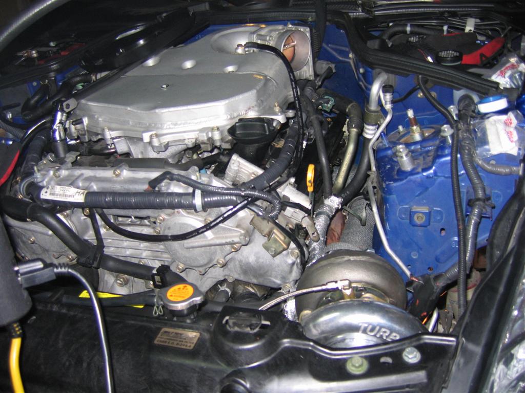

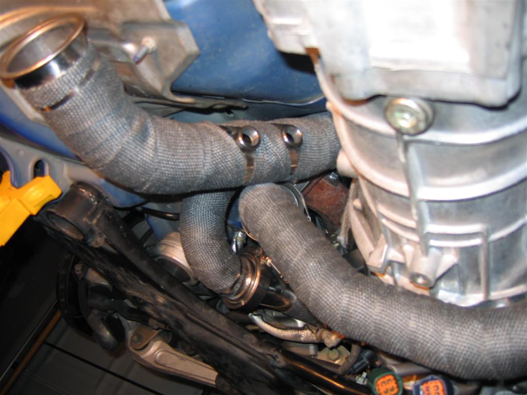

Heat wrapped piping and turbo sitting in car pics...
Attached Thumbnails Just started my Turbonetics Install !!-wrapped-large-.jpg   Just started my Turbonetics Install !!-wrapunder-large-.jpg   Just started my Turbonetics Install !!-uwrap-large-.jpg   Just started my Turbonetics Install !!-snailin-large-.jpg
+1 lol
you are almost on the homestretch. i like the way the innovate wiring was run. never thought of that. is the shifter sealed in someway so that water CAN"T make it's way into the vehicle? Good job! :thumbsup:

The shifter is just sealed with that metal ring and some rubber and sound deadning stuff, it will be fine My goal is to finish tomorrow before 4pm so me and my friends can get cleaned up and party hard to celebrate the install and this past year....
