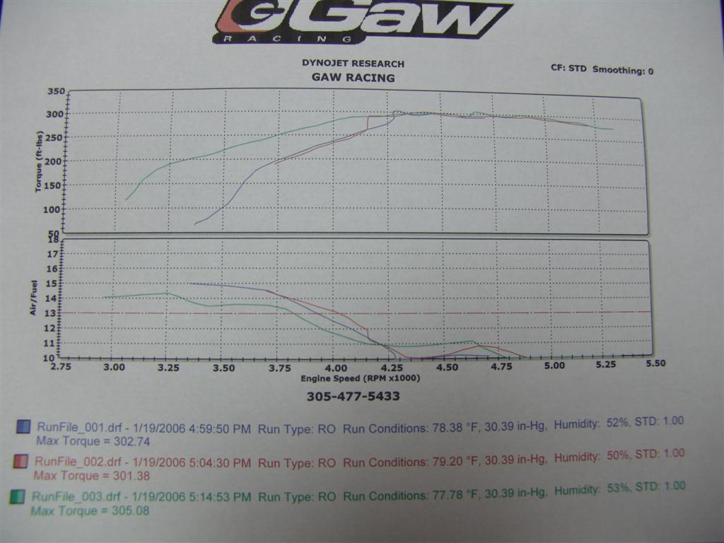

Ok here is the dyno: BTW this is using a STD correction which typically reads higher, do you have the SAE correction graph? A tune is in order for sure look how lean you are down low and rich your A/F's are up top, and why did you stop the dyno so early you didnt get near redline.

I sent you both the HP and torque. In one of them as you can see we took it all the way to the end but for some reason the dyno wasnt reading the rpm's correctly im going to dyno it again in feb. Ill send you again the HP. The car was dyno'd in 3rd which i think people have told me that i should have dyno'd it on the 4th.
No i dont have the SAE Check your e-mail i snt you the other one.
Thanks alberto for posting my dyno sheets.
