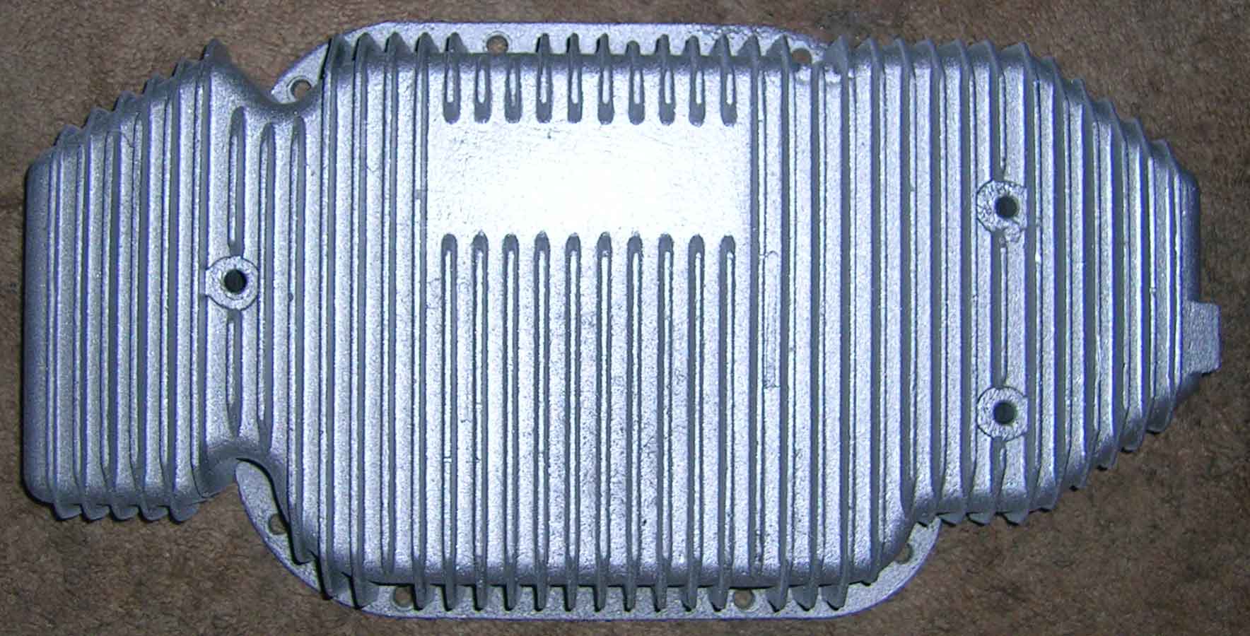

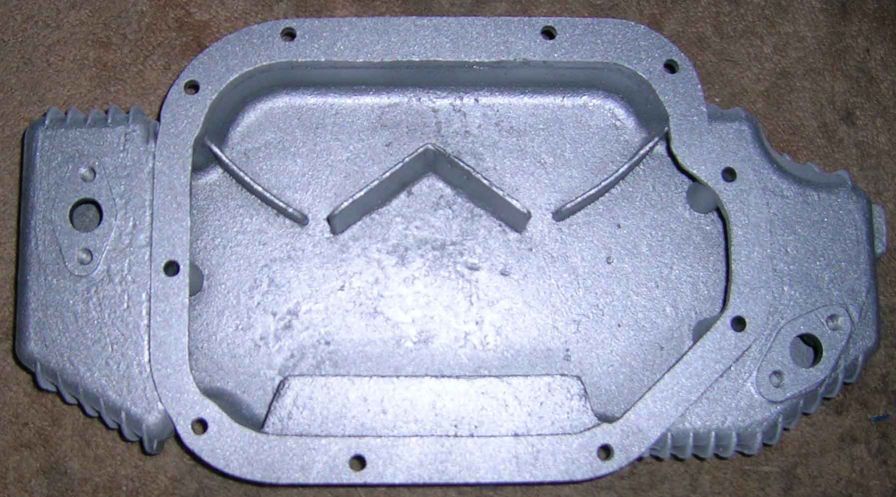

I ordered one and it came in earlier last week. its a cast replica of the PE oil pan. it holds and extra 1.5 qt. The 2 return ports for the oil are great. the block off's are 5/16" thick so you can tap it for feed lines. It fits the gasket there for will fit the car (sealing wise).
I bought it because I had originaly ordered the Greddy TT kit with the tap, but when the TT cam in it had a Greddy oil pan with threads already there so I sold it to a guy here on island for cost.
Just clean it out well, there is some fine grit powder still left from casting.

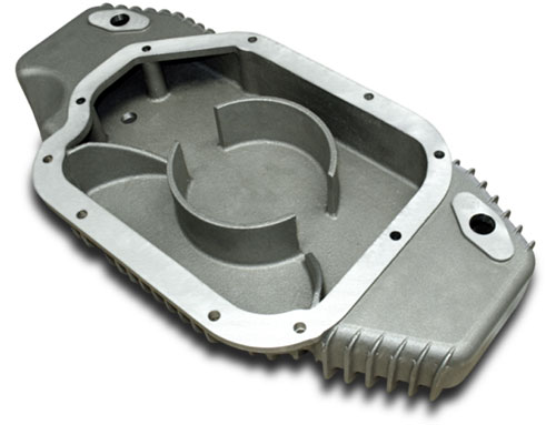

It looks like an APS oil pan on the outside, but my APS had more "walls" inside; "baffles" APS calls it.
and with additional baffles in the oil pan, oil surge under track/race conditions is reduced significantly
If you don't have an opil cooler, it will help cool the oil. My pan is huge and fins on the bottom have a huge surface

The casting quality looks really bad...or is it just the way the flash is hitting it? This would be interesting to combine with a spacer.

Yes that will work, but a sand casting knock off - they don't even try to plane the surfaces to level. I guess we are in the wrong business

The quality is ok.  The only place where you see some defects is the internal baffels. you can some defects is the internal baffels. you can see a few bubbles there but that doesnt matter much. It just keeps the oil from sloshing arround. All the heat sinks are good and the fit seams to me right. the connecting surfaces seemed to be plained down on this one. you could see realy fine sanding marks to make it level. realy fine sanding marks to make it level. Infact I put a level on it to see and horizantal/ fertical and both cross axis where level. so in my mind that was kosher.
For less than half the price one thats decent quality is great. The main stream ones are over priced any ways.

Thats real nice and all but where are the threads to secure the block off plate so you can tap in your oil returns?
