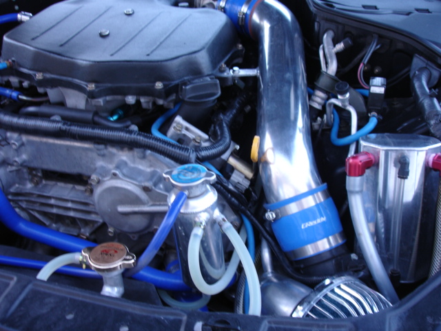

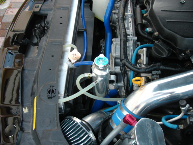

I have the PE and it works fine especially here in the FL heat. It's a direct fit and no cutting of fans or shroud is required. I had to switch a stock radiator cause it was losing water under pressure. A breather tank is a good idea also. It will purge any air bubbles you may have in the cooling system.

Was planning on getting a breather tank. How has the PE performed? Did you notice a big improvement in your temps?
