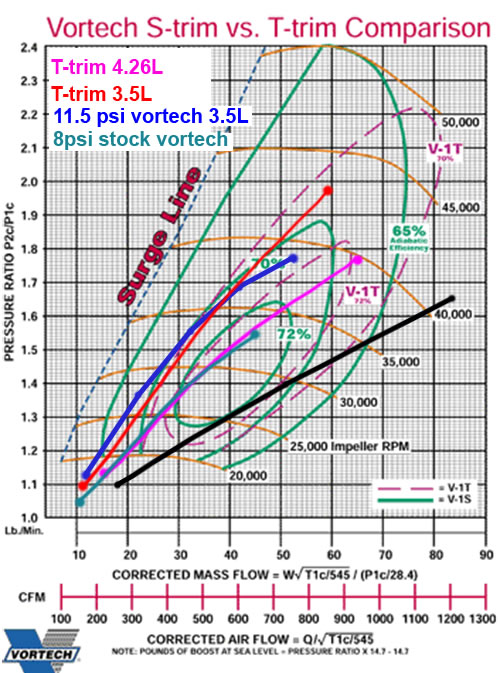

slightly off subject, but I was looking at vortech's compressor maps comparing the stock blower to the T-trim blower on a 3.5 liter vs 4.26 liter engine for the GTM stroker kit. I did all the math formula stuff and came up with these charts for different blower setups ranging from 2500-7000 rpms. Everything would vary a little though depending on how free flowing the exhaust/cams/cats/headers etc are
the stock blower is represented by the solid green curved ovals. You want the line to stay inside the smallest island as much as possible which has the higher efficiency % which means the blower will put out higher power and not work as hard to do it (heat up) The T-trim blower are the purple dashed ovals
The teal line is the stock vortech at 8 psi. It runs nicely inside the most efficient island of the blower on the graph.
My car running 11.5 psi graphed as the blue line and it skirts away from the inner efficient island and overall does make more airflow since it lands further to the right
I also mapped a T-trim blower which is the red line is the T-trim blower making around 14.5. It's on the outter skirts of the T-trim's efficiency range. It does flow overall a lot more than my setup and overall is pretty much the same efficiency treading near the 70% curves. This line might also represent what it'd look like if you could run something like a 2.4x inch pulley on the stock blower - which isn't all that horrible as far as the efficiency of the stock blower goes considering the extra airflow, but the challenge would be getting the belt to not slip. The line might possibly supposed to be slightly more curved than how I have it drawn, but you still get the idea
When I map the T-trim blower with a 4.26 liter engine as the pink line (making about 11.9psi on a 4.26L engine instead of 14.5psi due to the bigger displacement), things change for the better in a dramatic way. There's more overall airflow, about 9% more, and it's almost all in the most efficient island of the T-trim blower which means more hp on top of that 9% increase in flow. Basically, the 3.5 liter engine isn't big enough to really make the T-trim blower shine.
when I tried experimenting with a 4.26 stroker kit with the stock blower and 2.87 pulley which is the black line. It isn't very great. It goes way beyond the 65% range in the upper rpms where it's going to be pumping a lot of hotter air into the engine. The stock 3.33 pulley on the stock blower would be even worse (didn't graph it) You'd just never run something like that anyway, but it'd be somewhere below the black line near the outter green ring, and not going as far to the right
btw, if this was a turbo compressor map, usually a turbo graph looks like it shoots up high at the left then pretty much go straight across horizontally to the right and of course the ovals are different and the inner island is higher in efficiency, like around 75%
so to summerize as far as the efficiency of the blowers:
stock blower on 3.5L engine = good
overdriven stock blower on 3.5L engine = pretty good
T-trim on 3.5L engine = pretty good
stock blower on 4.26L engine = horrible
overdriven stock blower on 4.26L engine = not really ideal
T-trim on 4.26L engine = awesome
Attached Thumbnails my vortech tuner kit install process thread-compressor_maps.jpg

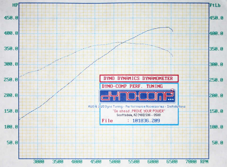

I got my car back finally after some last minute fixes/tweaks, and now that I've spent some time in the car thought I'd give my impressions
Some have seen my new dyno sheet in another thread from when the engine is running hot making a fairly consistent 420whp on the dyno.
As pointed out by booger, my belt appears to be slipping and I'm losing some boost starting at 5500 rpms and onward. The belt is a little loose feeling compared to normal so that's probably what's going on. Otherwise it'd seem that it should be in the 430-445whp range on my shop's dyno (DD)
It took me a bit to acclimate myself with the car again after not driving it for about 3 weeks. That damn ATS clutch takes a bit to get used to again after driving normal clutches in other cars, but after a bit, all was well again. The car really isn't an ideal street car you'd wanna drive everyday. It really is more set up as a track/drift/autox car. It sucks pretty hard dealing with how sensitive everything is during rush hour - which I had to deal with for 30 min today, but this car isn't my daily driver car anyway
I don't have traction in 1st or 2nd gear. I know people might think that's pretty cool and from a power perspective I guess it is, but it kinda irritates me not being able to floor the gas all the way and not have to worry about going sideways into a wall or another car. The handling things I have planned out should help a little with traction and I'll also use less negative camber in the rear. I might someday switch some things around and try to get some 315's on the rear - like the Nitto NT-01's or something. If worse comes to worse, I'll go back to the 3.5 final drive and get an ATS LSD to go with it. But considering I'm running 295 pirelli corsa competition tires in the rear, it's kinda made me rethink wanting more power if I can't end up using it in 1st or 2nd gear - we'll see. Thank god for my nismo LSD though. When the car broke traction, it'd get a little tail happy, but still not like it was before without the LSD
It does haul *** though. I did some WOT runs and it's noticeably faster than before. The throttle response is really agile and the car sounds pissed off angry at WOT - moreso with the AAM cats vs my old crawfords. The first time I went WOT with my wife in the car, she curled up into a ball in fear so I mean, I suppose it must feel pretty fast [IMG]images/smilies/tongue.gif[/IMG] She kept commenting so many times throughout the drive how pissed off the car sounds and that you hear most of the engine sound coming from behind the car. I very clearly remember how my car sounded when stock or with JWT intake that all the sound came from the front
While in 5th gear at 4k rpms, stabbing the throttle then letting off, then doing it again etc was instantly responsive. It feels NA in terms of being reactive and awake with the lightweight drivetrain and 3.9 FD reving up the engine quickly. It'll give you that "holy @#$@!!!" feeling. According to my boost chart, I'm making exactly 6 psi at 4000 rpms. You could feel the force of getting pushed back in your seat then feeling pushed forward almost as hard, then pushed back in your seat again. As long as I'm above 3500 rpms, 5th gear in general feels like 2nd gear in a bone stock Z in terms of acceleration G forces. If you're going WOT and instead of shifting fast you shift it kinda at a normal cruising speed, you really feel the car slow down a lot while shifting. It's like using the brakes almost. So obviously shifting fast while going WOT is going to be much smoother. It's like there's a rocket strapped to the back of the car and you're turning it on and off
The car is idling at 1300 rpms with the AC off and it is a freaking smooth and mean sounding idle. There's absolutely no bad vortech sounds. You hear the presence of the belt and blower turning and that's it. No rattles, no weird vibrations, nothing
That tanabe brace seems to help the handling from what I remember the car feeling like, but it could just be the placebo effect. I've already bumped it on all sorts of things - fairly lightly anyway. After driving a celica for 3 weeks, the Z feels heavy as hell, but still fairly nimble. Relocating the battery to the rear I'm sure helps, but it's not like you'll really notice it individually

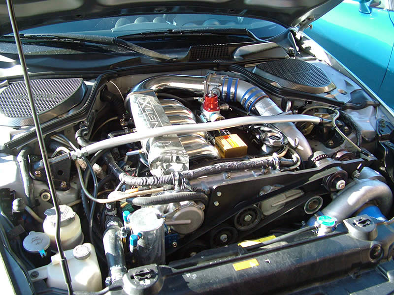

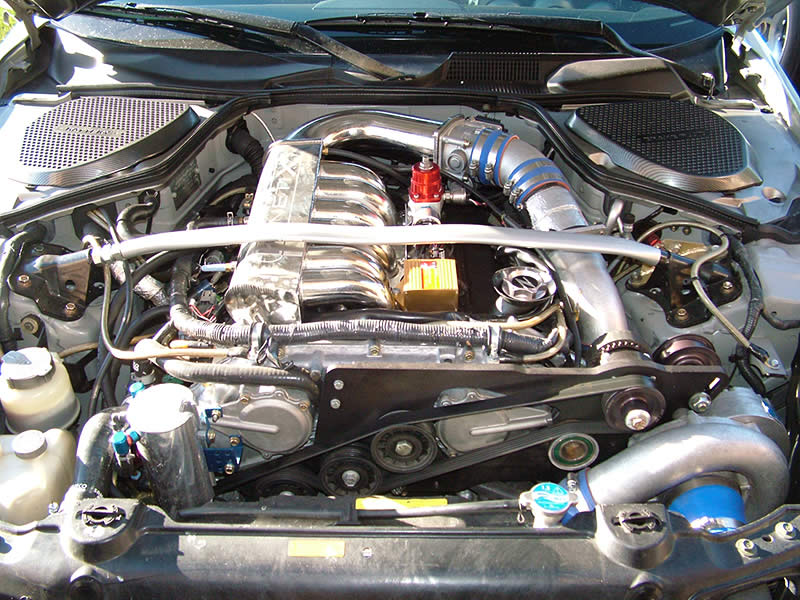

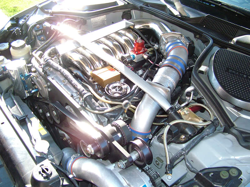

here's pics of the engine bay
Attached Thumbnails my vortech tuner kit install process thread-dscf7755.jpg   my vortech tuner kit install process thread-dscf7757.jpg   my vortech tuner kit install process thread-dscf7758.jpg

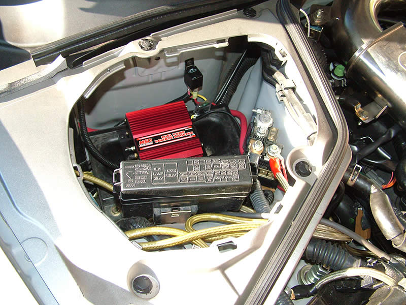

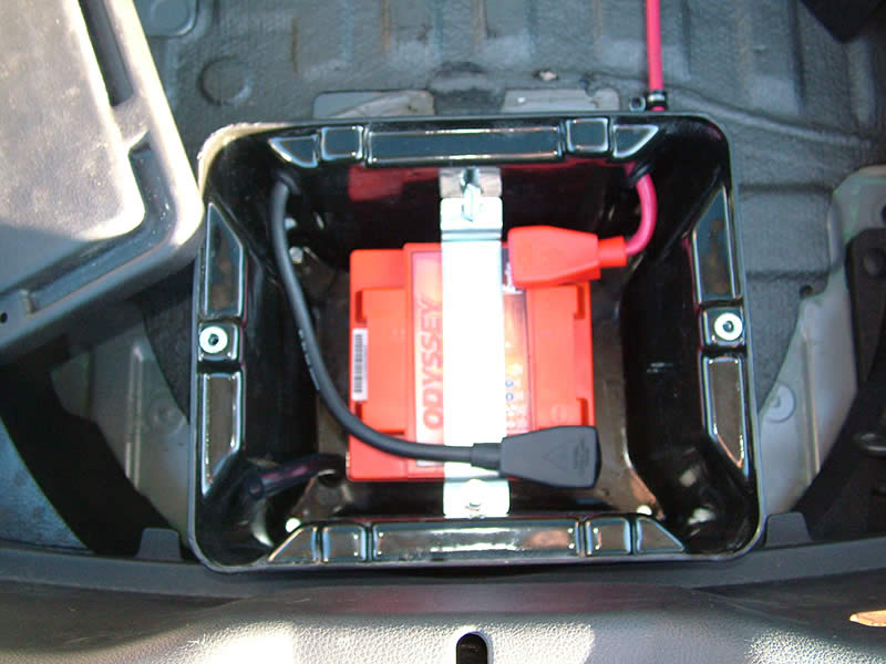

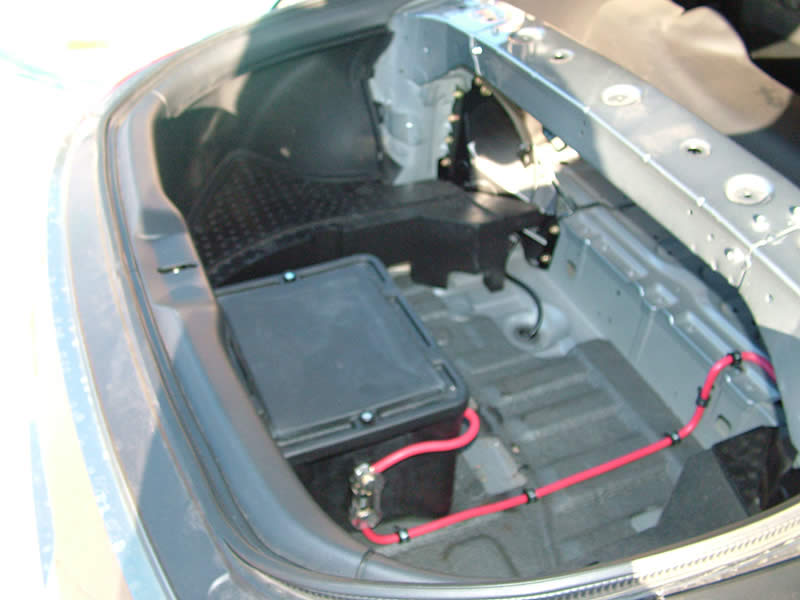

here's pics of the battery relcated, MSD booster pump, and the tanabe brace

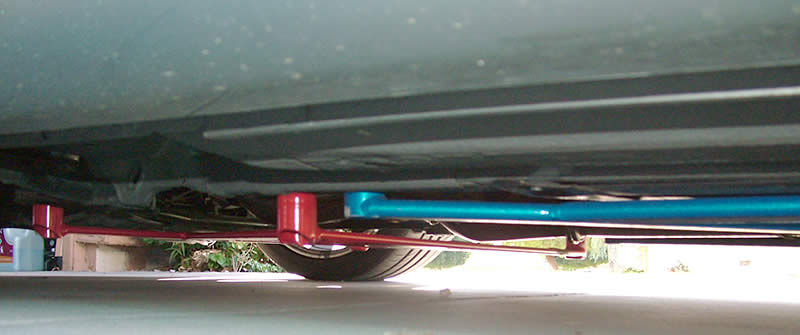

I'm just guessing it's -3.5 because it looks worse than when it was last adjusted which I think ended up being -2.5 or -3, I don't remember. I'm thinking maybe the bushing on my SPC rods has worn in and offset the camber a little. It's really noticably angled though
I'm not aware of any issues with my tanabe brace, but I never asked if there were any problems with it either. I have heard a few pops though the day I got my car back. Not sure what that was - maybe the brace was settling in or something? I might notice a little difference, but I'm not sure I'd say it's a huge difference if you already have the GT spec ladder brace. It's just hard to tell since I was 3 weeks away from my car

Sorry man, I recently read you post this in an old thread regarding the Tanabe brace, I remembered it wrong...
Originally Posted by Sentry
the GTspec ladder brace would not fit my aug 02 Z. Had to make some holes to make it fit
I know you havent gone to a Dynojet, what I was asking was did your shop add any extra corrections to your dyno to make it read like a Dynojet?
