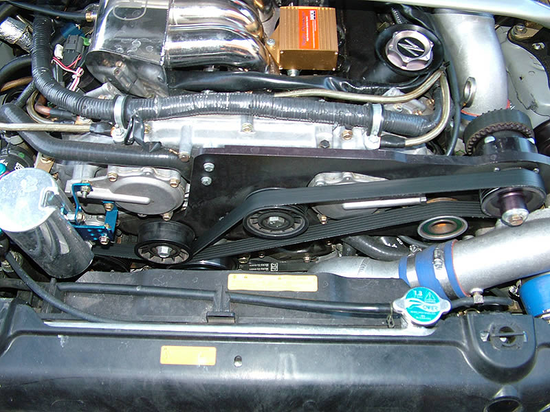

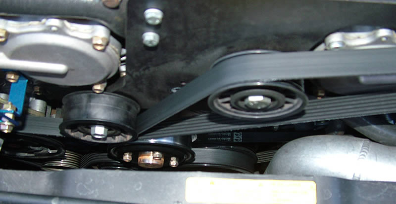

here's some more pictures I took the other day. Some people were wanting to see some better pictures of the belt setup and water injection nozzle, etc

Good stuff. Do you know if that pulley mod allows the belt to not have to be as tight to work properly? I fear that having the belt sooo tight is just gonaa end up killing parts fast.

Looking at the design of it, I've been thinking you don't have to crank the belt so tight to reach high boost. I mean, the normal design has the belt being tight around everything except the supercharger pulley which is probably where the least tension is.
From what I can tell, this belt design evens things out a little more so there isn't such a drastic difference in tension

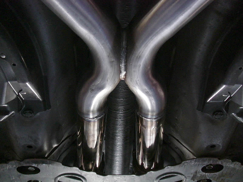

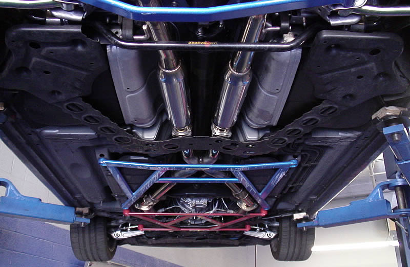

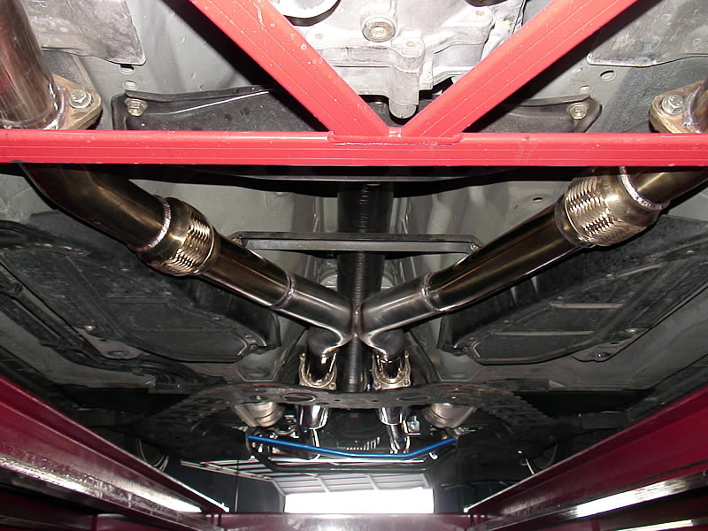

had an X-pipe welded into the APS exhaust - sounds better IMO than as a true dual. In a way it's slightly quieter with it, but it sounds more like a Z than it did with the pipes being seperate.
had my front brake pads changed from hawk HP+ to Axis Ultimates. There's less bite, but the squeeling is gone which I lived with for almost a year and was getting tired of hearing all the time - it's not like I'm always going to bed in my brakes every month either to reduce the squeeling.
I had the SPC toe bolts installed and got my rear camber to -1.6 degrees. Previously it was -3.5 as it turned out. I had to remove the small GTspec tie brace that connects to the toe bolts because the toe bolts are now more towards the center of the car. The GTspec bar can probably be modified to make it fit, but I honestly don't think that particular bar does a whole lot. I can't say I've noticed it being gone anyway. The other GTspec bars are the ones that really seem to make a difference

I assume that the x-pipe is just regular steel.

it's stainless, I didn't bother to polish it or anything
