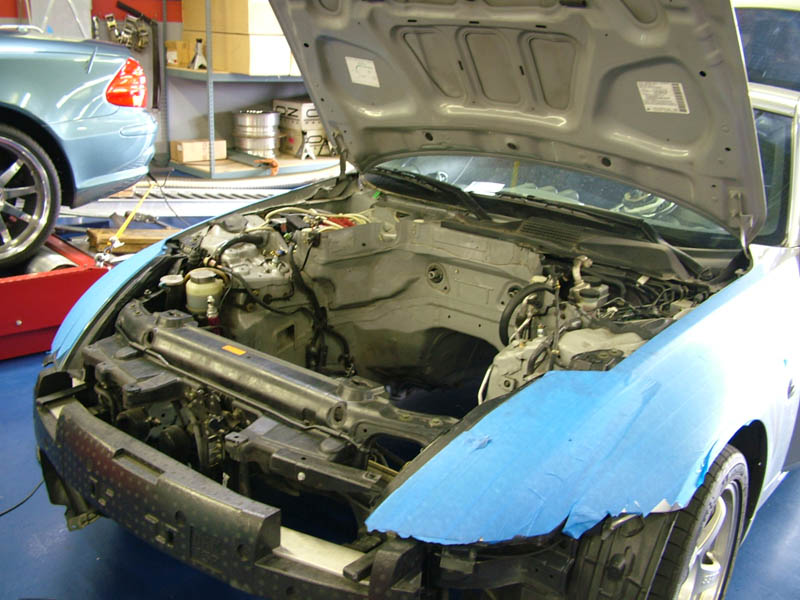

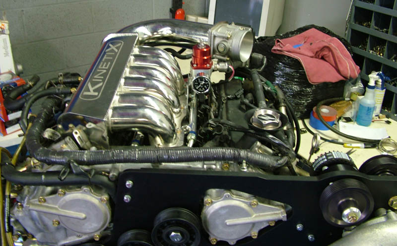

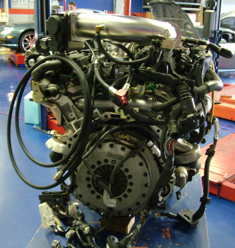

more pics...
Stopped by there today to pick up my old parts I'm selling (tilton street clutch, UR crank pulley, koyo radiator, rogue shifter etc) and to drop off a thermo gasket for the intake manifold.
He didn't spend a lot of time on the car last friday because he was finishing up that elise, but did get a few things done prepping the car and engine. He got the fuel gauge for the fuel system mounted on and also got some of the vortech parts mounted on. He just placed the blower on the engine for now to help get the other parts in place. It'll be removed when the engine actually goes back in then put back on later.
he has high expectations for the car and said it should really perform pretty well. That was about it. It's all up to me getting the motor mounts cause after today that's going to be what holds things up cause he can now dovote all his time to my car again. Hopefully I get them in a day or two so they can finish the car by friday - probably won't happen though knowing how these things go
Attached Thumbnails my vortech tuner kit install process thread-dscf5978.jpg   my vortech tuner kit install process thread-dscf5979.jpg   my vortech tuner kit install process thread-dscf5982.jpg   my vortech tuner kit install process thread-dscf5985.jpg   my vortech tuner kit install process thread-dscf5993.jpg

awsome pics meng.. that blue tape for the track (painters tape) got Fing expensive!!

Sentry
Ive noticed some thing out of place , you might want him to correct . The bolt on the tentioner pulley for the cog belt . The head of the bolt should be on the pulley side and nut be on the bracket side .
Looks great though....good luck !!!!!!

thanks booger, I'll call him now and tell him that

good catch booger! i turned mine around last month after seeing the thread on here! It would be interesting to know how many of the Vortech S/C have those tension pulley bolts on backwards? Including mine i think that is at least 3 on this board!

called him up and he said he knows what I mean cause I actually printed off a sheet of FAQ vortech install issues and that was one of them - the one from the recent thread showing the right and wrong way etc.
he said the vortech isn't really bolted on the engine yet, just sitting there kinda lightly fastened down on it so he can see how it all goes together better.
thanks though. I have higher res version of the pictures that I could post if someone needs to see a specific detail - just trying to save download time by downsizing them.

Not really that big of a deal , but it will...sooner or later ...wear out or damage the bearings in the pulley

your engine still looks brand new

Originally Posted by booger
Sentry
we know, this pic is just a mock up. you have a sharp eye.
