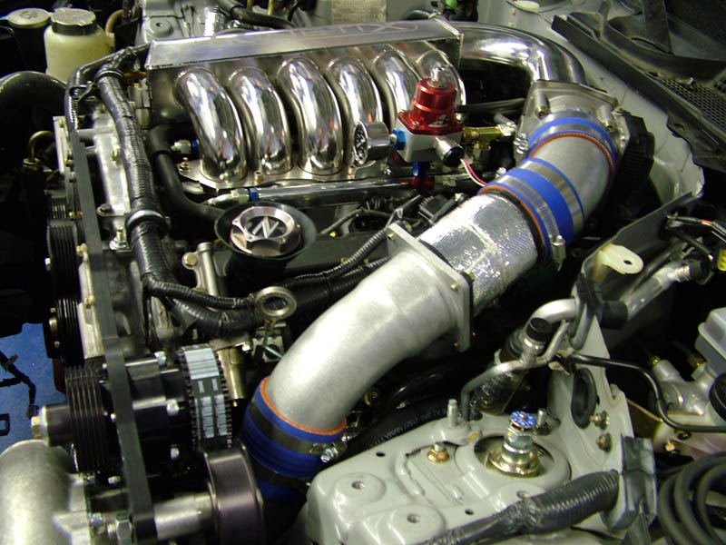

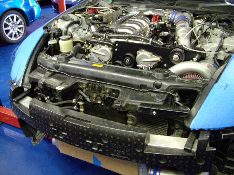

update:
stuff's moving along. There's just lots of little things happening with being installed along with the actual vortech install at this point. He says he thinks he has about 5 more hours of work he's guessing. Then if they can tune my car today they will. They have a prior engagement with tuning another car at the end of the day so tuning might not happen until tomorrow morning, but it's getting there.
I dropped off my Gates accessory belt so he can start getting the belts tightened up and finish up the radiator fans etc.
He noted some things/flaws about the vortech kit that might be interesting for people to know. The intercooler isn't really held on very well. It's mostly held on by the intercooler piping. He says it's ok and it'll hold, but it's just not the most secure way of doing it. He says they obviously could have made a bracket the bolts up and he'd actually have no problem doing it, but because he doesn't know how deep he can drill into the intercooler he doesn't want to risk drilling thru it and getting metal shavings in it etc. So anyway, he's going to come up with something to secure it better. He showed me some brackets that come with the kit to hold the intercooler up while installing the piping, but they're not permanent brackets.
Another thing was the AC line that vortech instructs you to bend to avoid touching the blower or piping or whatever. After you bend it, it's practically touching the frame - or maybe it is even. He was thinking that's pretty lame cause it'll gradually rub a hole, but even vortech's instructions say that's how the kit does it. So I think he did something to help that - maybe some wrapping or something. Either way he's been saying the kit seems ok and maybe he's just spoiled to things fitting perfectly for an OEM sorta fit quality, but he's not really impressed with the fit quality of the kit with how much extra work he's had to put in to make everything work better.
Also the intake - as we all know, isn't in the best spot and the air filter is all flat where the air hits - a JWT style filter with an air filter on the top would have obviously been way better. Anyway he'd like to fab up a pipe to bring the intake down to being a cold air intake. That won't happen this round, but next time I'm in I'll have him do that along with an oil cooler. It's not too hot here in AZ yet, but June is just 2 months away.
I've been really impressed with John's and Dynocomp's work. I wish it was moving a little faster, but the reason I went here was I knew they'd do a great job on the install and not skimp anywhere. I'm sure I could pay another shop to do it and it might be cheaper, but part of what I'm paying extra for is a quality installer who's worked on the Z a lot with FI and who'll catch things and do things that a normal mechanic might not do and just do what the instructions say and call it a day.

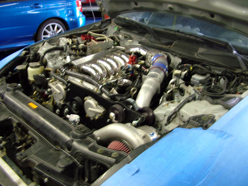

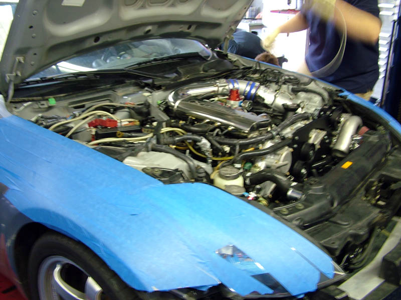

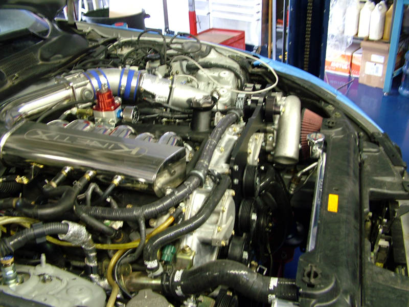

update:
well John is still going at it and had a couple minor setbacks. The GTspec ladder brace didn't have any holes for him to bolt it onto because my car is a very very early model (aug 02 build date) I've heard the later Z's have the holes or whatever in place for the brace. So anyway, he had to drill the holes to fit the bar. He took a picture underneeth the car to show what he did.
He was topping off fluids right when I talked to him. In total, he had to do radiator fluid, power steering fluid, engine oil, and I wanted him to change my rear diff fluid.
He's gotta make a bracket to put my cusco oil catch can in somewhere. Sounded like he was going to mount it kinda in the bumper somewhere.
He noted that one area of the big engine belt runs really close to a certain bolt. He wants to keep an eye on that, but is figuring it probably won't be an issue otherwise vortech would have replaced the bolt with something else or something like that.
It's 3:00 right now and he thinks he'll get done by the end of the day around 5:00 or so. But because that other car is scheduled for tuning around that time, it'll end up getting tuned tomorrow afternoon.
He's going to replace the crank angle sensor wire with one of the ones that Charles (phunk) at CJ Motorsports sells after he starts the car up and makes sure the car turns on etc. John is still concerned about how much vibration will transmit into the car with the solid motor mounts. There's not much for going back now though.
Like I said, there's just lots of little things he's finishing up at this point. He's also gotta get the front bumper cover back on, the ECU and interior body panels put back on, shifter boot and **** etc etc
He'll call me at the end of the day to let me know where he's at and to give me feedback on the vibration from the mounts if he gets the car started up.
