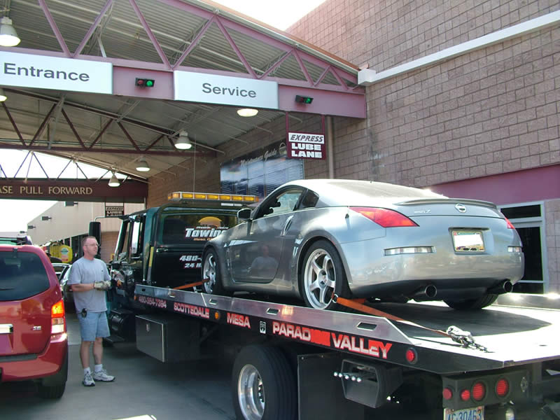

ok got the car, got it towed to nissan. The good tech we talked with was working today - kinda partly because of us. Anyway we get there, hook the consult II up to it, and there were several back and forth things that happened - detecting this and that but not this, then detecting it, but not something else. We ended up hooking the 2 different ECU's up to my car and each one had its own set of issues. I think both the ECU's are actually registered with my car and keys now...

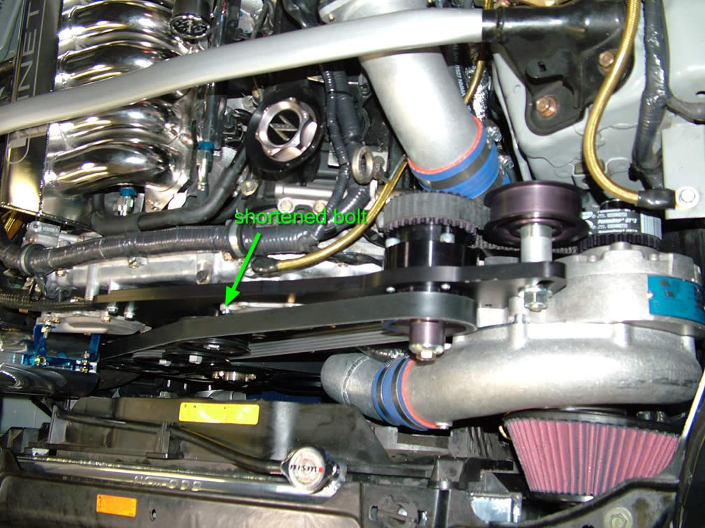

Jon also used a different bolt in the motor by where the belt was almost rubbing it. So being a good precaution, there shouldn't be any chance of it rubbing the belt now

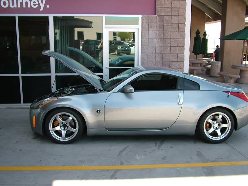

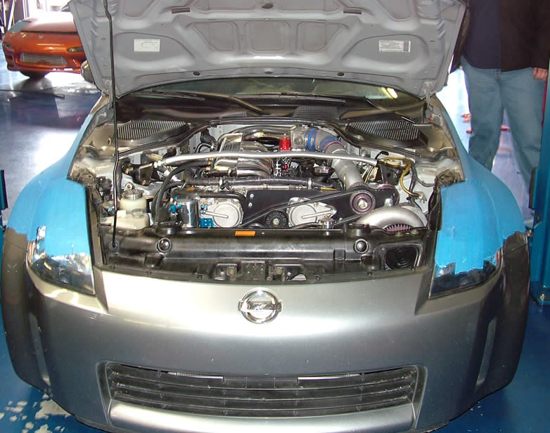

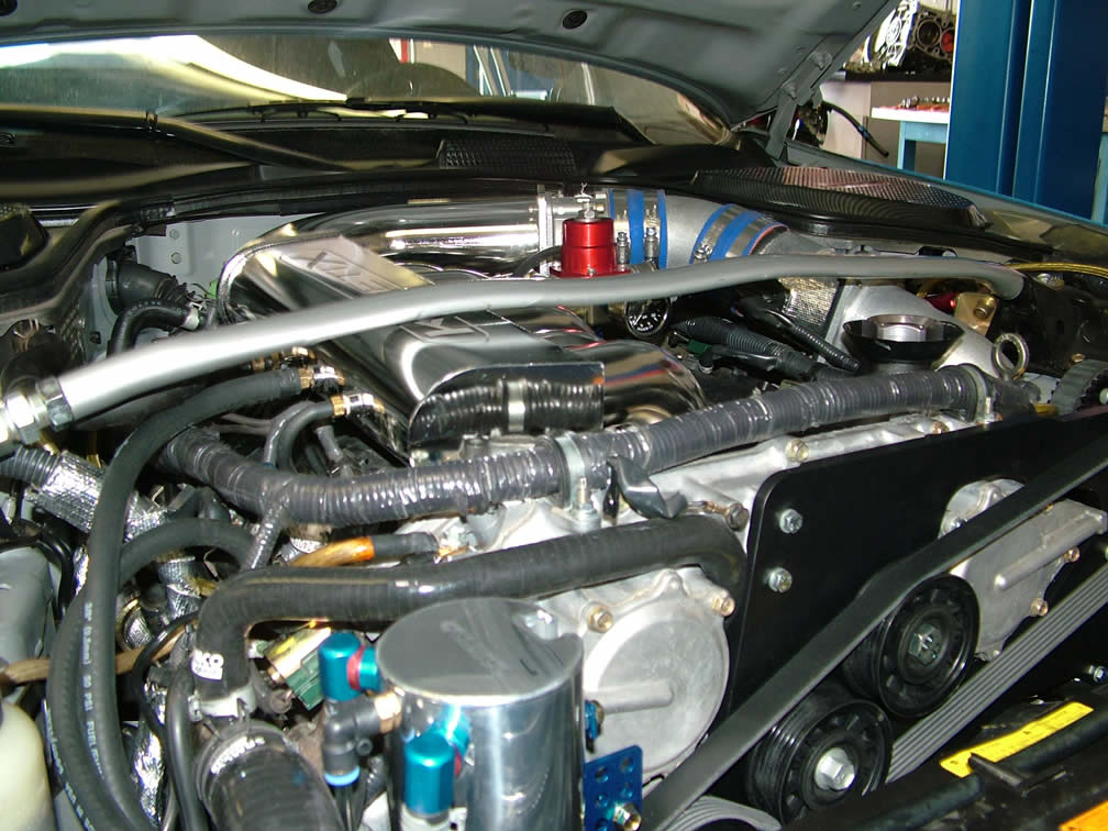

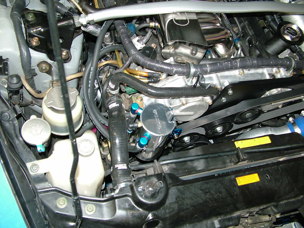

so here's some pictures of my day
